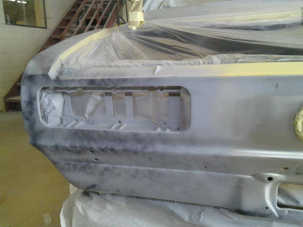

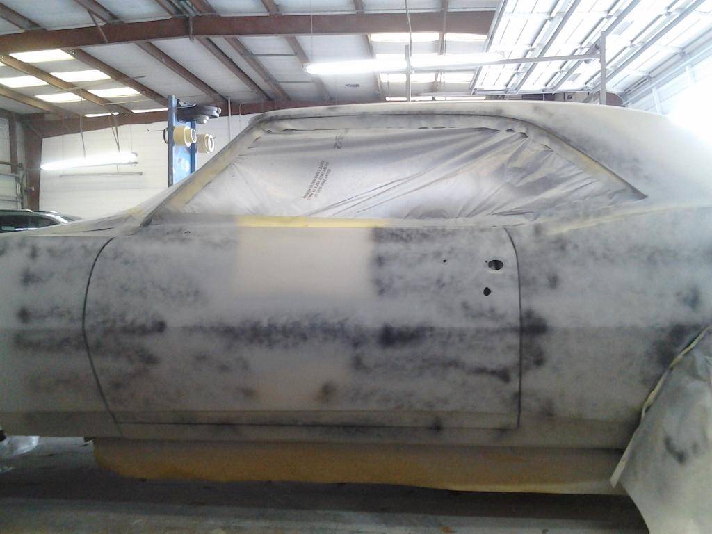

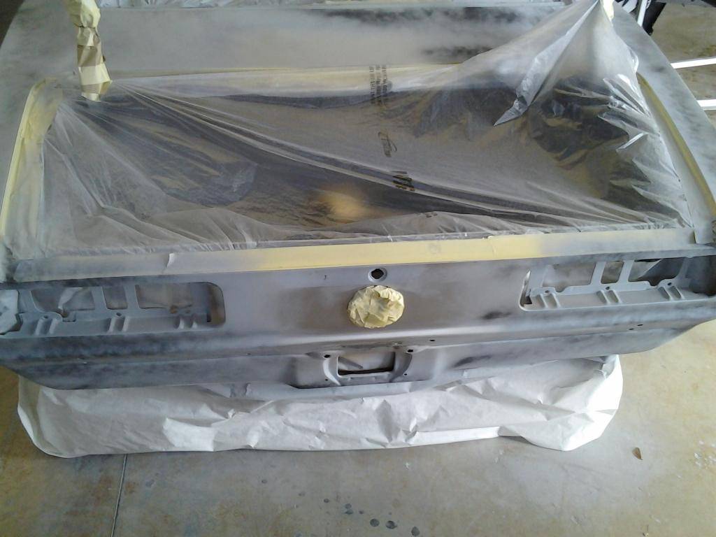

      Progress!!! Next is a full prime.

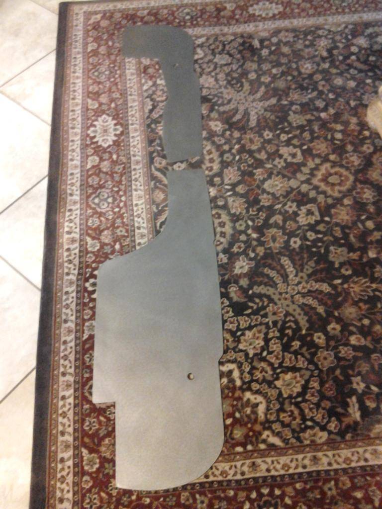

      The firewall plate is from Mikes Custom Cars and will be welded in next, along with new through the floor BMR subframe connectors.

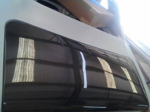

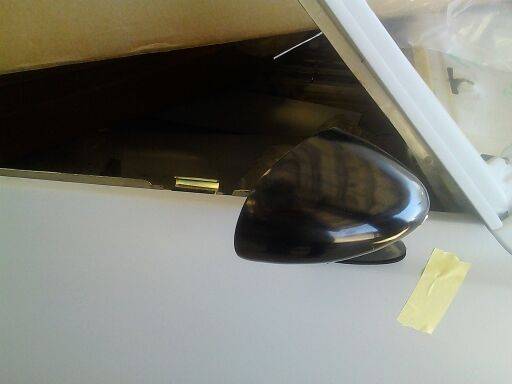

      Fitting new mirrors.
      Name:  Good angle lower valance.jpg
      Fitting Anvil Auto carbon fiber header panel, hood, lower valance
      Trunk lid fits well.

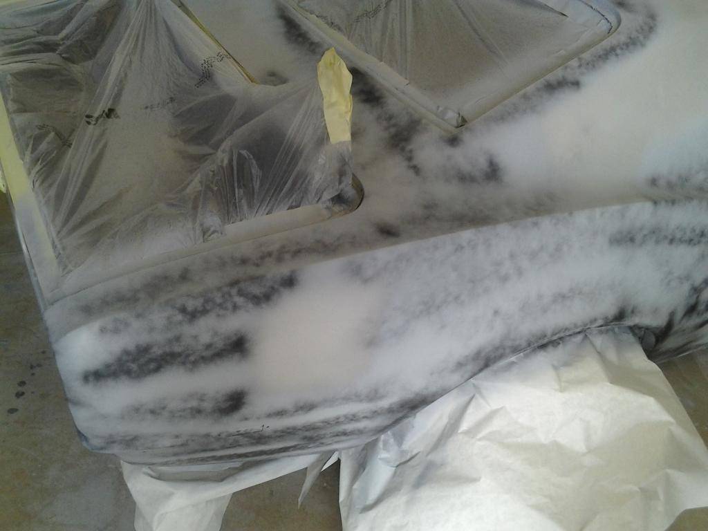

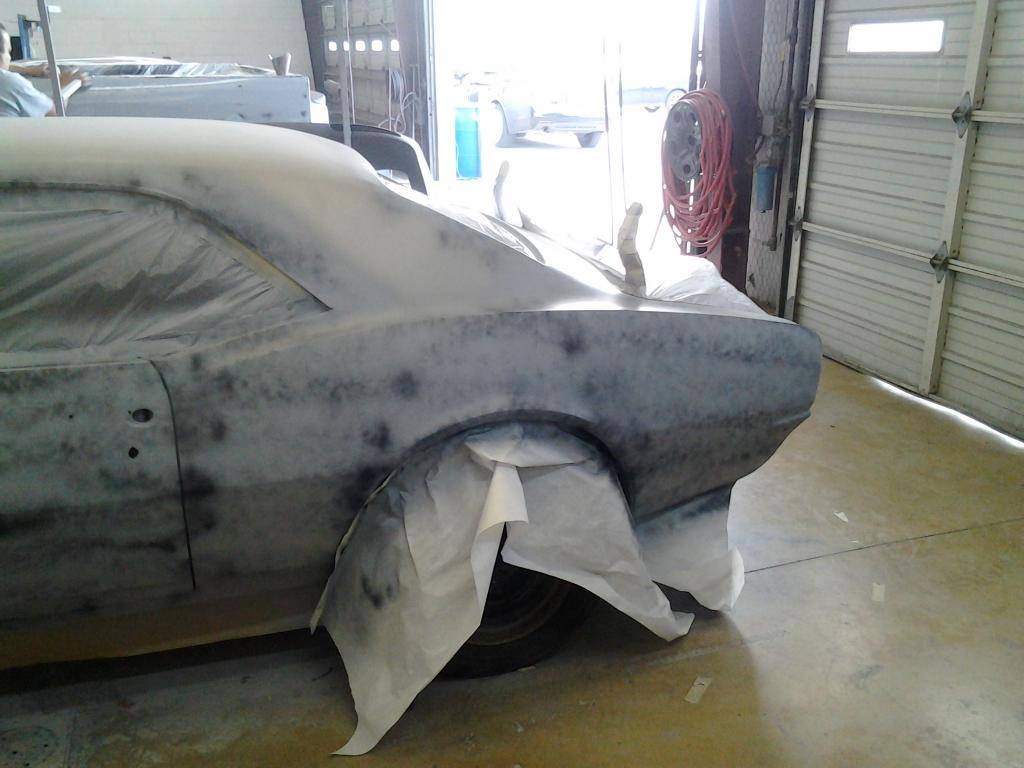

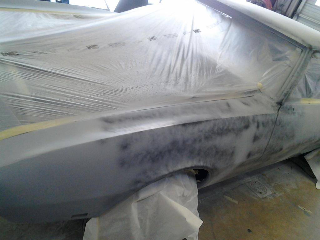

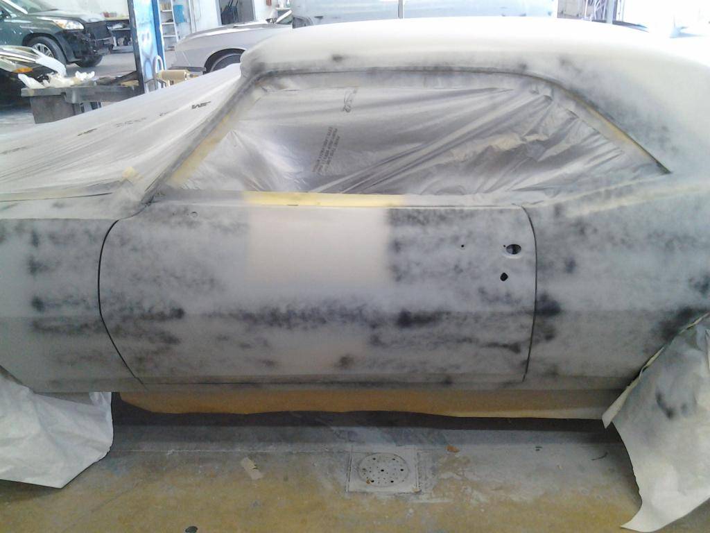

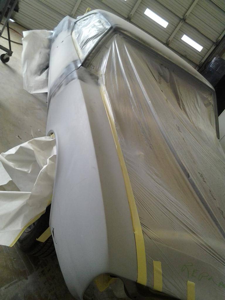

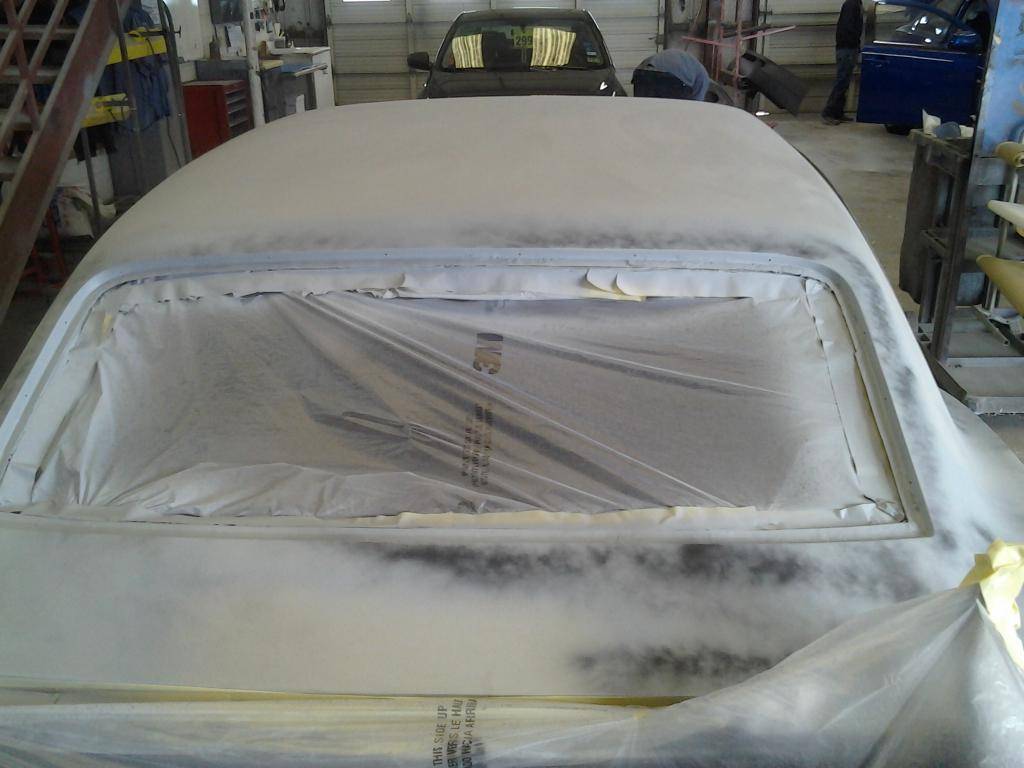

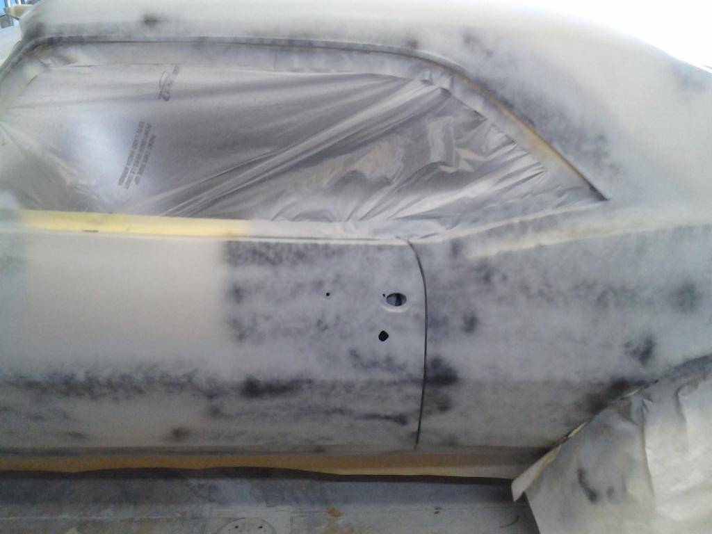

      More pics...getting closer to paint.
      New subframe. I am having a Screamin Performance tow\ jacking plate welded on. Welds are within the outline of the plate.
      Priming frame side of plate with weld thru primer before installing to prevent corrosion.
      Grinding the welds smooth. This plate will look factory when done. It will add hidden tow hooks to get the car into the trailer without damage.
      Priming the frame and painting with John Deer Blitz Black. Using an airless sprayer to apply paint.
      Smoothing lower tail panel. Spent several hours grinding and smoothing bottom edges, as well as whole underbody.
      More detail
      Drivers wheel wheel being smoothed.
      Door to quarter alignment passenger. Rebuilt door hinges to achieve this.
      Door to quarter alignment driver.
      Smoothing wheel well passenger
