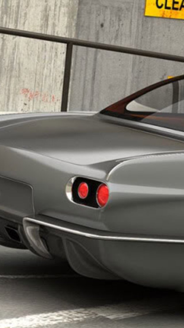

      The light turned out terrific! I couldn't be more pleased with the results. It is almost identical to the VOX rendering except the inside light is slightly smaller on the rendering.

      I think your 'equal' sized tail lights look much better than the rendering! They remind me of a Ferrari. ...or a Lotus. lol

      Here is a picture of the rendering.

      Looks better than the rendering!

      Agreed!
