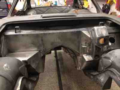

      Then I ran across some threads from Iamtheonlyreal1 and I was intrigued. Long story short I decided to pick up a good "core" to start with. My 68 had not been driven since the early 90's. The engine would not turn over because of electrical issues. I am in the process of stripping the car. The interior is out with the exception of the dash. The engine, transmission and suspension has been removed from the car. I borrowed a rotisserie from a friend which should make the removal of the undercoating much easier.

      Where am I at now? As I mention the car is pretty close to being stripped. I need to decide if I want to blast it or dip the car. I know both hasve advantages and disadvantages but I am leaning more toward dipping so that I can be sure all rust is gone.
