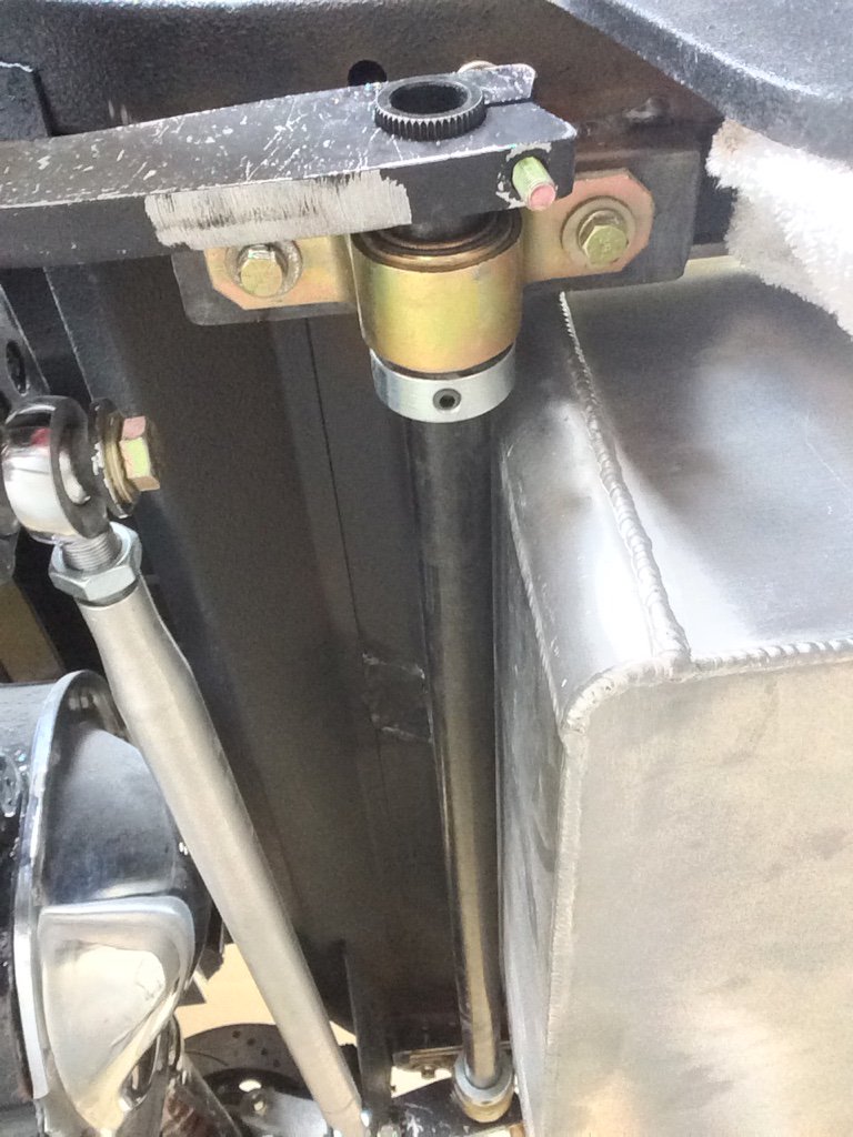

      Sorry for the late reply and update. I have been reworking some of the rear suspension. We took some of the bulk out of the crossmember and boxed them even more for additional strength.
      I also added a rear sway bar. The bar mounts are pretty simple. I used 2.5" angle iron and welded nuts on the back side. I boxed them in on the ends to create additional rigidity. I then had my bodyshop weld them in place. I wish I had at home for that part but it was a pretty simple job.
      The bar is 37.5" long and is.188" wall hollow tube. I will likely pick up a .250" wall swaybar to swap out for track or autocross events.
