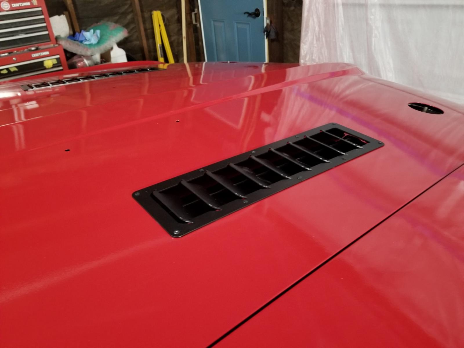

      Quote Originally Posted by Zachalanche View Post
      Close up of the hood vent. I was really on the fence about adding these, but I think they ended up looking pretty good.
      Attachment 179656
      I think the hood vents were a great addition. They add detail...

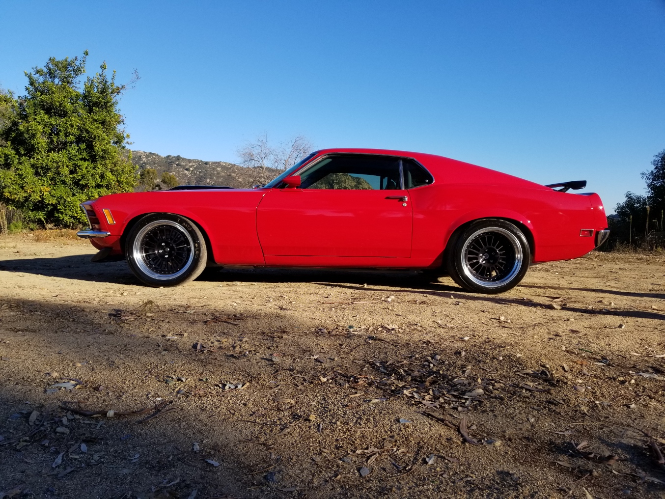

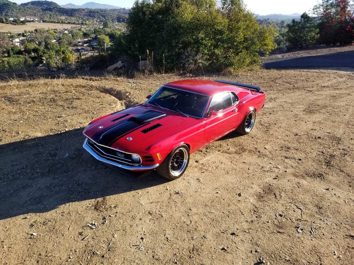

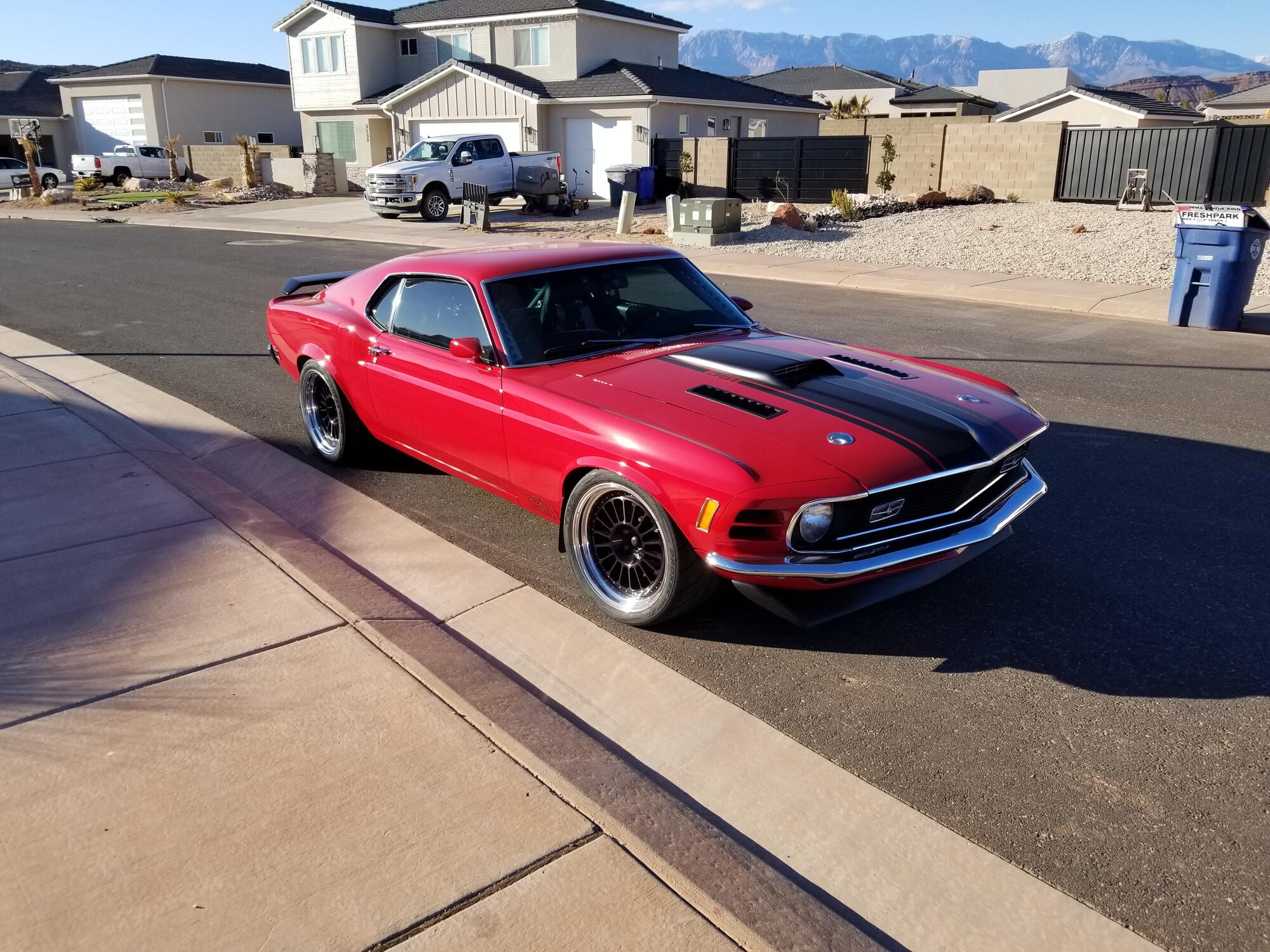

      I won't say the car is complete, but the rest of the things I have left to do won't be changing the overall appearance. I'm pretty happy with the color, it is red hot in the sun for sure.
      Zach

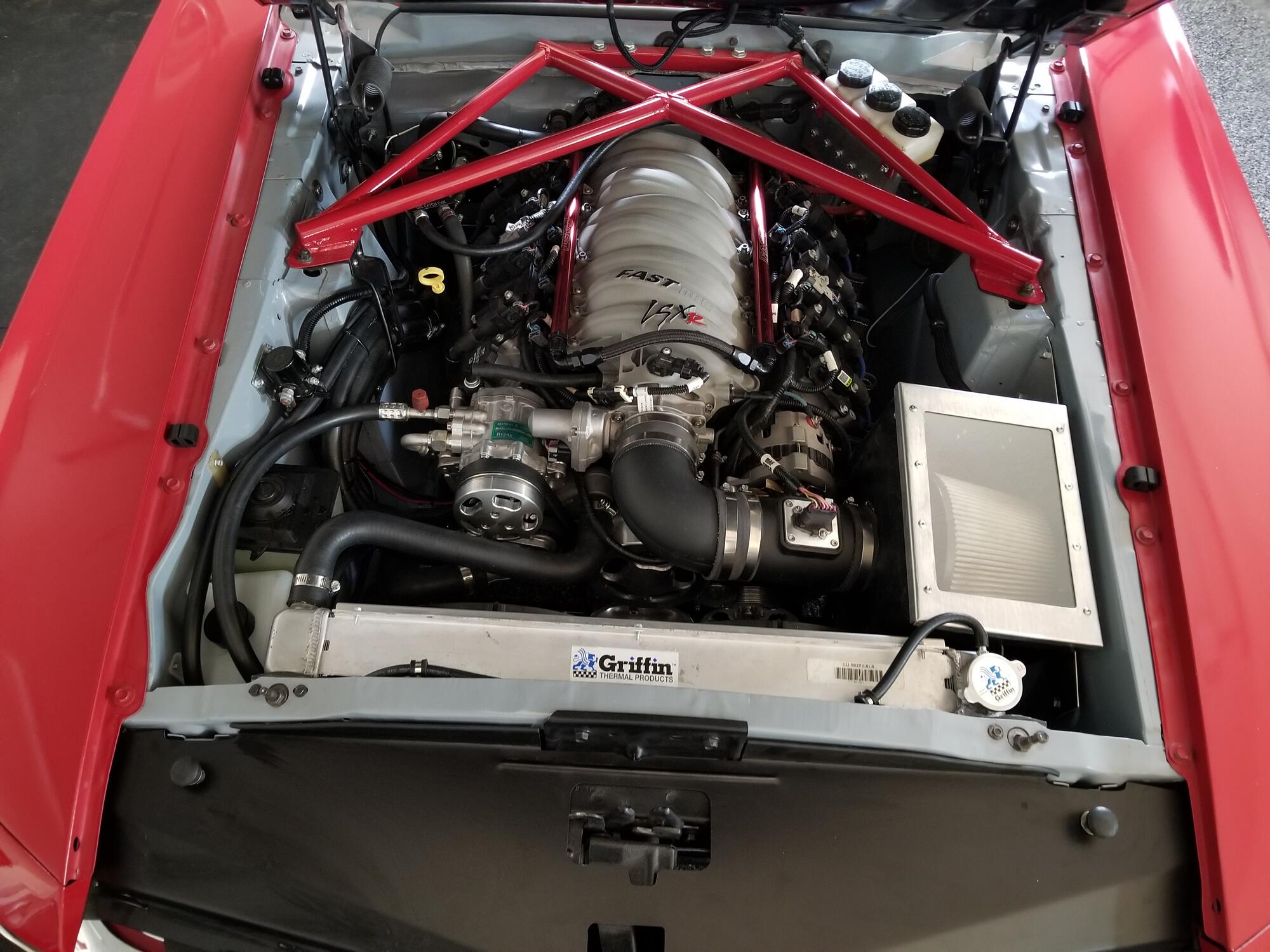

      It's been a while since I have shown any updates on this. here's a couple recent pictures of the car.
      I finally built a proper airbox. The plan is to eventually duct this airbox up to the hood scoop and obviously cut a hole in the hood making the scoop functional. I will need to fabricate some kind of plenum that sits under the hood scoop attached via the hood scoop bolts, then I will run flexible duct to the airbox. But for now, it's just pulling air from around the side of the radiator. the airbox could use some heat wrap. My engine compartment gets hot with this modern engine and its hot thermostat.
      there's been a bunch of other random things I have been sorting out on the car, but I have been pretty busy the last couple of years and its hard to find time to even drive the car lately.
      Zach

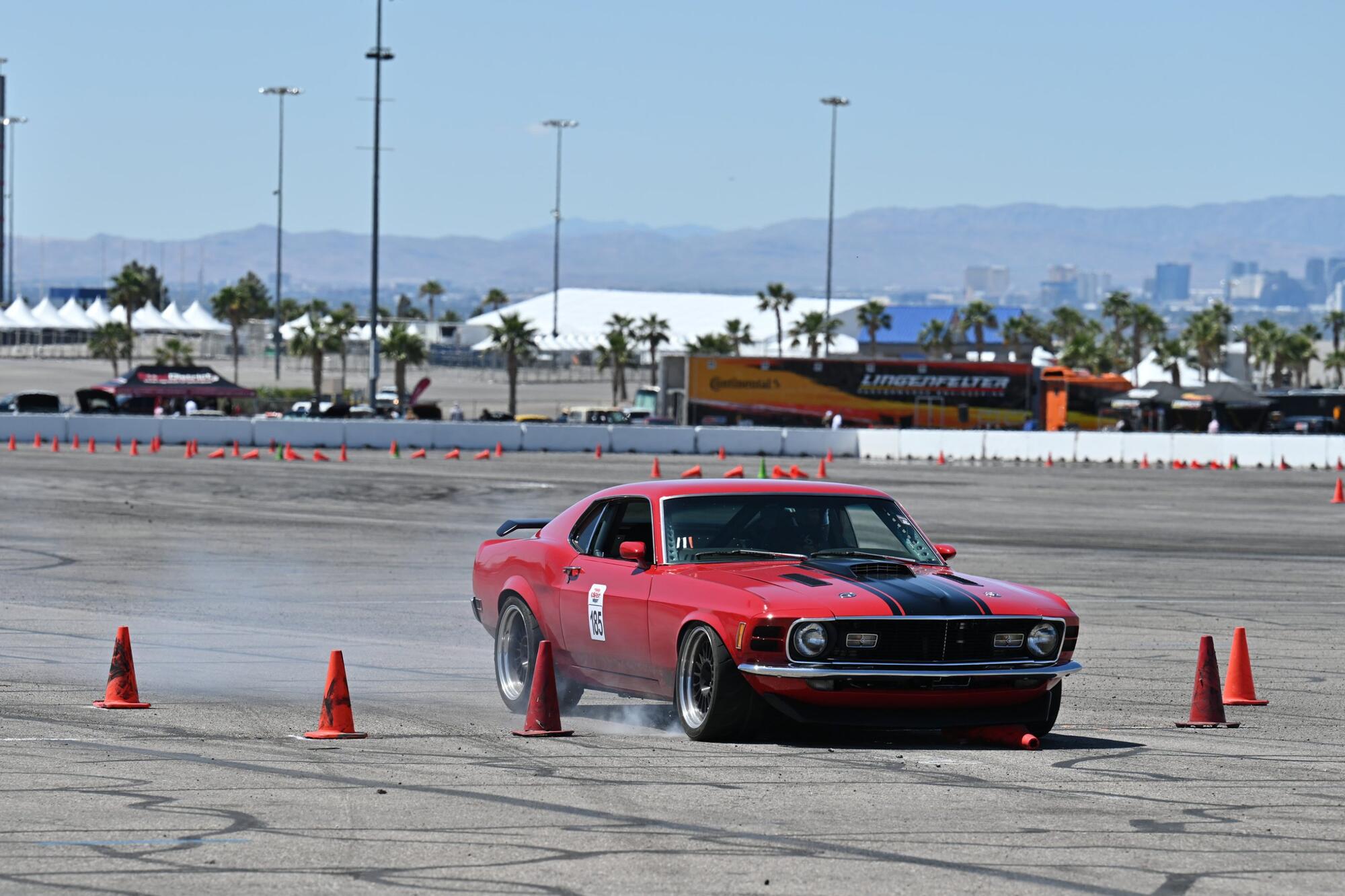

      After years of minimal use and being busy with life in general, I finally had an opportunity to enjoy the fruits of my labor at LS Fest West last weekend. The car performed great.....much better than its driver did. What a great time. I need to attend more events.
      Name:  Mach 1 Grand Champion.jpg
      Name:  Screenshot_20240427-213504_Video Player.jpg
      Zach

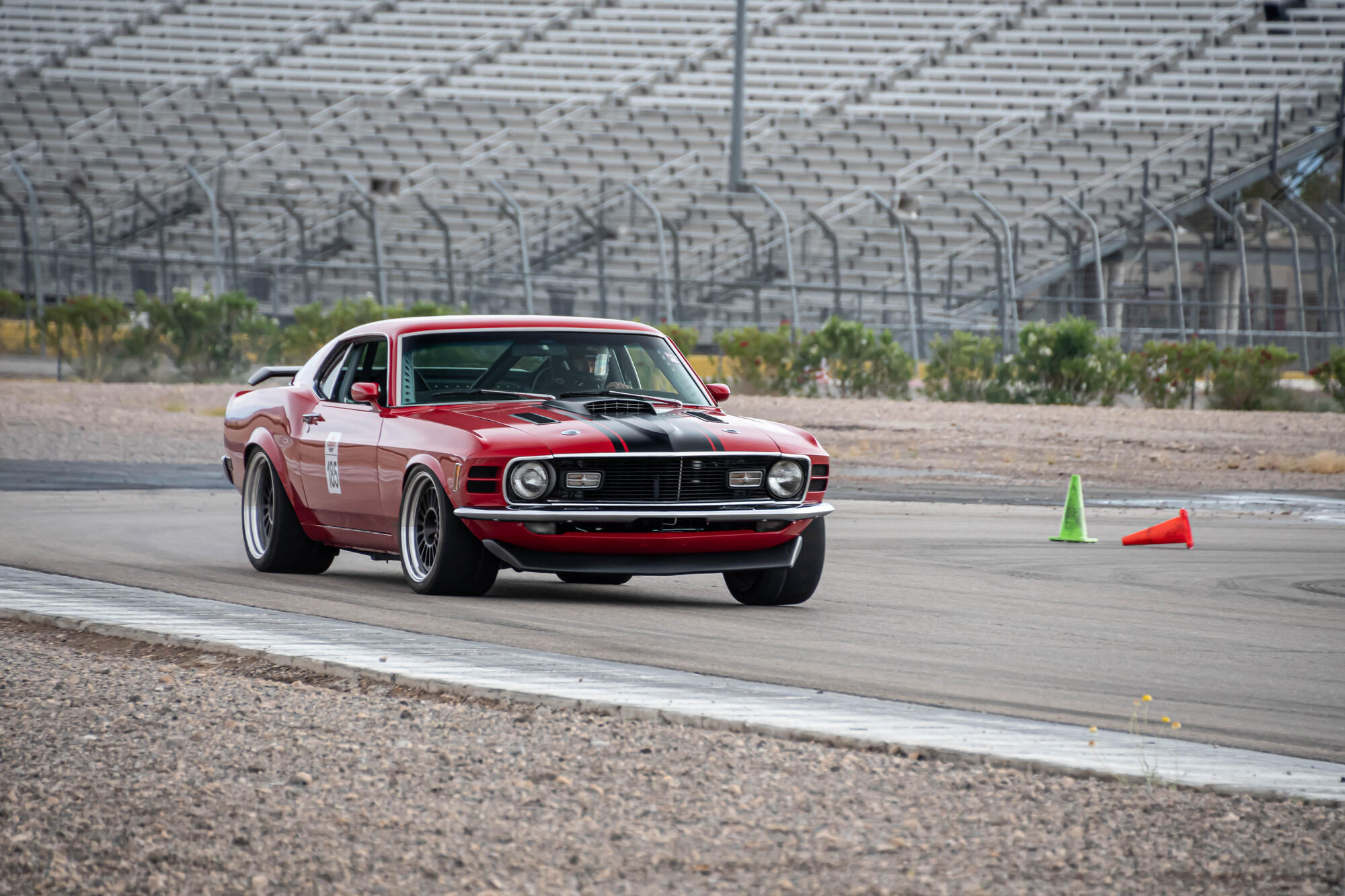

      A few more pics taken by Terry Lysak @tlysak
Size:  353.6 KBName:  DSC_6051.jpg
Size:  324.6 KBName:  DSC_6053.jpg
      and a couple from theautobuilder.com
Size:  260.4 KBName:  SK2_2791-scaled.jpg
      Zach

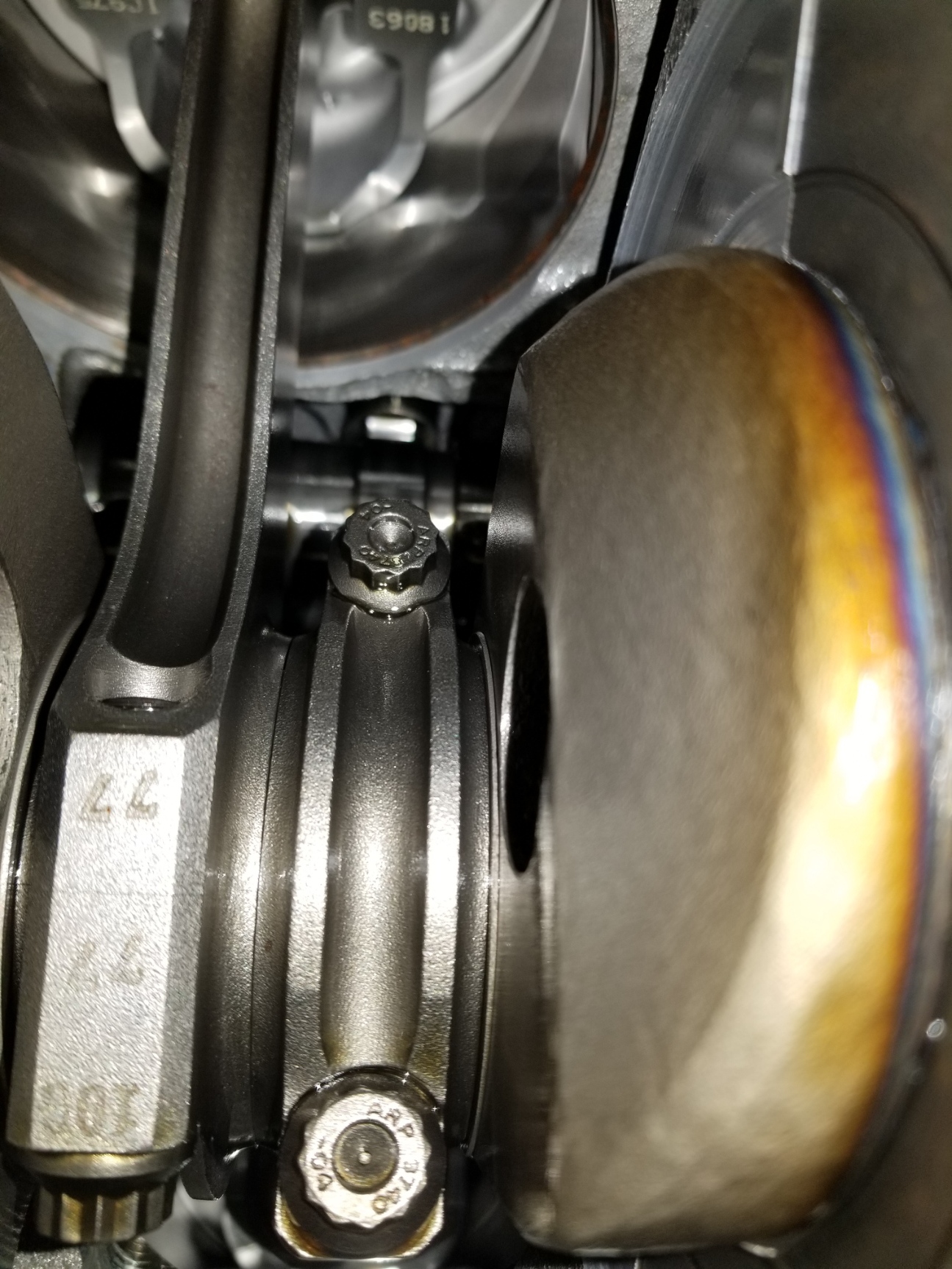

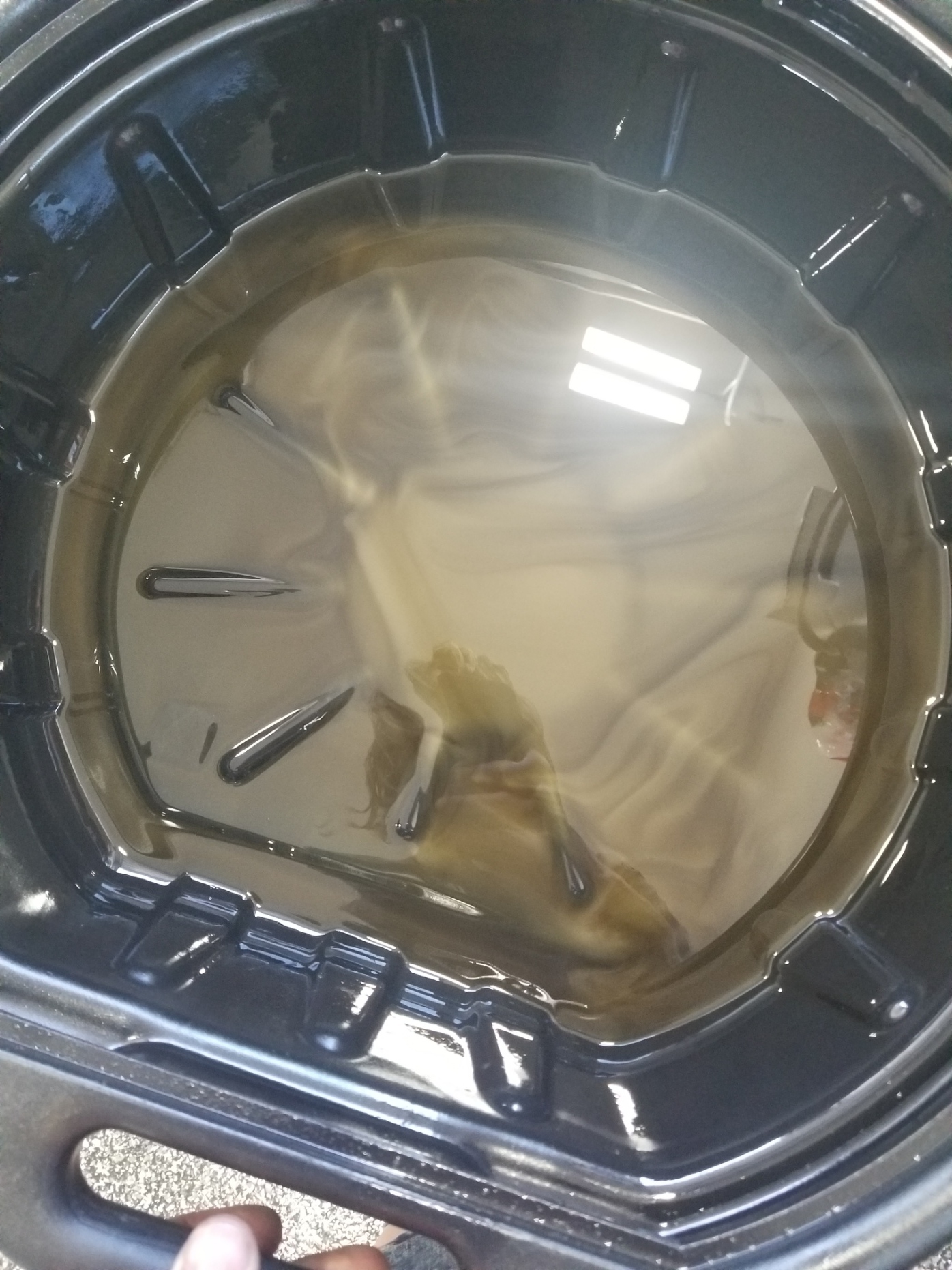

      Just when everything seemed to be goin so well........................
      suspicious oil
      so I dropped the pan and noticed this coloration on the crankshaft:
      So i checked the crankshaft play and found it to be around .014" which is a lot more than it should be. so I pulled the #3 cap:
      looks like it wiped out the thrust bearing all the way down to the steel.....which means that the crank took on some wear as well:

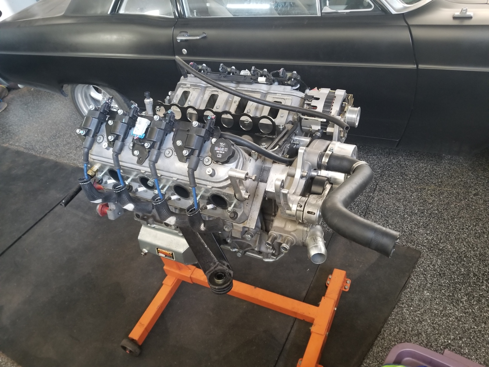

      So out came the engine:
      once disconnected from the transmission there was .040" of crank play
      looks like all the metal did some decent damage to a couple of the piston skirts so I'm looking at replacing the crank, pistons, and all bearings at minimum. But I don't have many good options for machine shops near where I live now (the one shop in town has been working ...or not working...on honing my block for the past 6 weeks.) so I'm not sure where to go from here. maybe there's a junkyard engine with a turbo in this car's future.
      Pretty much a heart breaker. I'd like to think things would be better if I had never looked because the car was running great. but the crank was starting to eat through the #1 main support, and the rods were running almost all the way to one side of the piston, so I suspect catastrophic failure was a possibility in the near future.
      Zach

      Quote Originally Posted by ryeguy2006a View Post
      Huge bummer about that engine man... Been following your car for years and great to see those pictures. There are a few vendors out there that sell balanced rotating assemblies that you can just drop in. May want to look into something like that and what a great opportunity for a stroker.
      This was a 418 stoker, so i'm looking at replacing with the same. I'd go bigger if I had the budget for sleeves, but....i don't. Sad thing about the 418 stroker (vs a 416) that I had not realized earlier on is that there is no room for repair. my bore is 4.080. the max bore for a stock LS3 block is 4.085, but no one makes a 4.085 piston.
      Open to recommendations vendors if you have any. buying a complete rotating assembly currently appears to be the best route at the moment.
      I picked my block up today since the machine shop never got to it. there are some minor scratches in a couple of the bores. Since this block is already at max bore, I can't really take much material out, so I'm just going to dingle-ball hone it and live with whatever scratches are left. The engine was running well and had no signs of blowby prior to tear down, so, despite not being perfect, the cylinders can't be that bad but I'll do some thorough measuring to confirm. from what I can tell, the cost to balance a rotating assembly is pretty similar to the cost of the rods. So, I might as well just buy the whole rotating assembly pre-balanced, and then sell my old rods for whatever I can get for them.
      This engine also had a custom grind cam that I wasn't super impressed with. it wasn't terrible, but I wouldn't mind having the power be a little bit more peaky and maybe around 600 crank hp. this engine previously dyno'd at 459 wheel hp. I'm guessing that's a little shy of 600 crank. Given the displacement I would think that power would be achievable without going too wild with the camshaft.
      Zach
