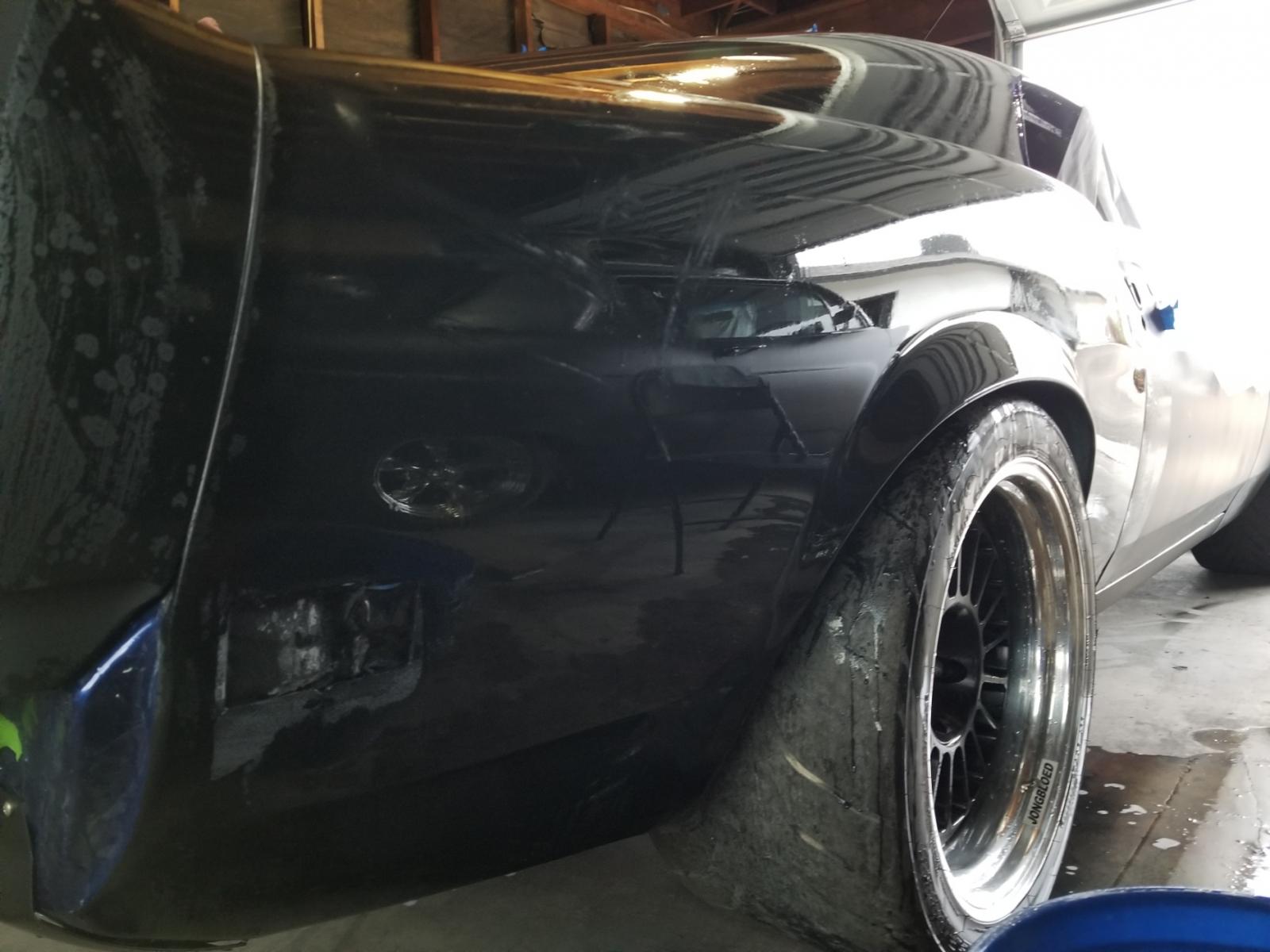

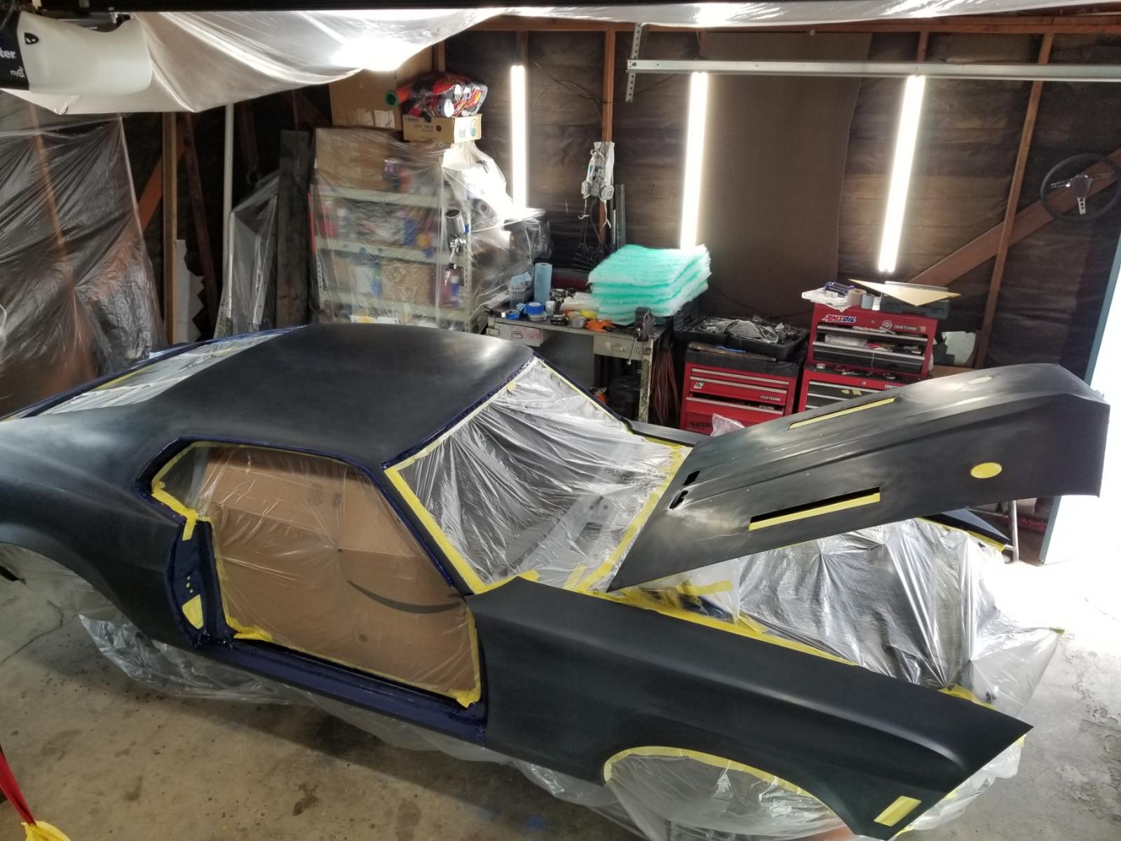

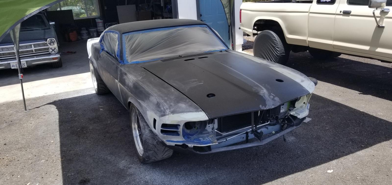

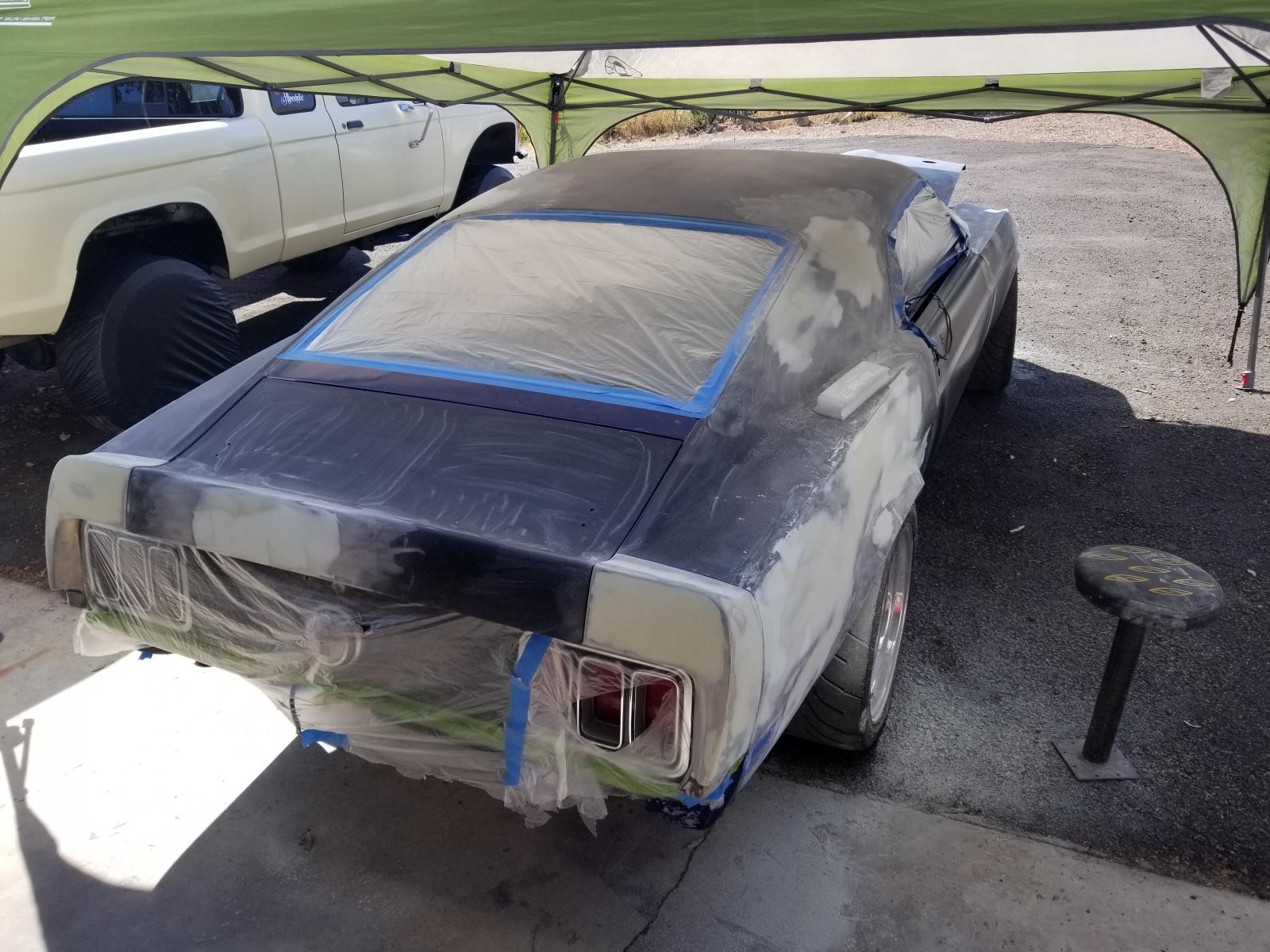

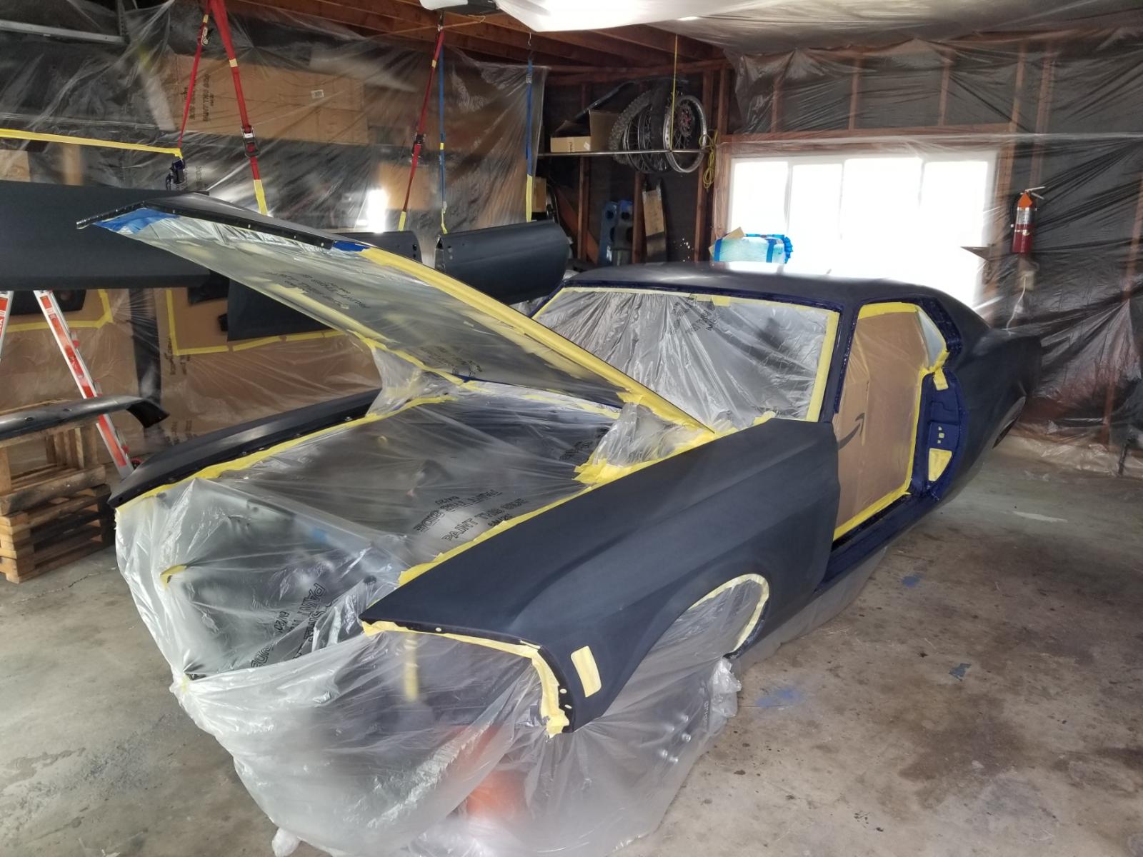

      Its been more than a year since my last post. but I have been slowly trying to break out of paint jail. I'm a bit of a novice at bodywork, so I think I burned a lot of time putting filler on just to sand it back off. Also, I lack proper tools other than a few sanding blocks. So, doing absolutely everything by hand has also added a bit of time.
      Here's a shot after a bit of wet sanding. things are starting to look pretty good at this point.
      Zach

      Here, everything is blocked with 400 grit, and masked for paint
      Zach

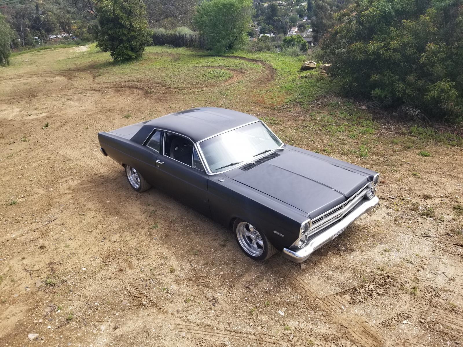

      Whats the story on the Fairlane in the garage?

      The Fairlane was my first car. Over time it has inherited many of the old parts that came off my Mach 1, some of which the Mach 1 stole from the Fairlane years ago. suspension arms and sway bars, springs, disc brakes, 9 in rear, t5 trans. It has 5.0 HO efi on the original 289. I also did the Shelby drop to the upper control arms which surprisingly made a massive improvement in handling. She's a bit rough around the edges, but a fun car to cruise around in.
