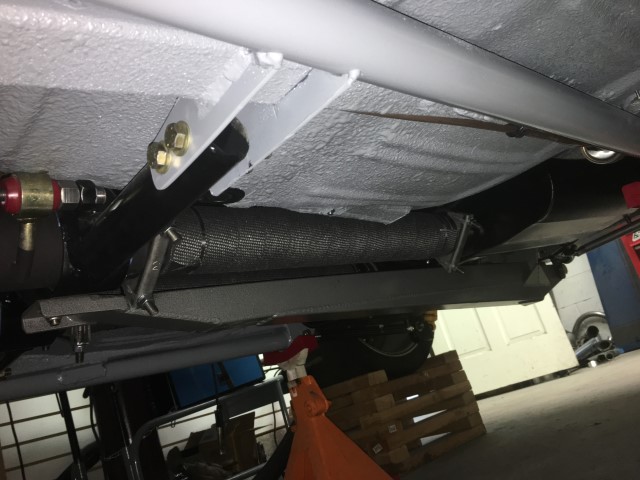

      Been a while, but I'm still picking away at this thing.
      I finally got the exhaust wrapped up. this is something that took way more man hours than I thought it would. I built a reducer to transition to 2.5 in after the muffler to be able to navigate past the Watts link. Sure I could have run it out the side, but If I can't do things the hard way, I usually don't do them at all. Plus, this car had side exhaust years ago, and I got tired of the smell and noise. I'm fairly pleased with the finished product.

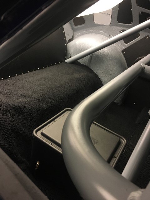

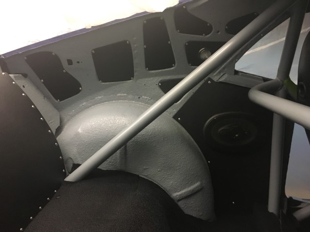

      To replace the back seat, armed with none of the right tools, I was able to piece together some straight pieces of carpet to cover the back half of the interior. I also wrapped the rear fire wall with some textured Faux leather vinyl.Name:  IMG_1497.JPG

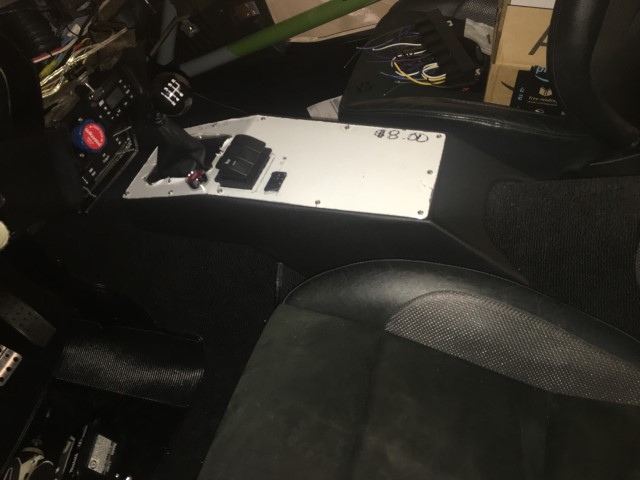

      I normally am not much of a fan of center consoles in old cars, but since the original steering column has ben deleted, I need a new location to house all of the controls that used to be integral to the steering column. So the center console will no contain the horn, hazards, ignition switch, and turn signals. The new turn signal will take a bit to get used to , but I'm using a switch off a motorcycle (which is pretty familiar for me) and I think it should work pretty well. Its not finished yet, but here's a few progress photos. The top will be wrapped in black wood grain to match the dash.

      here's the center console mostly complete. I need to finish up the wiring underneath. also the aluminum was to thin for the switches to snap in tightly, so I need to make an additional ring to snap underneath to hold everything tight.

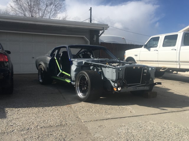

      Installed the doors. this is really just a test fit. I need them in place to line up the fenders so I can fabricate the front flares. the doors will also need a bit of work to make the gaps look right. Tons of work ahead, but for now I get the satisfaction of seeing this project become more of a car.
