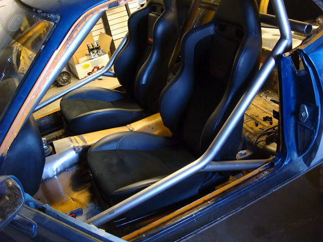

      a little more on the door bars. they are tacked in place now, ready for final weld.
      Attachment 61818
      Looks good iam doing evo seats also. did you cut out the seat humps? Also are you using aftermarket seat brackets?

      I used the evo sliders, and just welded tabs on to line up with the mounting holes on the seat pans. I also welded the bolts on so the evo seat basically installs like the stock mustang seat did.

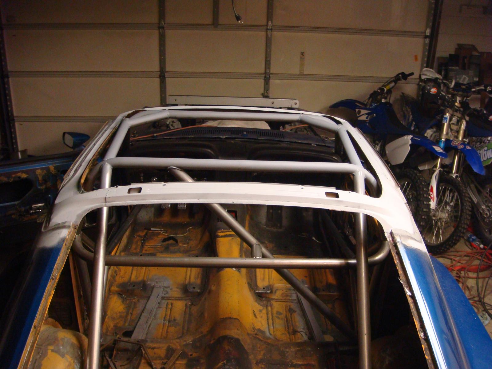

      Progress is slow as ever, but here's where things are at.
      Finished welding on the top of the cage and prepped everything for the new roof.

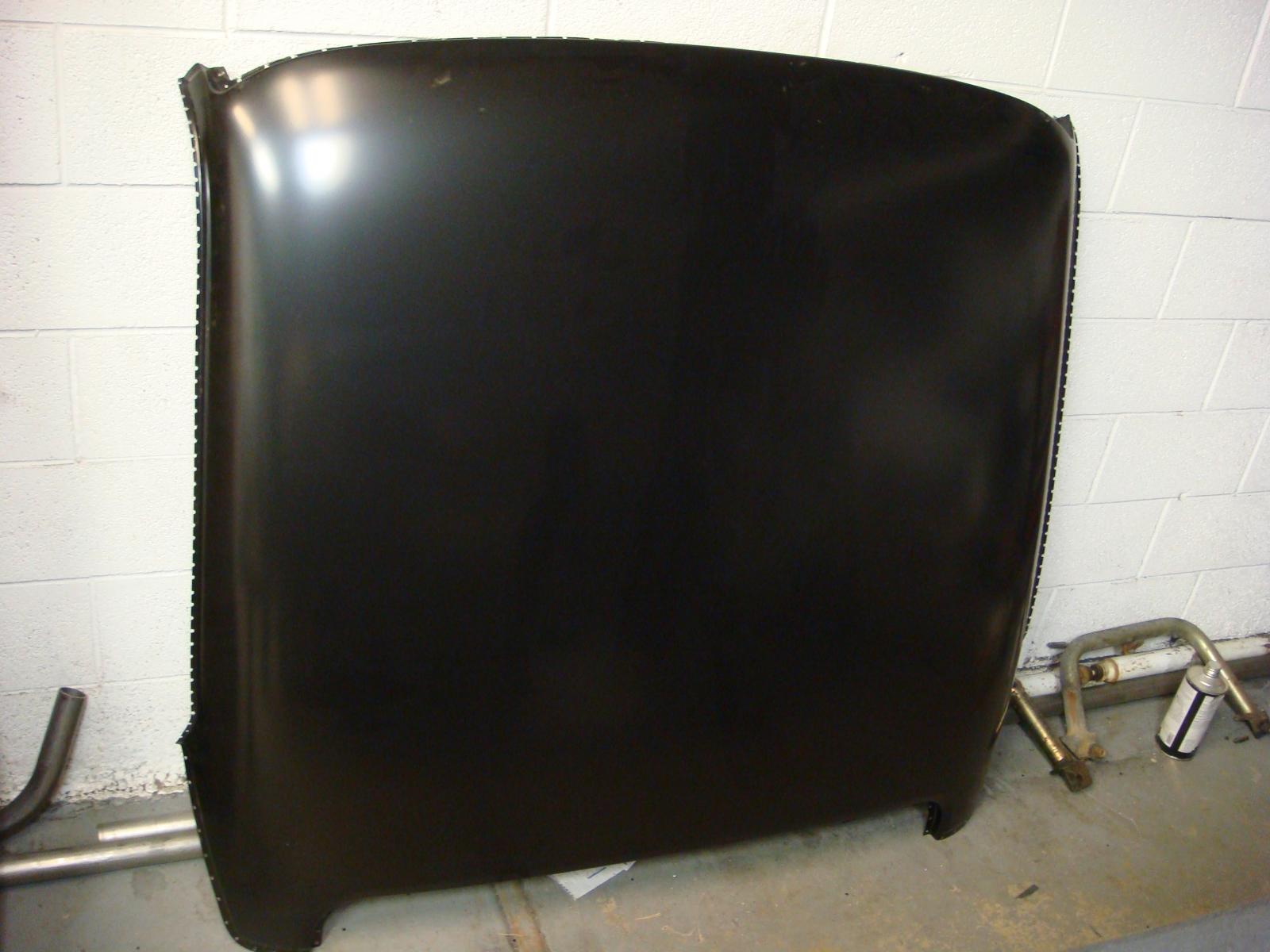

      New roof installed welding is about 1/3 done.

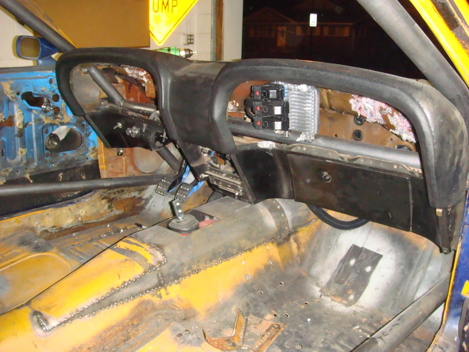

      Also mounted the computer

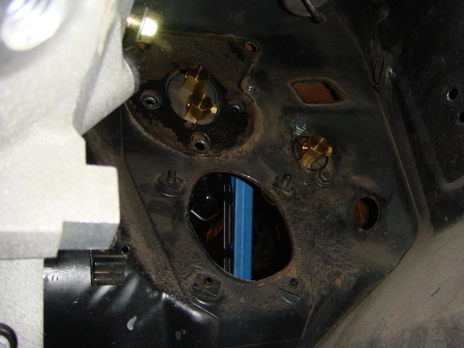

      Thigs are really going slow now as I start to work through the details. I added hydraulic lines to the pedals. all 3 pedals are all one assembly now. this should speed up the final assembly of the car after paint. the lines on the engine compartment side connect where the old brake and clutch pushrods used to pass through the firewall.

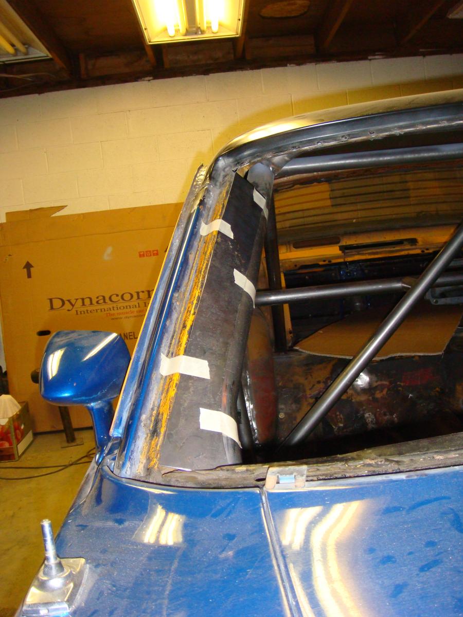

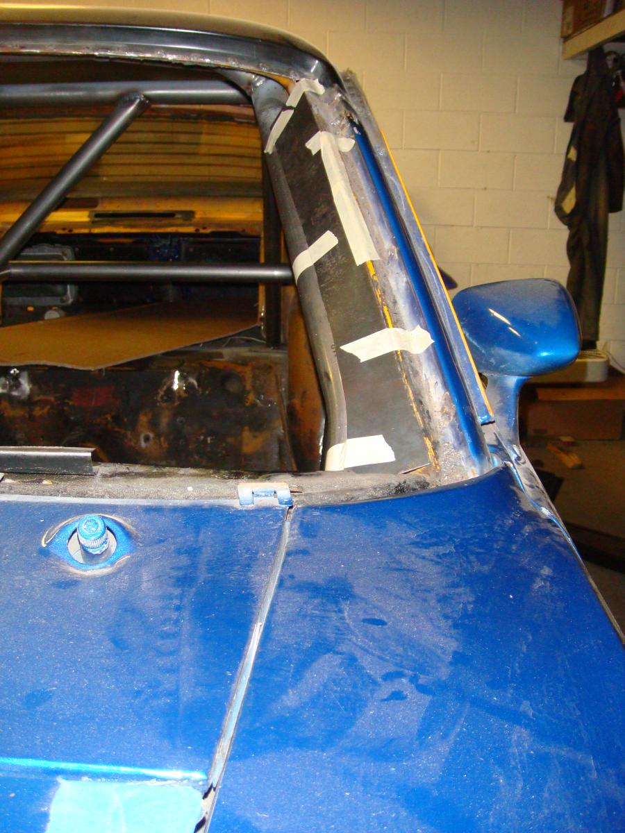

      A few more updates:
      started working on the bracing that goes between the cage and the body. here are the A-pillars.
Size:  138.8 KBName:  DSC02214.jpg

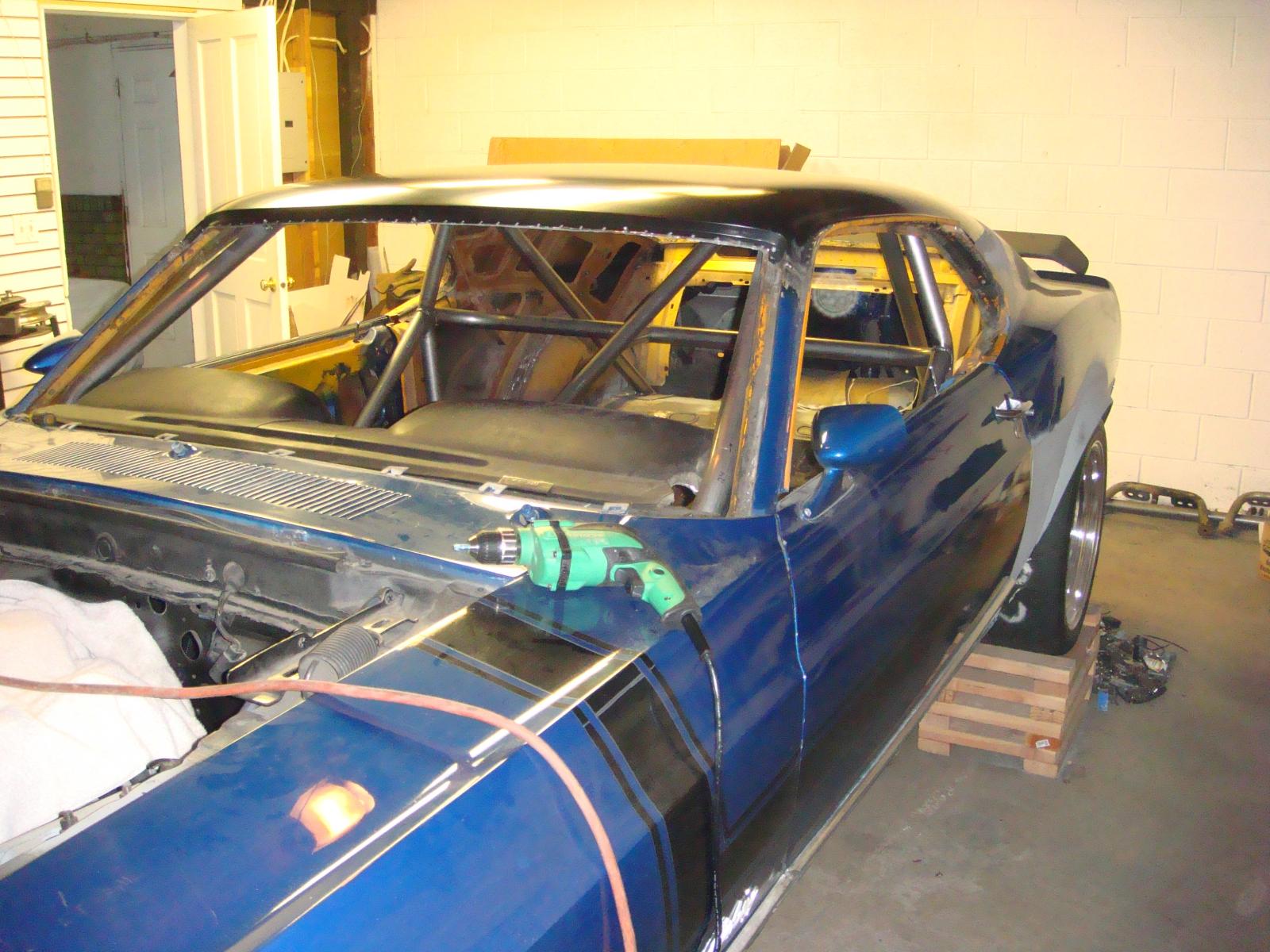

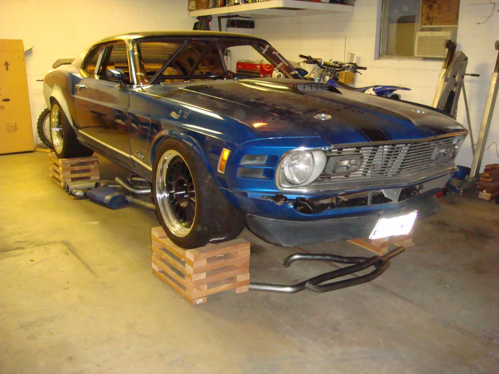

      ......and here's the car as it currently sits. Still in mockup phase, so like I have said a few times already, it all has to be disassembled.
