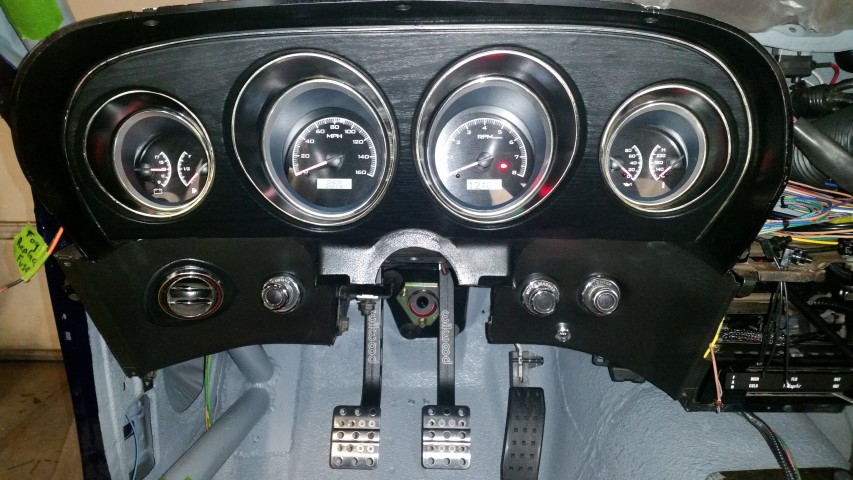

      Been ramping up production a bit lately. Most of it has been wiring, and hoses. so there aren't a lot of good pictures that show progress. I did get my Dakota digital gauges put together, and I must say this package is sweet. Easy to wire, and setup, and looks really good...probably better than the pictures show.
      While I was in the process, I decided I didn't like how the wood grain looked with the gray parts of the interior (mostly the roll cage) Plus the on the clock side of the dash the wood grain was starting to peel. So I ordered some black wood grain vinyl off amazon and re-wrapped my gauge bezels. The picture was immediately after install, so a couple small bubbles can be seen, but they have since disappeared.

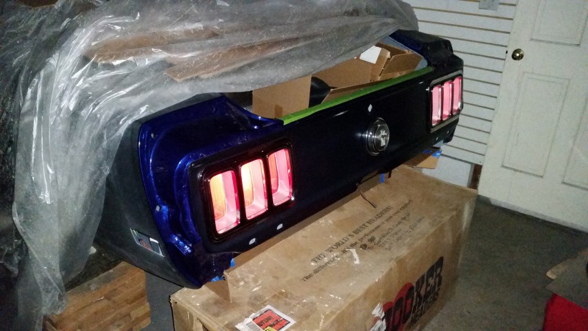

      New part showed up in the mail.

    13. #273
      16,129
      Oh yeah....sexy...

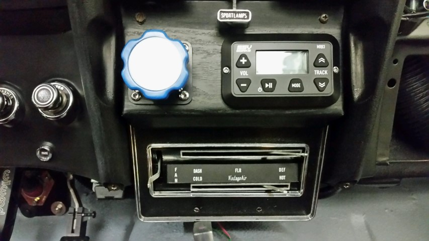

      I modified my radio bezel to house the brake bias adjuster. This created the new challenge of figuring out where to put the stereo. So I decided to use one designed for a UTV. what you see is just the control interface, and the head unit can be remote mounted. Really all this does is Bluetooth to a phone or other device. so I don't have a radio, but do you really need any other functionality these days? Its simple, reasonably priced, and doesn't have anything I don't need.
      Also I'm not sure If I like the bright blue. The knob may get painted at some point.
