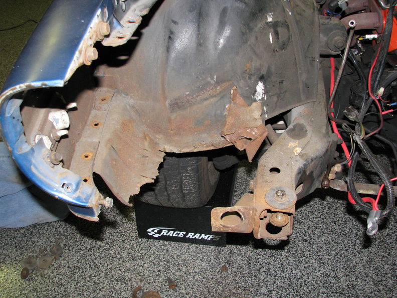

      Since safety is a big concern for me. The first thing I did was make a quick call to Race Ramps. I ordered up a set of 12" fixed height wheel cribs and an adjustable set of 12" wheel cribs. It's amazing how nice these cribs are.
      With the car on the wheel cribs I was able to get under the car and inspect the floors and work out a game plan. The first thing I need to do was remove the exhaust as I had already sold it and then start looking for rust problems.
      Scott (proTour73) was kind enough to come over and lend me a helping hand. He said it brought back memories of his restoration. Scott had the front end off in no time. I think he was hungry and I told him I was buying lunch at the local Mexican Restaurant so he worked really fast.
      Found some rust. Time to see if I can find some NOS sheet metal.

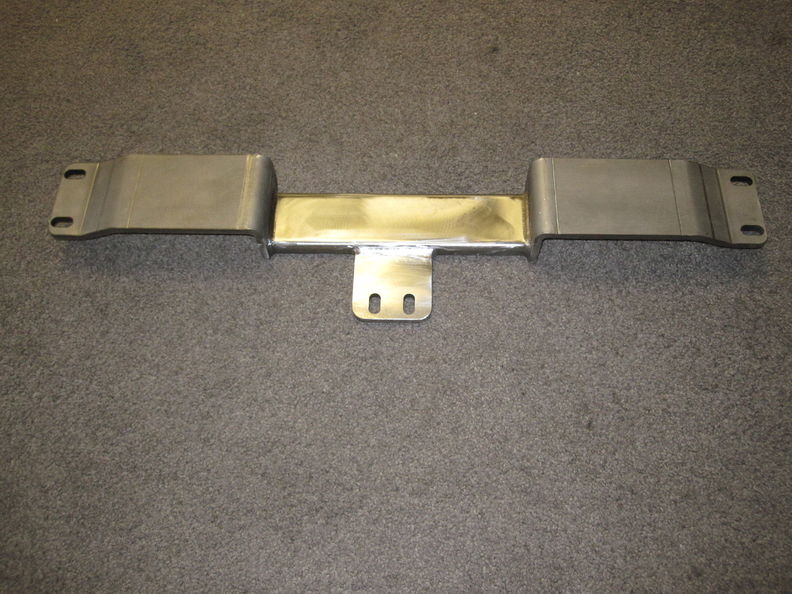

      One week later this crossmember showed up at my shop.
      This special modified crossmember is perfect and talk about hugging floor and offering perfect ground clearence.
      I can't wait to show you guys pictures of the crossmember under the car.
