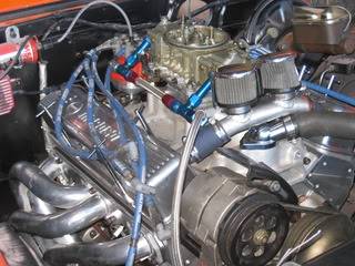

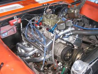

      Got my car back home from Kens Custom Auto Body and Paint last night. Had a busy day today. Completed grill, bumper, and side marker light install and then installed engine, trans, driveshaft, and radiator.

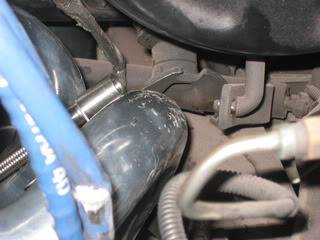

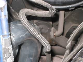

      Car is at Caspers Muffler Service in Shingle Springs getting exhaust installed today. Bad news is its with my 1 3/4" headers and not my new 2". The 2" conflicted with my steering shaft. I also had to beat on them with a hammer to clear control arm. Do yourselves a favor and never buy 2" primary headers from Hooker. They shorted me the sub flanges and the 3 collector pipes that are supposed to come with them. Luckily Summit will take them back.Here are some photos of engine and header conflict with steering.
