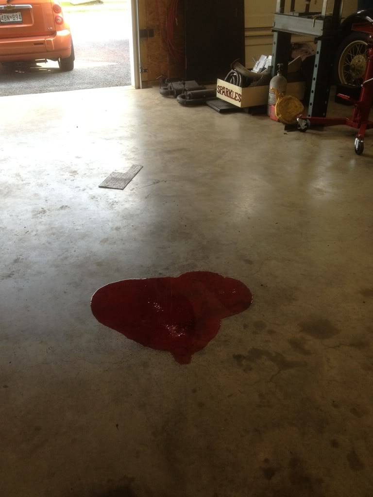

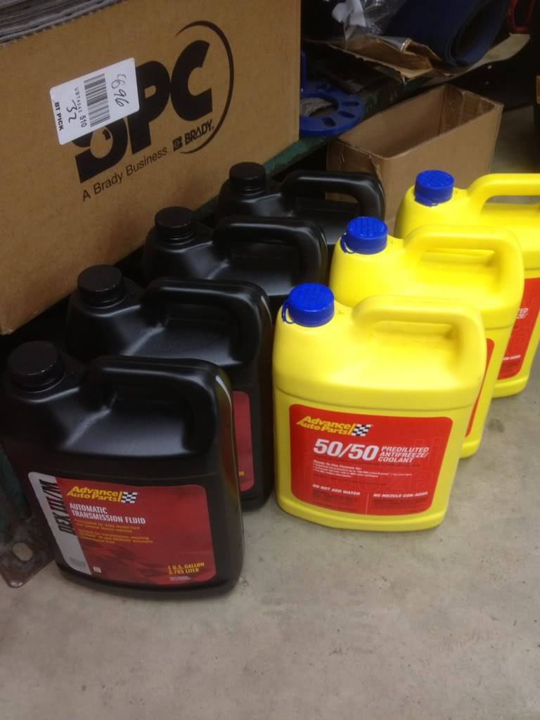

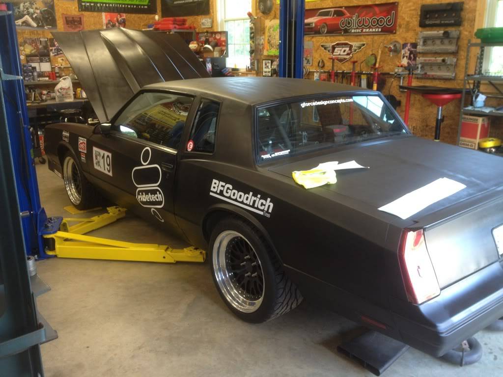

      went to go put in the trans fluid and I guess I put it in too fast....b/c it started to leak from the top vent after only 8 quarts!!!!!! whoops...

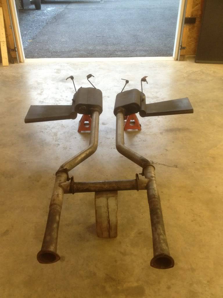

      This is my exhaust...all dirty and nasty. I cleaned it all off and painted it before putting it back up.
      Upon cleaning the mufflers I saw a small hole in one of them where a weld gave away. I had to patch that before finishing the painting!!

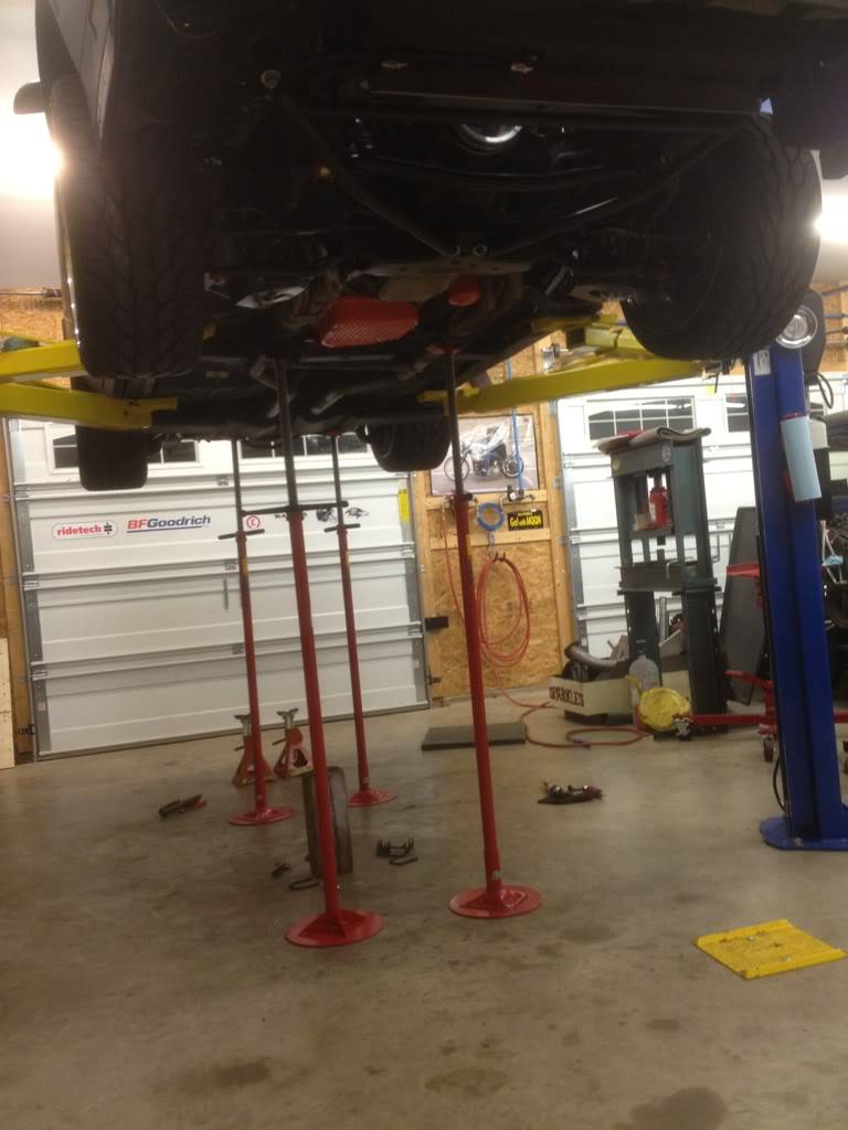

      These screw jacks are a life saver when you have a bad back!!!

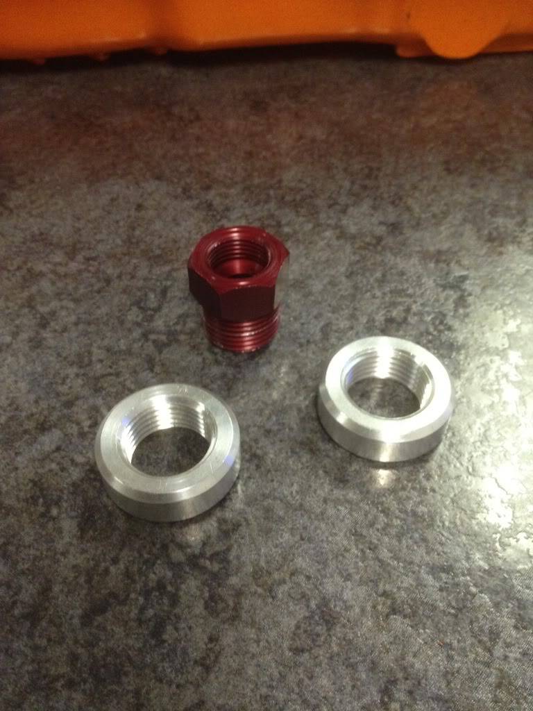

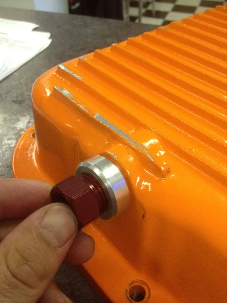

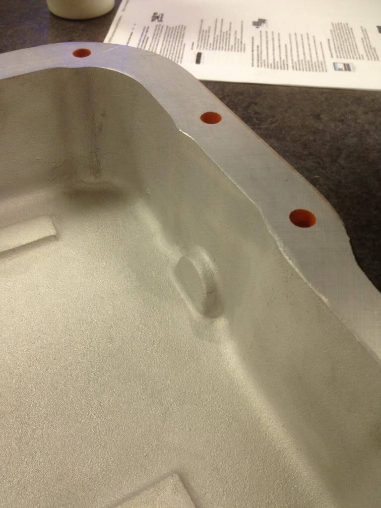

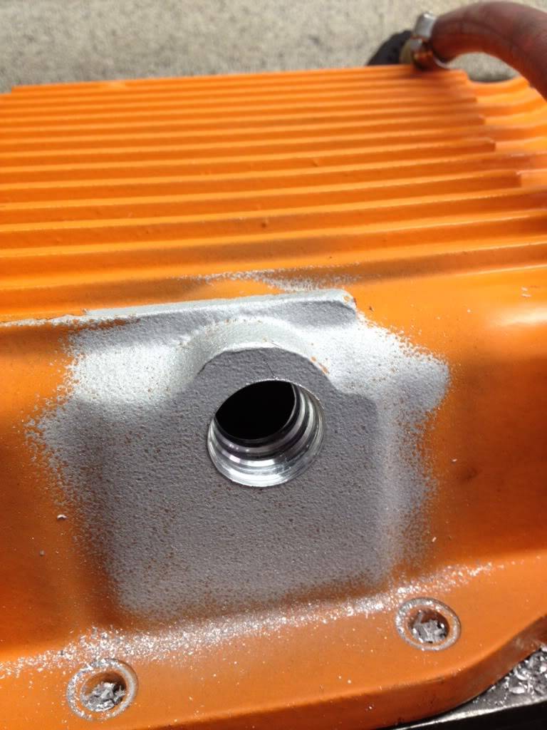

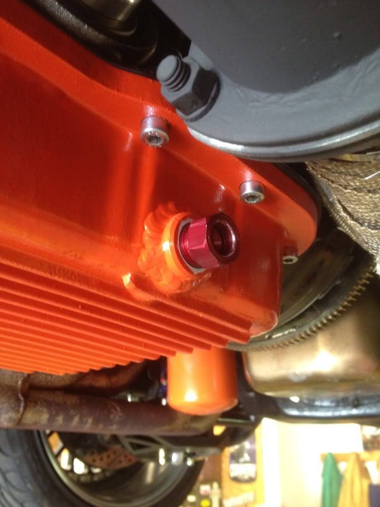

      Jason Huber over at GForce Design Concepts got the 1/2 NPT bungs for me. He originally tried to tap it, and we both knew it wasn't going to work, but was worth a try!!
      He sandblasted away some of the powdercoat and fit up the bung.
      All welded up!!!

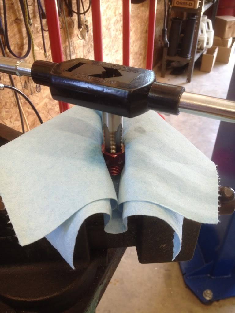

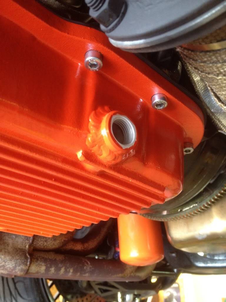

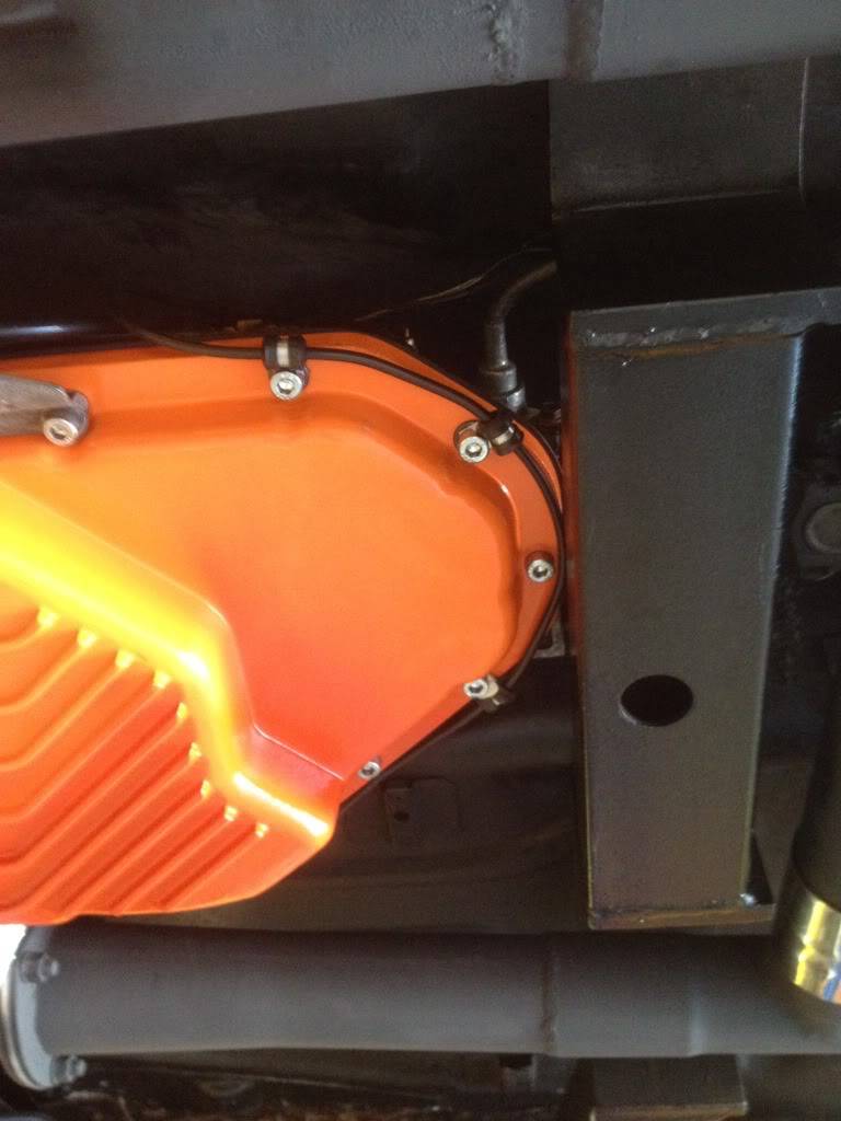

      I went up to the shop and brought the pan home to finish the installation. The threads on the 1/2 NPT adapter were a lil buggered up so I ran a tap in it and they cleaned right up!!
      The pan is now all painted up and installed on the trans.
      Now to install the fittings!!

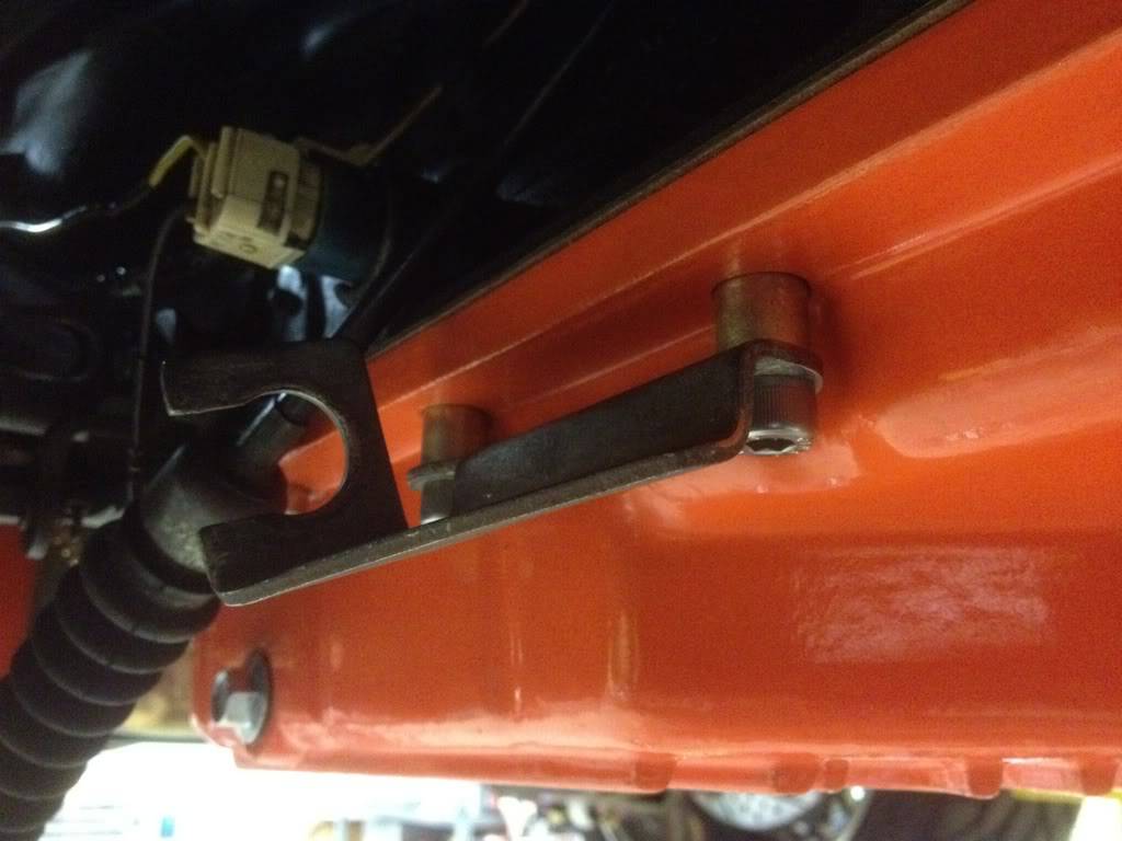

      I ran the temp sensor cable/wire through some 1/4" line clamps that attached directly to the pan bolts for a nice and clean install. After that I just routed the wire up to the gauge. It was a lil bit tough since this is a mechanical gauge but the wire bent pretty freely. I did avoid very sharp bends though.

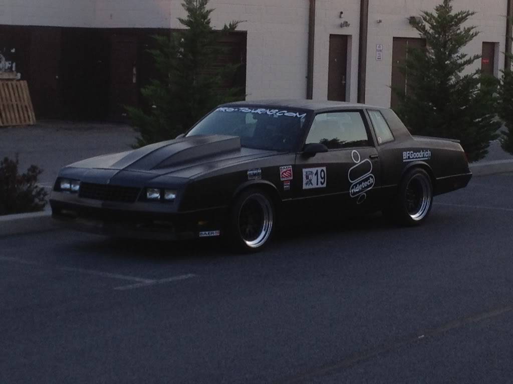

      I drove the car all day yesterday and today and only saw a max trans temp of 180 degress. I do have a hugeXhuge Derale trans cooler with it's own fan so that might have something to do with it!!!
      This was taken this morning at a local Sunday morning cruise in we call "Donut Church".
      and tonight at dinner......car drives so well now!!!!!

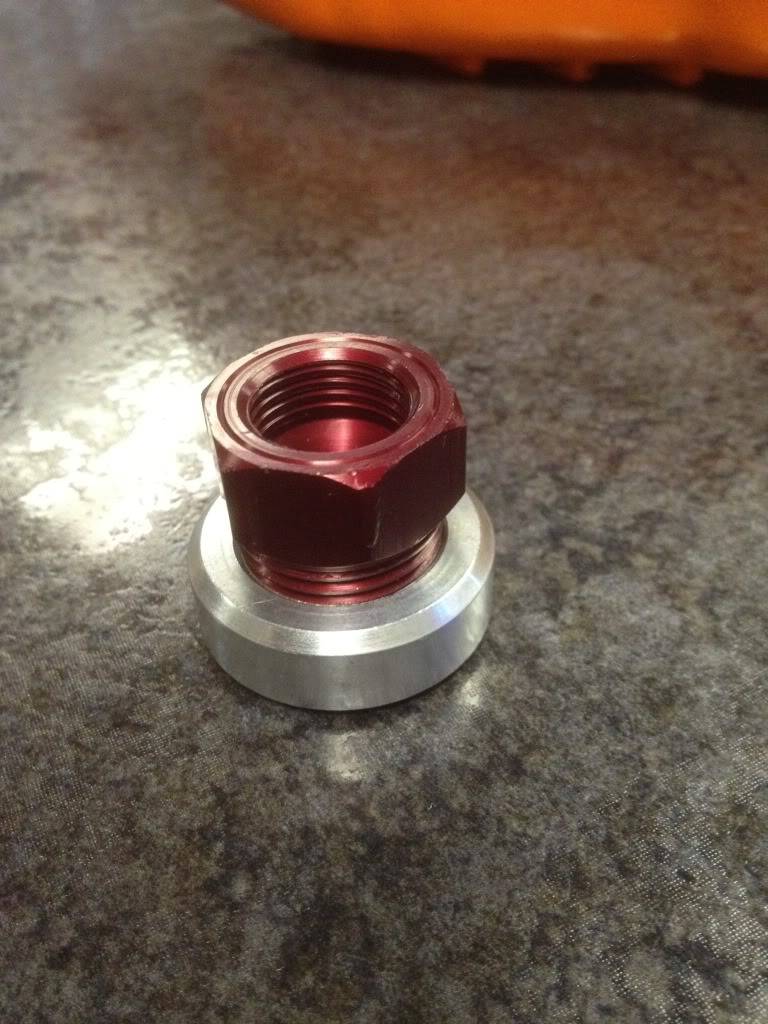

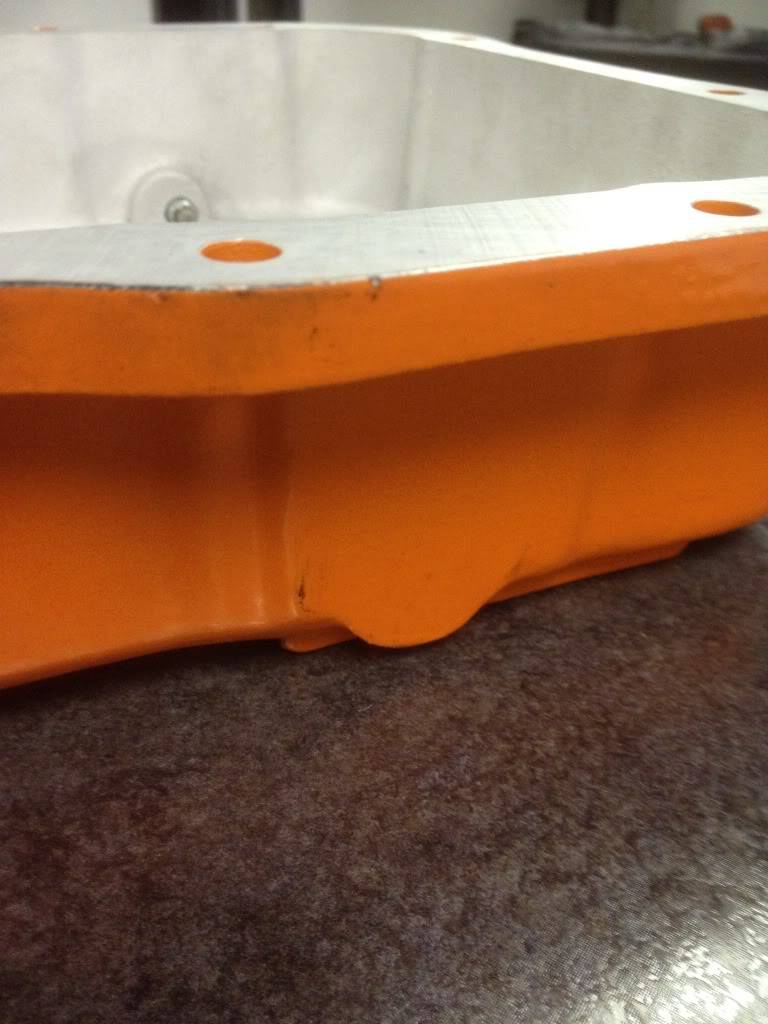

      Ok the trans is in and everything works well...except for the trans temp gauge. I had to install the temp sender into the pan. Here's how it went!!
      This is the PML pan with the trans temp sensor boss.
      My fitting is has 1/2 NPT threads and seemed to be way to big for the boss on the pan so we decided to get a bung and weld it on.
