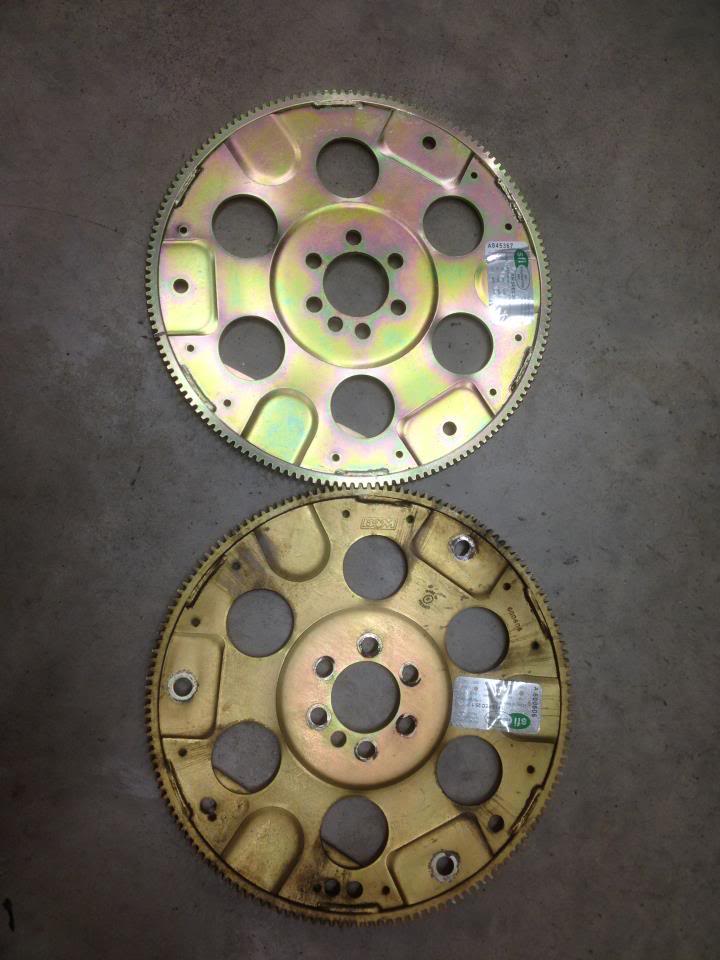

      UPDATE:
      New vs Old
      Old vs New

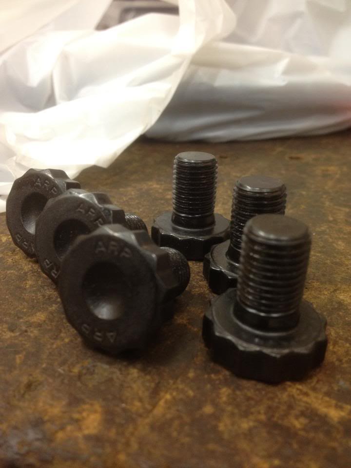

      Flexplate bolts...
      Pic of my exhaust...

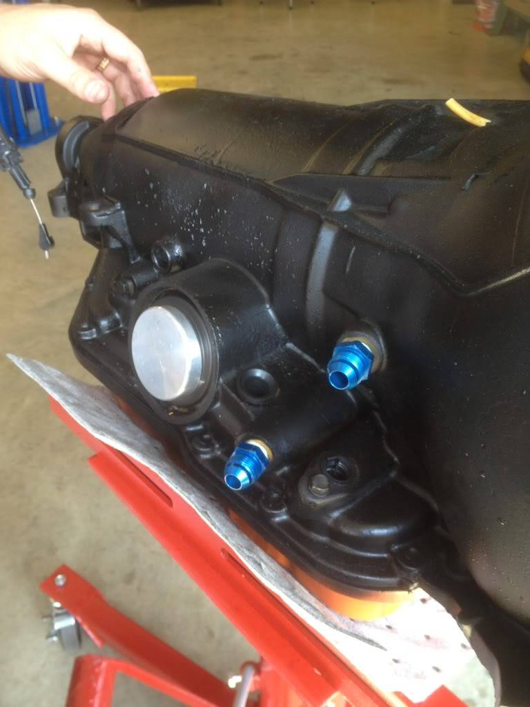

      Side pic of the new trans...Billet Servo...Billet Front Drum...Billet Input Shaft...Hardened Everything else...this one shouldnt break!!!

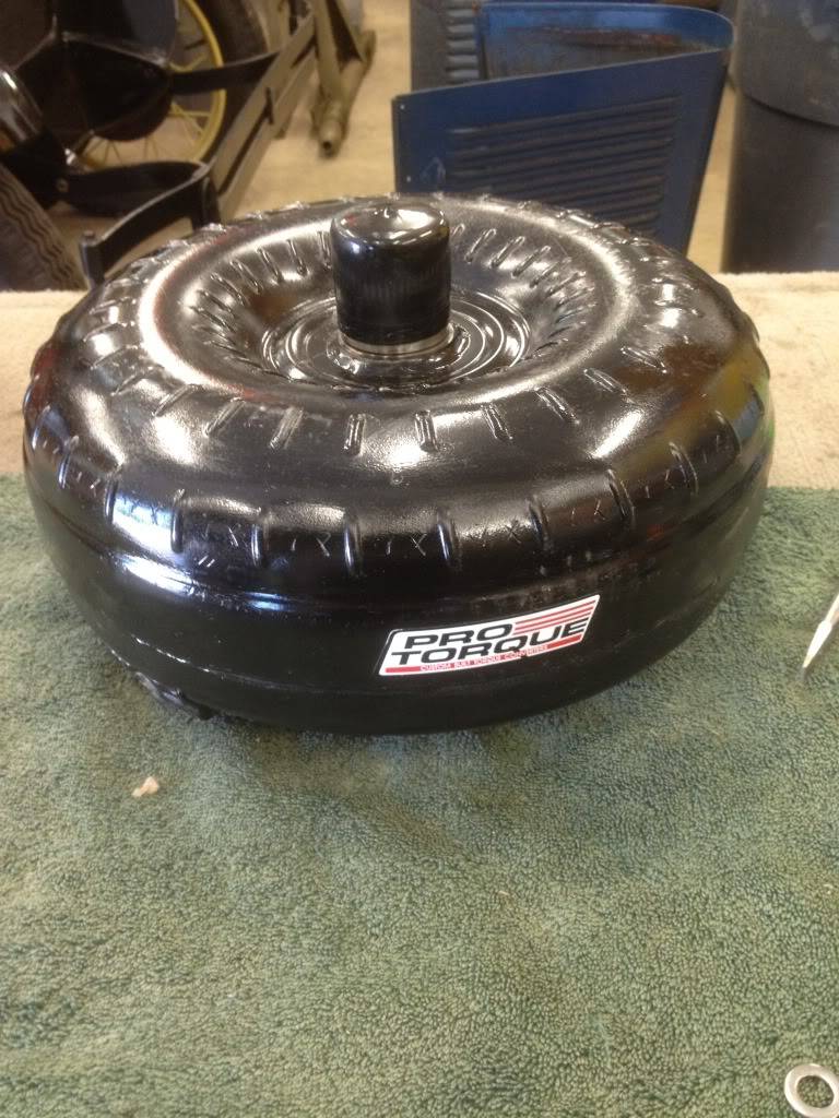

      New Pro Torque Converter!!

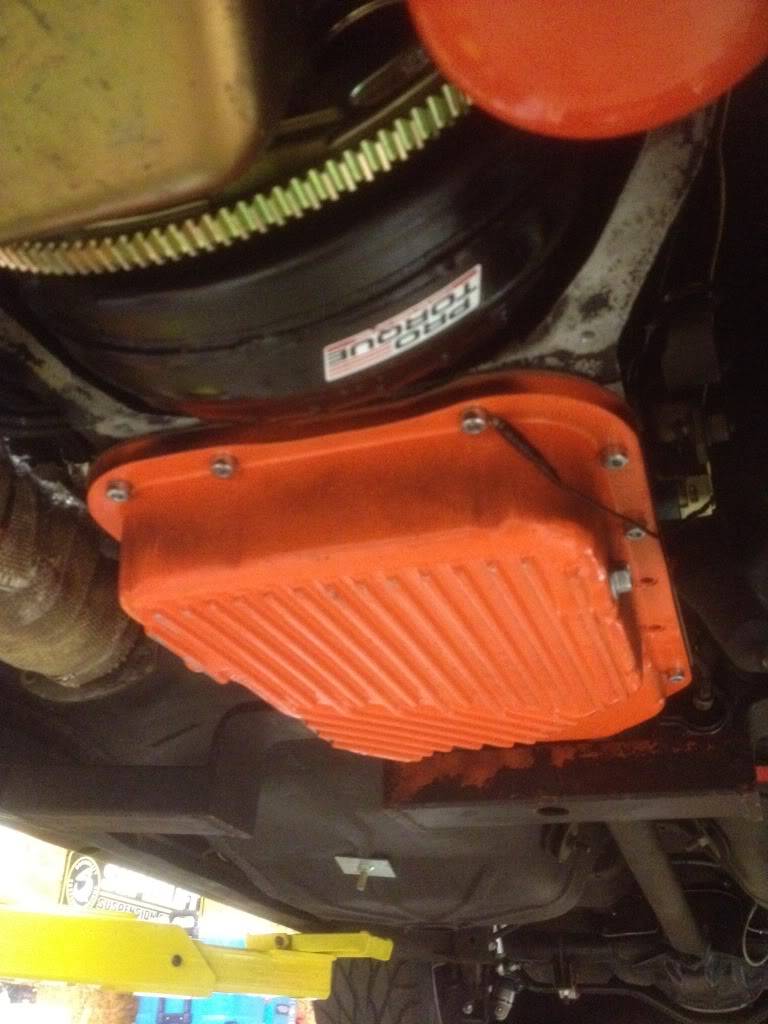

      New Flexplate, PT Converter, Trans and new trans pan all installed!!

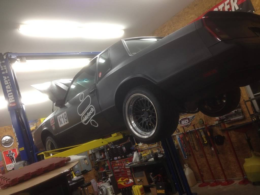

      Car as it stands tonight. Still need to wire up and plumb the trans cooler and re-install the radiator.
