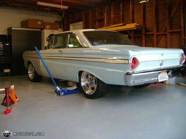

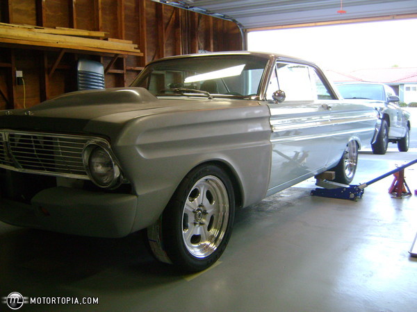

      The Falcon on four wheels.
      Those shocks might give a rough ride.
      I will have a more descriptive write up about the status tomorrow.

      Looks great, I am jealous, so is this the anticipated final ride height or do you expect it to settle a bit?

      Nice! Got a soft spot for 60's Falcons...I've owned a couple over the years, including my first car.

      Looks nice sitting there. I like how the wheel tucks in with the line of the rear fender.

      FINALLY! Thanks for posting, looks Cool :

      Those wheels look very good on your car Bryce!
      The front will settle between .5" and 1".
      And thank you! Hopefully you will have your falcon done soon!

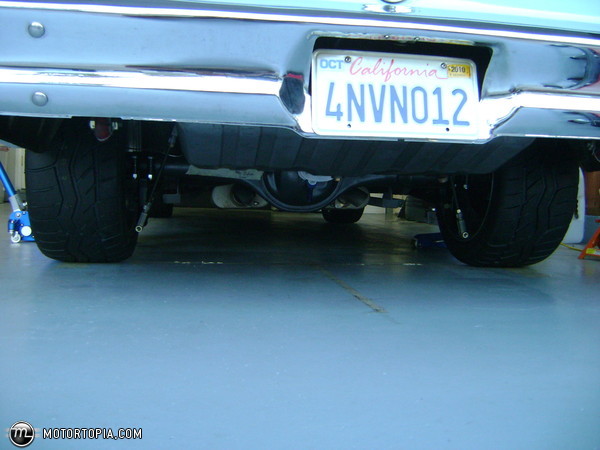

      Pictures are nice but here is the update:
      The front end is on the ground but needs to settle about one more inch. The back end is fitting the 275 wide tires. But I only have a 1/4" clearance on the inside wheel well. Some mods will need to be made to make room, minitub in to the frame rails will give me plenty. i made all the spacers for the LCA to spring eye attachment. With the car on the ground I verified all my previous measurments and re-ran my rear suspension calculations. The Axle mount for the LCA needs to be drilled so the LCA is horizontal at ride height, I was already expecting this. The UCA chassis mount will be modified so it can be adjustable. I will order the AFCO T2s today. I have a 14" shock at ride height. there is alot more work but its coming along. ( I should have spent more time on the car last week, but i did get my house decorated for christmas and my tree up so I cant complain.)
