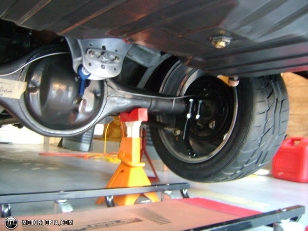

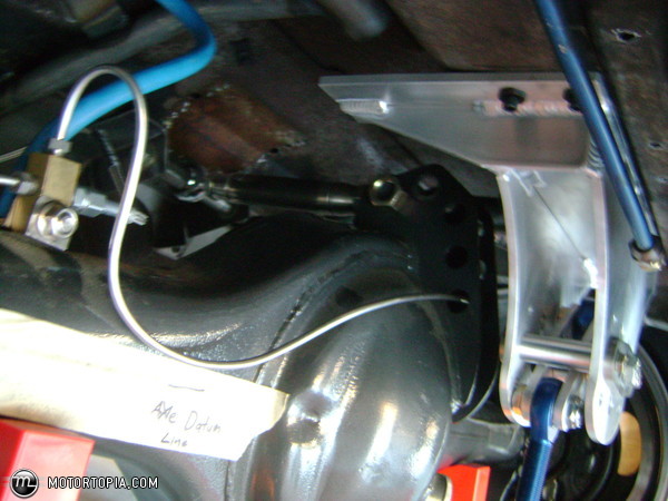

      I know panhards and watts both work pretty well, but let's face it, the Watts link just looks so cool and mechanical. They make more sense to me too. Very nice piece.
      Stephen
      san diego
      5,101
      Quote Originally Posted by srh3trinity View Post

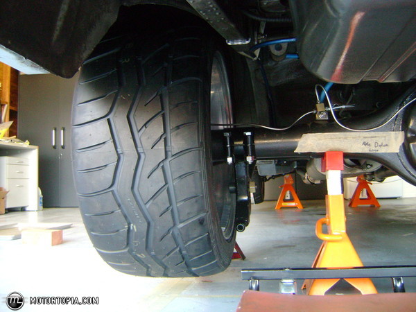

      Watts can work better. They usually have a higher roll center. In my case I was more concerned about the tires rubbing with lateral movement.
      san diego
      5,101
      I dont think so guys. Actually I am using the floor for structure. SO i cant weaken certain areas. I will have a bolt in access were the axle side third link mount will penetrates the floor.
      san diego
      5,101
      I now have three links but not a 3-link.........YET.
      I made the two lower control arms yesterday, removed all the old suspension. Today I will mount the LCA mounts and the coilover mounts, the LCAs and I will make some cheap shocks/springs; they will be very stiff tho. HAHA.
      I ordered my aluminum threaded tube for my watts links yesterday, it should be here on wednesday. It looks like I will have a lot of work to do over the long weekend.

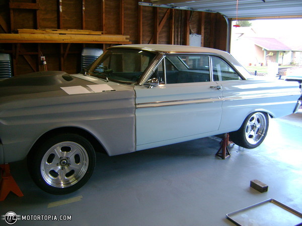

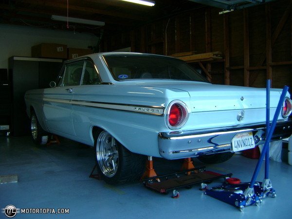

      I got the three link in and the wheels on. I need to massage the inner fender to get more clearance. But I nailed the back space and max width!
      All pics are at droop maybe 1.5" to 2" lower than previous ride height. Im still thinking about changing the chassis third link mount.
      Birmingham, AL
      3,355
      Looks like you nailed the tire size too. Looks like it maximizes your wheel tub space.
      Stephen
      san diego
      5,101
      Yep, its maximized. 275 is the biggest. I think these are a 10.8 section width on a 9.5 wide wheel.
