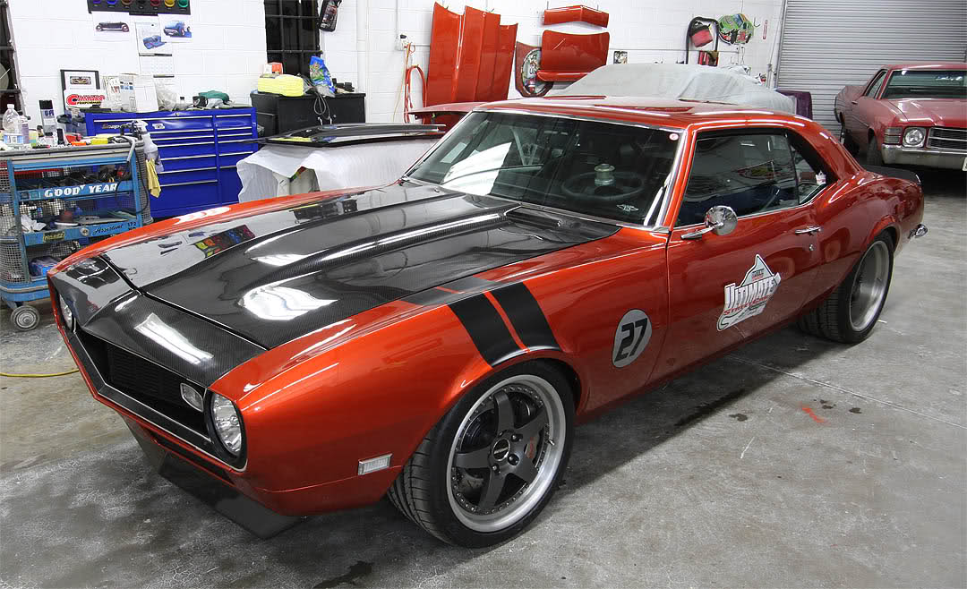

      Steve now it looks the part of race car, I love it.

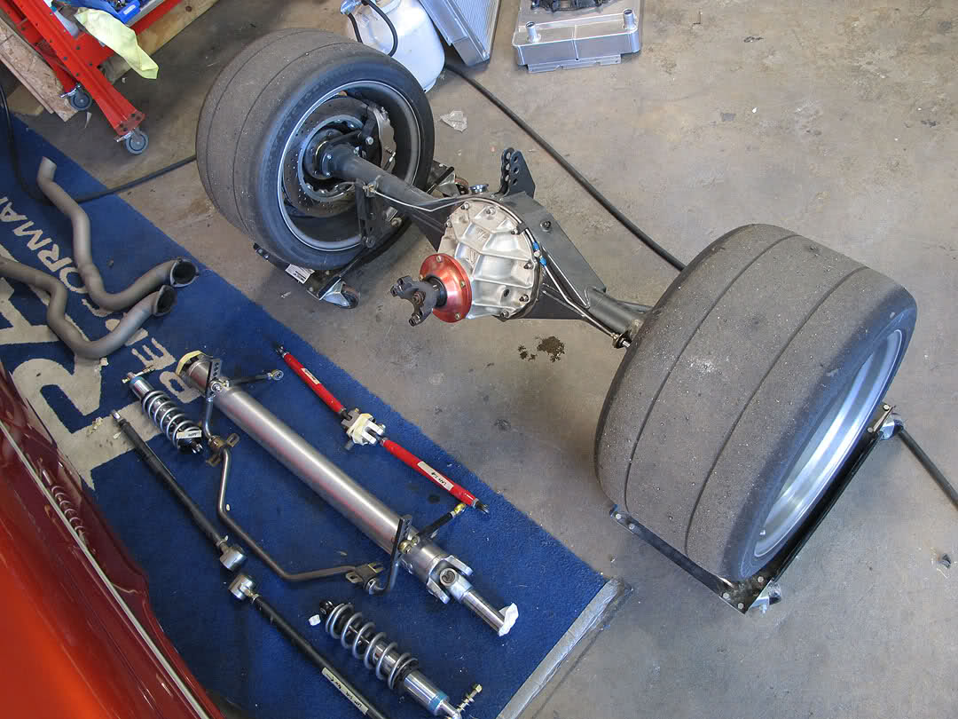

      The only concern I have is the crowed drive end of the axles are showing more were than I would like. We used steal drive plates and it looks like the axles may need to be replaced every 10 to 15,000 miles?
      A floater rear is one that the rear wheel is mounted to a hub that spins on a spindle mounted to the rear end housing. The axle does not support the wheel in any way, It just drives it. The axle has splines on both ends and their is a drive plate that mounts to the hub to drive the hub and wheel. The axle can be removed without taking the wheel off. Just take off a retainer cover and slide it out.

      Penny looks great Steve!! I didn,t think it could look any better, but it can!! Good Luck at the Challenge.

      DONT change a thing! That looks NASTY!

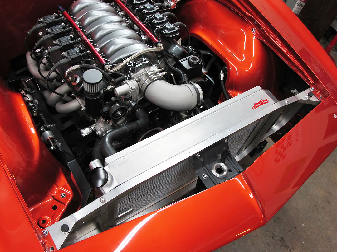

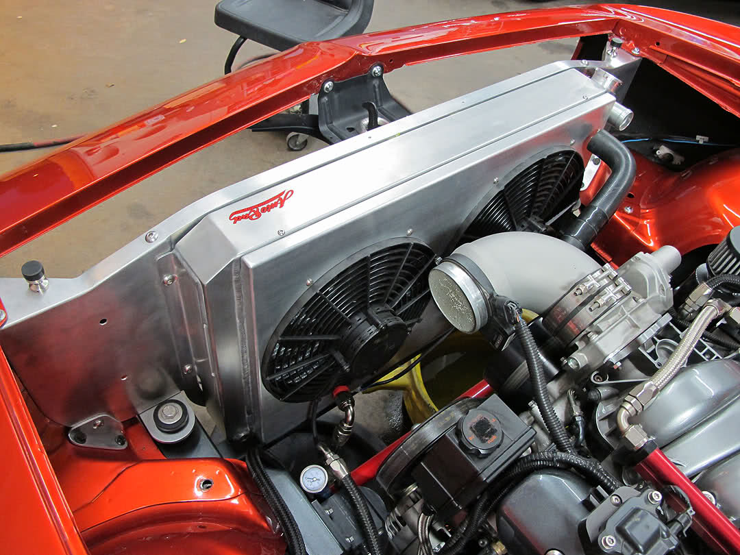

      Today we started tearing down.. Also decided to try out this Autorad radiator and core support. I doubt it saves weight since the radiator is WAY bigger, but it's nice and I was curious to see what's up.
      As you can see the opening is much much bigger than that stock core support. This should provide extra cooling capacity.
      Gotta break some eggs to make an omlette.. This is really just a dry run since it will all come apart, engine out and fenders off so we can do some mods to the inner fenders.
      Here you can see the new radiator in place. There were some fitment "challenges", but nothing insurmountable. I want to talk with the company on Monday to get thier take before going into detail. I love how the radiator fits to the new core support.
      Another view... we're going metalwork the DSE closeout panel to work with this system since I like how it comes "into" the engine bay.

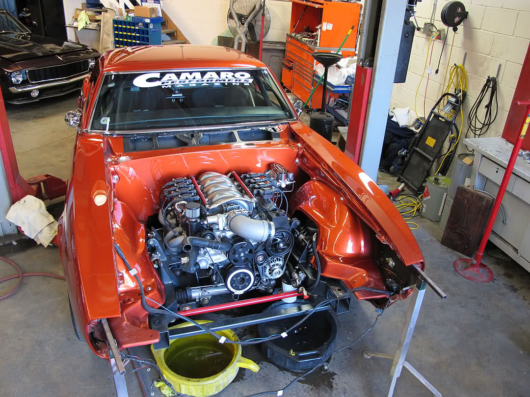

      Oh what the hell, let's take the whole car apart.. lol.. Next to come out will be the trans, engine and all the brake plumbing.

      That Auto Rad is an awesome looking setup, and the carbon fiber stuff is pretty trick too. It looks good on there.

      That looks pretty sweet! I caught a glimpse of those at RTTH, nice stuff.
