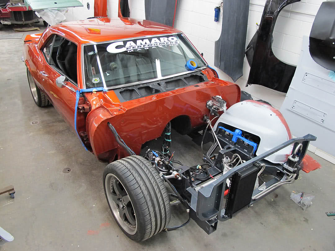

      Lots of work done today.. fuel tank is in and we started final fit on the new inner fenders. The new core support and oil system is done and you can see it here mocked up.
      Engine build is now set for Tuesday with install starting on Thursday. We hope to have her ready for Del Mar Goodguys.

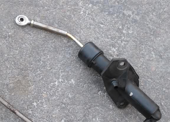

      Found a few interesting deals during the teardown.
      One was that the driver side sway bar arm on the splined sway bar was VERY loose.. just sorta flopping around. I'm sure we tightened the hell out of this. More that likely didn't help in one direction of turning.
      The clutch master rod was bent all to hell.. we will add a stop to prevent over compressing the rod. No wonder it kept getting harder to get in gear..

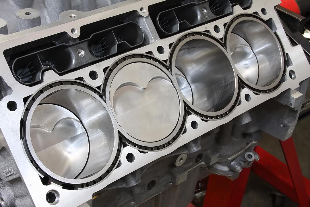

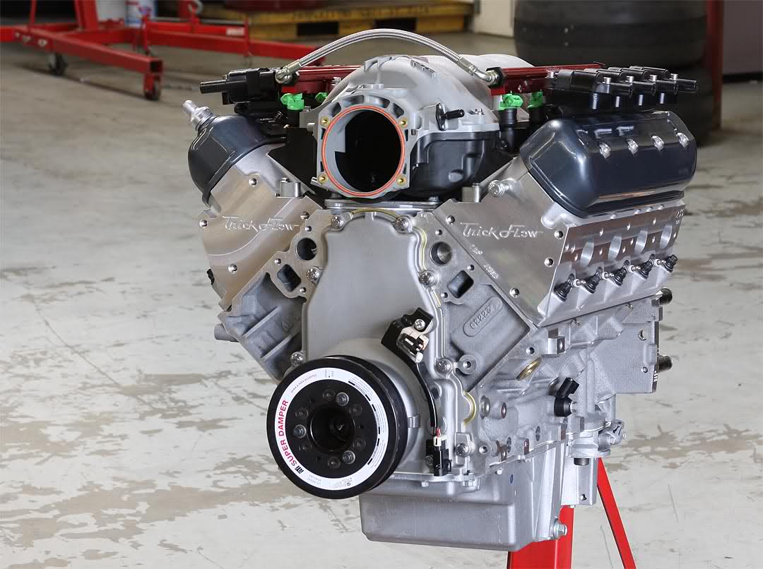

      Built the engine today over at Turn Key Engine Supply..
      Penny's new alum 454:
      4.185 bores using Darton's MID sleeves. Wiseco pistons.
      454 Ready to head off to Westech for dyno runs on Wednesday.. any guesses? 72cc TF 235 heads with 9.235 deck height and Cometic gaskets should yield 11.3:1 compression.
      Will start the install on Friday. The Canton oil pan is off at our tig welder getting a little mod.

      Penny's new alum 454: Ready to head off to Westech for dyno runs on Wednesday.. any guesses?
      Hey Steve,
      EVERYTHING looks GREAT!!
      I don't have any idea about your cam choice but I'd take a guess...
      - 680 hp @ 6,700 rpm's
      - 585 ft-lbs @ 5,200 rpm's
      I'm sorry if you've already answered this but what size tire and wheel combination will you be able to run up front with the inner fender mods? Will it be a 295 series tire?
