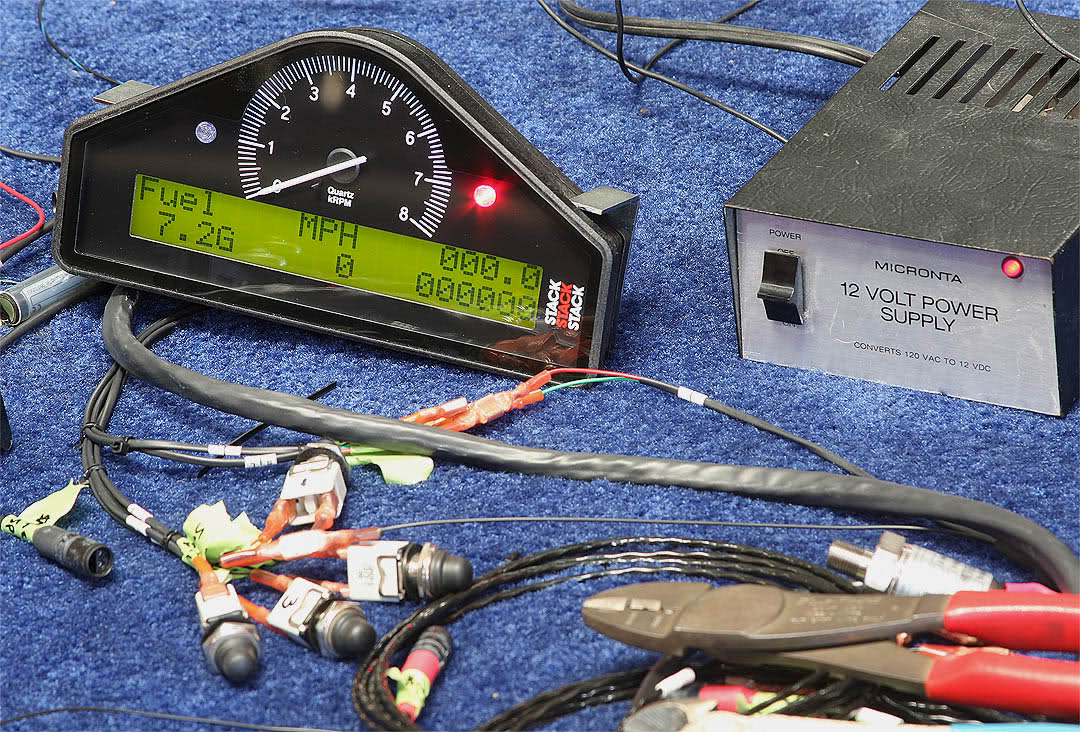

      Thanks for the installer advice

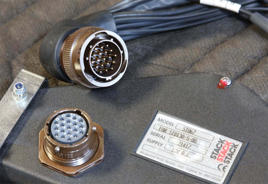

      Today Chris at BOS worked on wiring. The STACK stuff is really nice, all the wires are labeled and the instructions seem to be very clear.
      Chris built the loom and then hooked up some 12v power to it to check functions.
      The center section is off at powder and we're waiting for the Covans dash to arrive. Once we have that everything can be mounted and secured (including the audio stuff).
      The red warning light in the picture is telling me I have low oil pressure. The other light is to warn of low fuel. The dash can also display data logger stuff but I already have a Racepack so I didn't get that STACK option.
      Also noticed the the new senders are VERY nice as well.

      Steve,
      I like that it has a "real" tach and not an LCD one.
      Yea, that's what drew me to it as well. Analog is just so much faster to track. Reading takes far too long.
      The STACK stuff has a ton of features. Like how the water temp and fuel gauges both have relays that can trigger fans and fuel pumps.
      Plus the quality is off the chart.. like the mil-spec connectors..

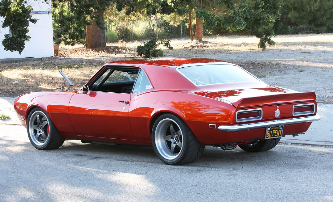

      Wow, the natives are restless!!! lol
      Here they are.. sorry for the crappy angle, will get better shots later.

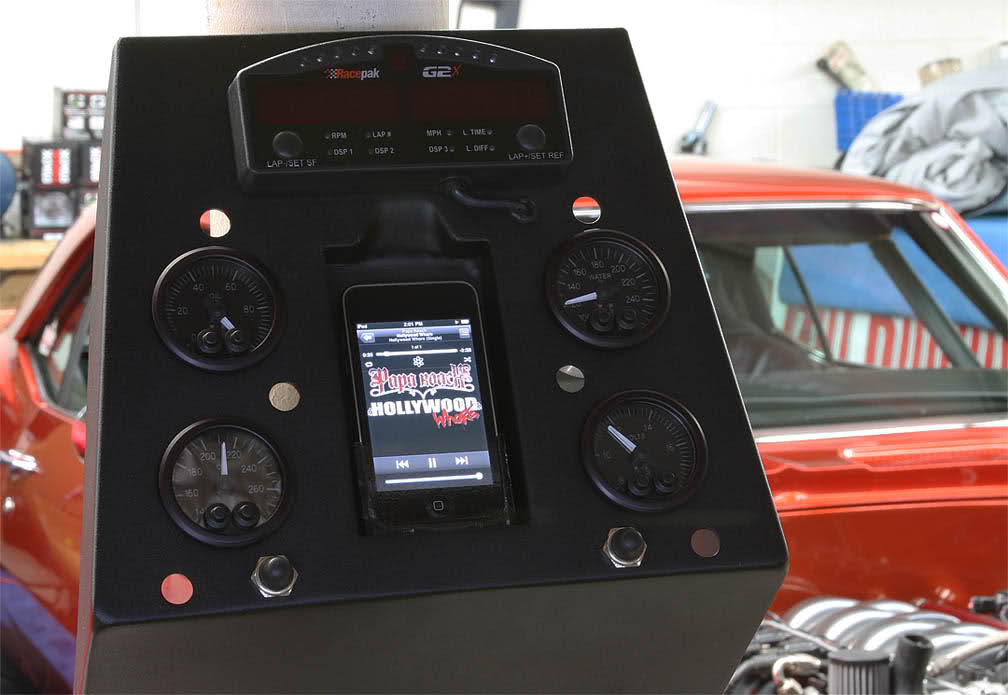

      Mock up of new new center section.. Still need to add some switches and turn signals.

      I think I've found a way to read the VSS off the ECU. I have the sensor as a back-up
      I don't have any of the data logging since I have the Racepac.. but it looks pretty darn good.

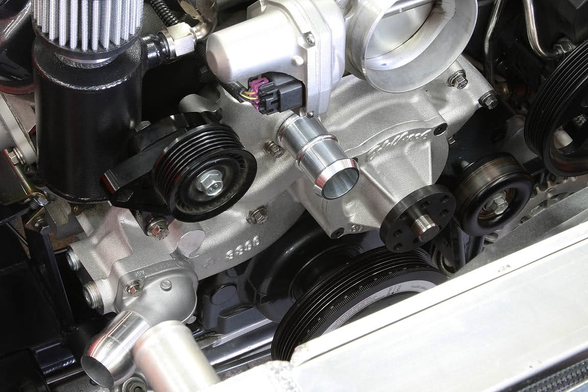

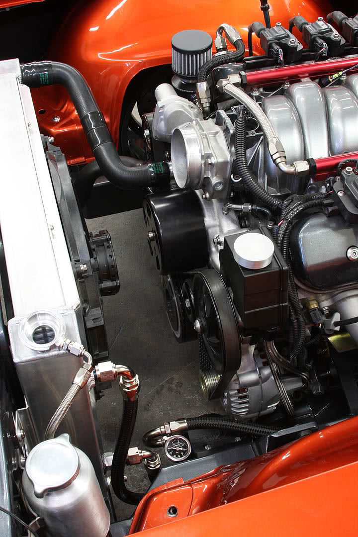

      Ditched the elec water pump for a mechanical one. The electric one was sweet for the street, but I think it hurt on the track since it doesn't increase pumping as the RPM goes up. It never gave me any trouble for over 4,000 miles. Decided to try the new Edelbrock unit since it's supposed to have good flow. I will say it fit just like a factory unit.
      Here's the new AFCO radiator in place with the oil cooler lines attached. Because of the new water pump I now have a TON of clearance between the water pump and the radiator fan.
      Tomorrow she's off to the interior guy, Eric Thornson, to get a little work done. Ship date to Gingerman is the 12th.

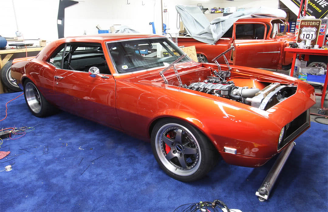

      Finally got the car fired back up and outside (to go to the interior shop for a little "work" - Eric Thornson in Agora Hills, CA)
      This was the first time I could actually stand back and look at the wheels. I must say, I've gotten use to them and really like them now. So much so that I'm sending the WC3s to Forgeline to have the hoops brushed. They I will have zero need for any aluminum polish.
