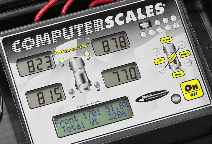

      Two days until we leave for SEMA.
      All the Anvil CF stuff is on the car.. I must say that it fits REALLY good right out of the box. We have a gap between the hood and the front valance, but since these parts are only on the car temporarily we don't want to do modifications that will make putting the steel parts back on later.
      Total weight savings was over 40 lbs.. closer to 50.
      New weight, with 15 gallons of gas, is 3286. So the dry weight is about 3196. For optima the car will be another 16 pounds lighter since the race tires weight quite a bit less than the PS2s.
      Front to rear weight bias is 52/48.. and a little better with a driver.
      Here are all the CF pieces in place and stickered up for optima. Jimi Day asked me to run last years door sticker. I like the GS stripes more than I thought I would.
      Anyways, I drove the car 80 miles home last night so I could do the Speedvision deal today and then I drive it back this afternoon. Everything is A-Ok so far.

      So won't your left rear get heavier with you in it?
