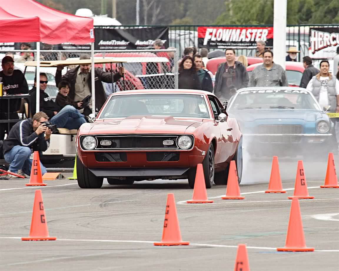

      Burn out for the victory lap..
      Who's that in my smoke??? Could that be Nick Licata???
      Oh, he is SO coming for me....

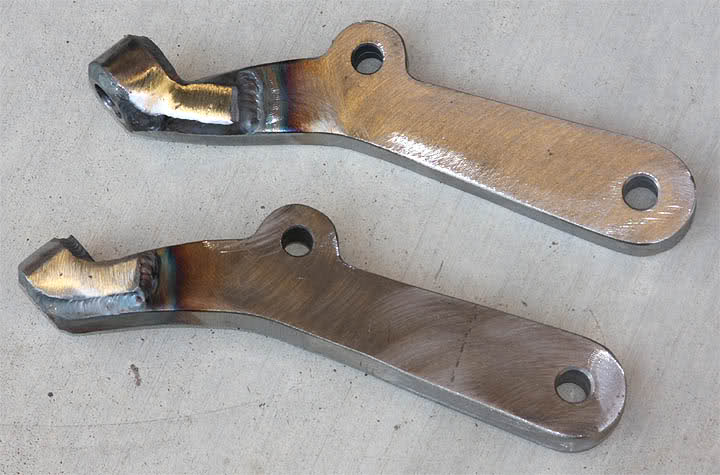

      My new drop steering arms arrived today so that means I can proceed with the front end rebuild.
      These were made by Jim Pettigrew. He's the engineer that designed the 21st Century subframe I'm using. Even though the company is gone he can still make the parts and the frame.
      Anyways, he was nice enough to jig me up a set with the right 1.25" drop.
      Thanks Jim!

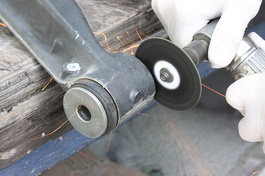

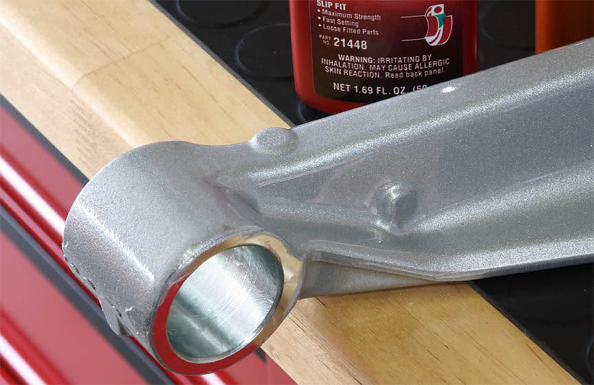

      Time to dig into the front suspension.. first up is rebuilding the control arms..
      Pete over at Competition Specialties hooked me up with a set of C6 control arms so that my car wouldn't have to be down as long. Same geometry, but the lower arms are much nicer than C5 in terms of how they look.
      Getting the bushings out is a PITA though.
      First, cut off one flange.
      Fire in the hole! Easiest (but messy) way is to burn them out.
      I took the time to smooth out all the casting marks on the uppers, clean up the lowers and have them powder coated in silver. This way they will still look aluminum but won't stain and oxidize so easily. Here they are laid out with my parts from Pfadt Racing.

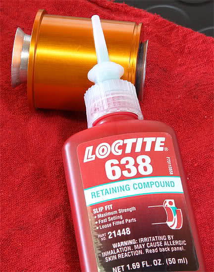

      The key to this project.. Loctite 638. It's expensive but it will secure the bushings in the control arms.
      The 638 is applied to the inner surface of the control arm and to the bushing sleeve. Just be sure not to get it anywhere you don't want it. You have 5-min of working time.
      Then slide in the new bushing, wipe off any excess, and let set. After a few hours I then added the spiral lock to further secure the bushing.
      Wednesday we should be putting all of this new stuff on the car and then getting an alignment. Plan to set camber at -1.5

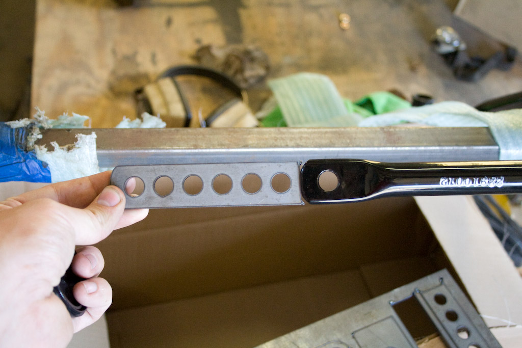

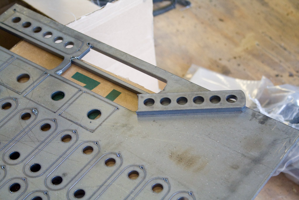

      Thanks for posting all the info about the rear sway bar build. I'm working on a 38 ford pickup for a customer and he wanted a rear sway bar and some other work to the front. I talked to the guys at Hotchkis and found that the first gen Camaro bar is about the only thing narrow enough for this project. So I had a plate laser cut for the extension. This ones lighter in the rear so I'm going to grind the end down to use the original hole but keep my .75" hole to hole length. The guy doesn't know what he wants so this is one more way to give me some leeway when where done.
      (Click to enlarge)
      Anyone who wants the .dxf file to have some cut out near you just ask.
      Thanks again for sharing all this information.

      What necessitated the drop steering arms?
      Mike Kelcy - '68 Camaro with some stuff done to it.
    19. #119
      Jul 2003
      Anaheim Hills, CA
      11,967
      Quote Originally Posted by Mkelcy View Post
      The dropped spindles..
      Since the arms are bolted to the hub area, and the hub area is moved up 1.25" then the arm must move down 1.25" to make up the diff and keep the tie rod parallel with the lower control arm.
