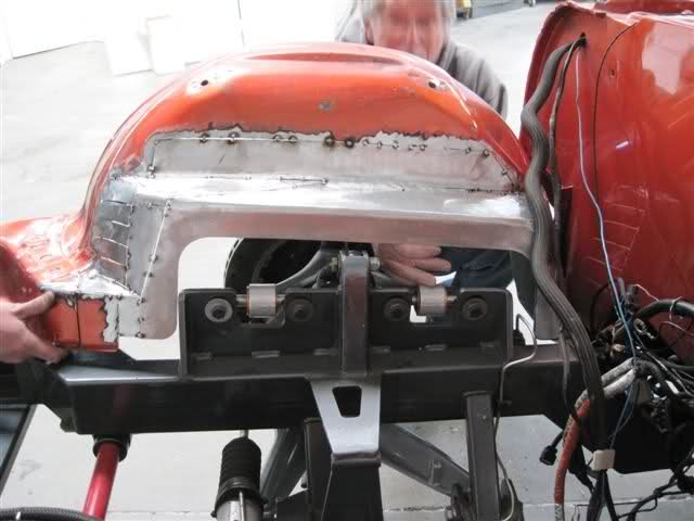

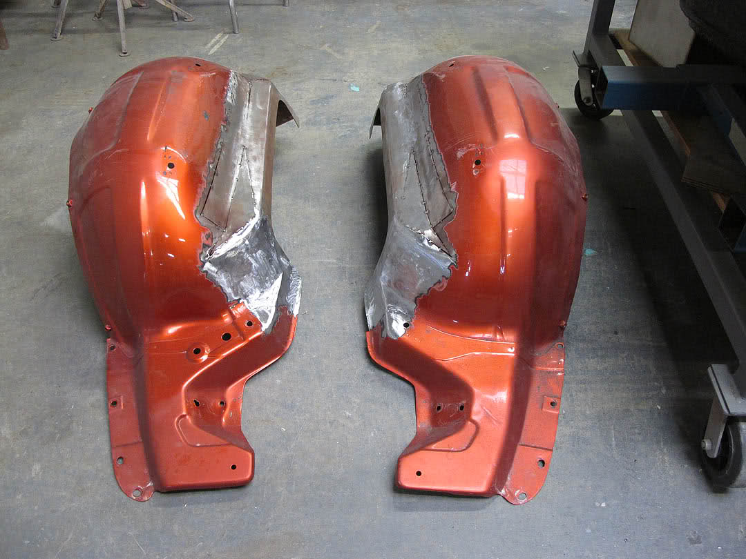

      Got a couple of Best Of Show spy shots today of the new inner fender wells..
      1968 Track Rat Camaro:
    3. #403
      Long Beach, Ca
      1,564
      mmmm, beefy!

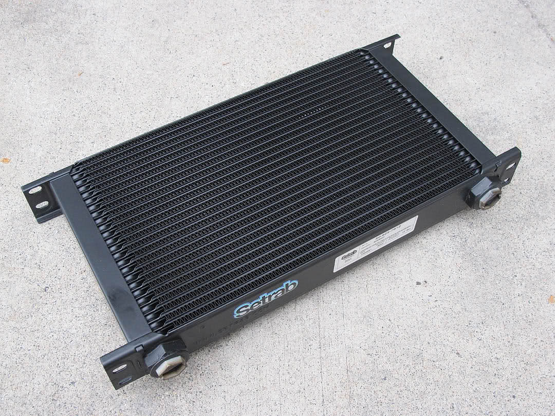

      I have all my oil cooler stuff now. The main player is a Setrab 925 cooler.
      The larger radiator opening will let me mount this without blocking most of the radiator. All the stuff will be hardlined from the Canton t-stat to the cooler and then to the bulkheads.

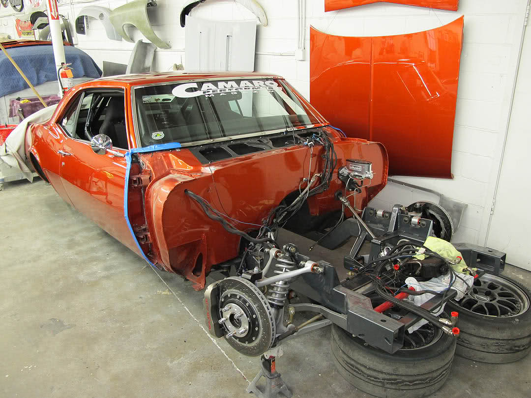

      Funny.. this just started out as a simple project.. lol
      Right now all the old undercoating is being stripped off so the new WURTH Stoneguard can be shot on.
      The rear was gone over by Currie and new ends were welded on. I also had the third member rebuilt since it was out of the car.
      I'm also making progress on the new engine. It's a RHS standard deck race block with 4.155 bore and a 4.25 stroke. The rotating guts will Lunati and the heads will Mast Motorsports LS3 12-degree big bore pieces. I call it a 454+ (the plus is because it's really a 461)
      The inner fenders are now ready to be final welded and then bodyworked. I held them up there and there's TONS more tire space where it's needed. Brad (the Bradenator) at BOS did a great job making my vision a reality on these.

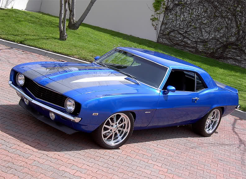

      and too think most people don't remember or know you were known for your sissy blue car........
      Penny just keeps getting better. Nice to see there are a few cars now being tuned to show what PT really means.
      lol.. i still get paint code requests for that car.. even in it's sissy blue color. ;)
      I have too much ADD to have Penny be done.. although after this I'm going to have to dig to figure out what to do next.
      Or you could say that if I was brighter I would have built it right the first time. lol

      1,232
      that "sissy blue car" is what made up my mind when I chose to do the
      LS1 in my 68. that was and still is one of the cleanest engine compartments I have ever seen! where is that car now????
      colt zantop
    16. #416
      Jul 2003
      Anaheim Hills, CA
      11,967
      Quote Originally Posted by colt zantop View Post
      Sequestered away in some guy's garage.. I've seen it maybe twice at local events.
      I had a really nice cloth Recaro interior in it (and that material is EXPENSIVE). The buy had it changed to leather. Made me almost shed a tear since I would have taken the pieced and let him recover stock stuff. Oh well, that's what happens when you sell stuff.
      The car drove real nice with the LS1 and 4L60 trans.

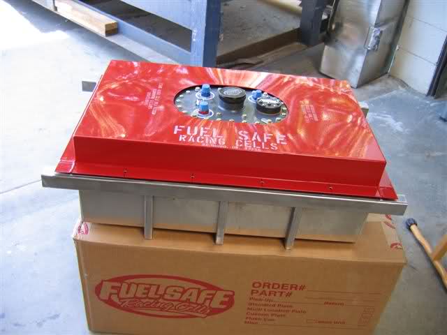

      What fuel tank is this?? Where did it come from
    18. #418
      Jul 2003
      Anaheim Hills, CA
      11,967
      Quote Originally Posted by LowBuckX View Post
      18-gallon FUEL SAFE unit with aluminum can. On a regular Camaro you can go as large as 22-gallons.
      I went with a "hat" design so that the tank wouldn't hang down in back.
