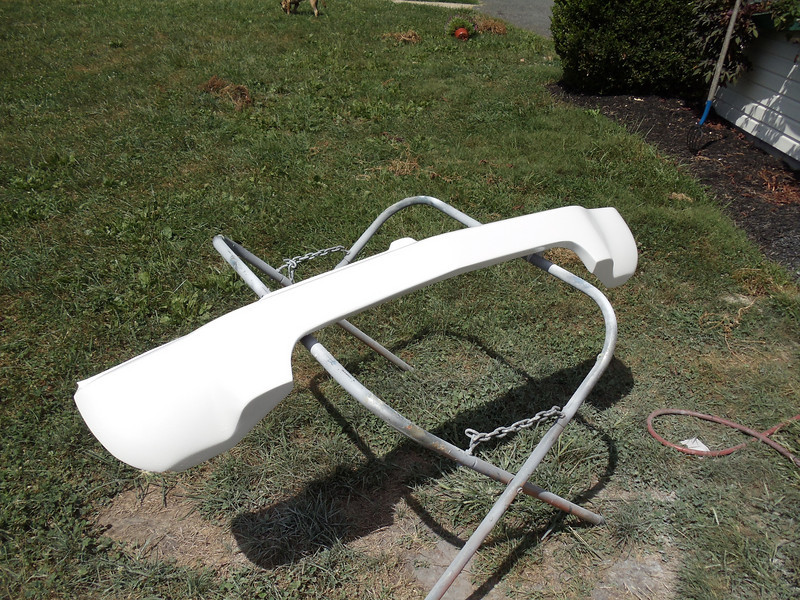

      There will be a FB fin on the edge of the bumper which will bolt it to the fender, I will probably attach something to the strut rods in the center too.

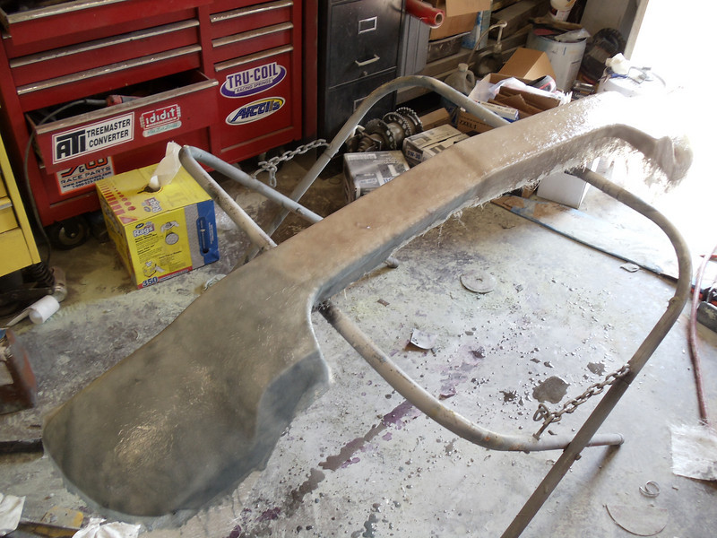

      Hey Ron, The company I work for, makes fiberglass molds for 1 off parts a couple times a week. I don't know what materials you have access to, but we usually use 2 light layers, and 2 heavy for those molds. Just trying to save you some work... 10 layers is a bunch.

      Thanks for info, I've been calling everyone I can think of, trying to get pointers. What to use as a release agent is the thing I've had the most issues with.

      We use a wax release made by Freeman Foundry Supply, I believe they are in Cleveland,OH. Usually 2 or 3 coats, letting each coat dry before applying the next.

      I think you should weld that one up a bit more and paint it LOL! Is there anything you won't try to do Ron? Amazing...
      GM EFI Tuner
    7. #1267
      Jul 2003
      Anaheim Hills, CA
      11,967
      Love the bumper Ron!!
      1968 Track Rat Camaro:
    8. #1268
      7,477
      WOW!
      that front bumper is REAL nice
    9. #1269
      Florida
      2,391
      Bumper design looks REEEEALY good Ron!

      I was at a high-end ski boat manufacturer a few years ago and they said "cooking spray"...??? Since you are going to RTTH, maybe you should make a quick stop at a boat manufacturer and ask some questions. There are quite a few in Tennessee...

      Yeah, I had heard cooking spray as well.. But i am a little reluctant to use something like that. But check the ingredients and see if their is anything that might react adversely.

      Too busy protesting my government Saturday to get anything done, but I did order some release agent from a marina. Hoping it works good, should start laying glass Wed. night. Ron

      Hi Ron, do an internet search for PVA Mold Release. It's what we used when I worked at a Fiberglass manufacturing facility. If you can, add an air fitting somewhere in the center of the mold to blow air in to help release the part. (Like a male quick connect air fitting) When you make the part just fill that hole with some modeling clay or tape if it in an inconspicuous area.

      I'm using an Evercoat product, thats called fiberglass mold release agent, haven't picked it up yet, so I don't know if its a liquid or a paste.
      Didn't like how the top lip was, so I cut it off and reformed it, slowed me down abit. Should have the thing done again tonight.
      Yes I'm putting a splitter on the bottom.

      Got the gelcoat and the first coat of glass on this morning. Waxed the fabricated part multiple times, and sprayed it with PVA mold release, I hope it comes apart.

      Are you sure you have'nt done this before? You don't have near enough resin dripping on the floor. LOL
