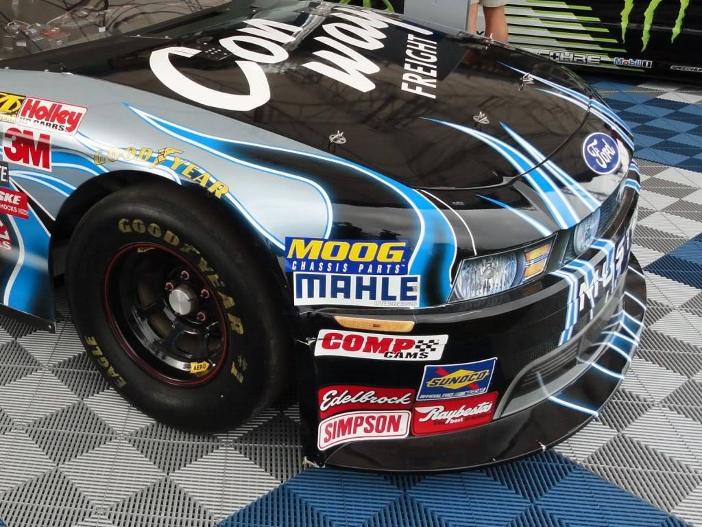

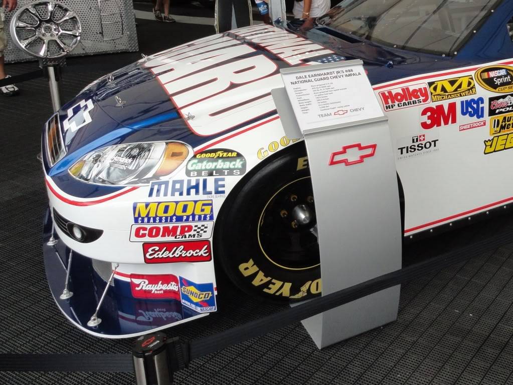

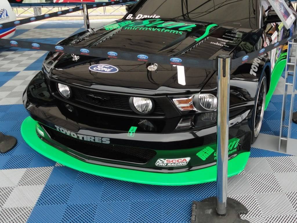

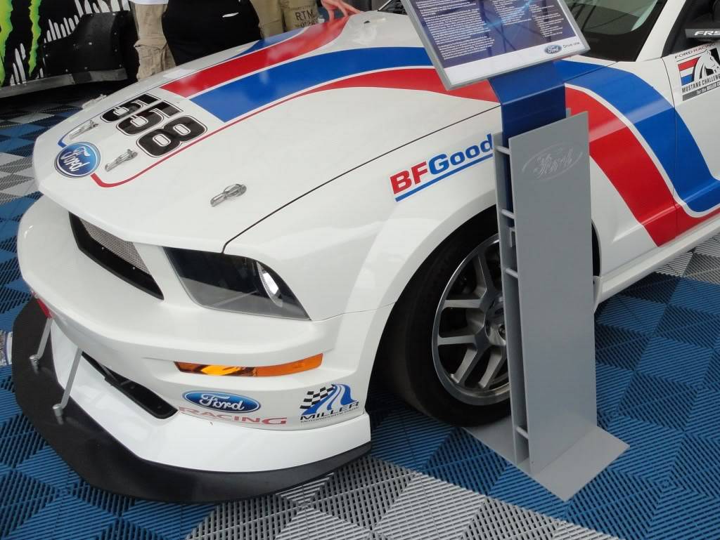

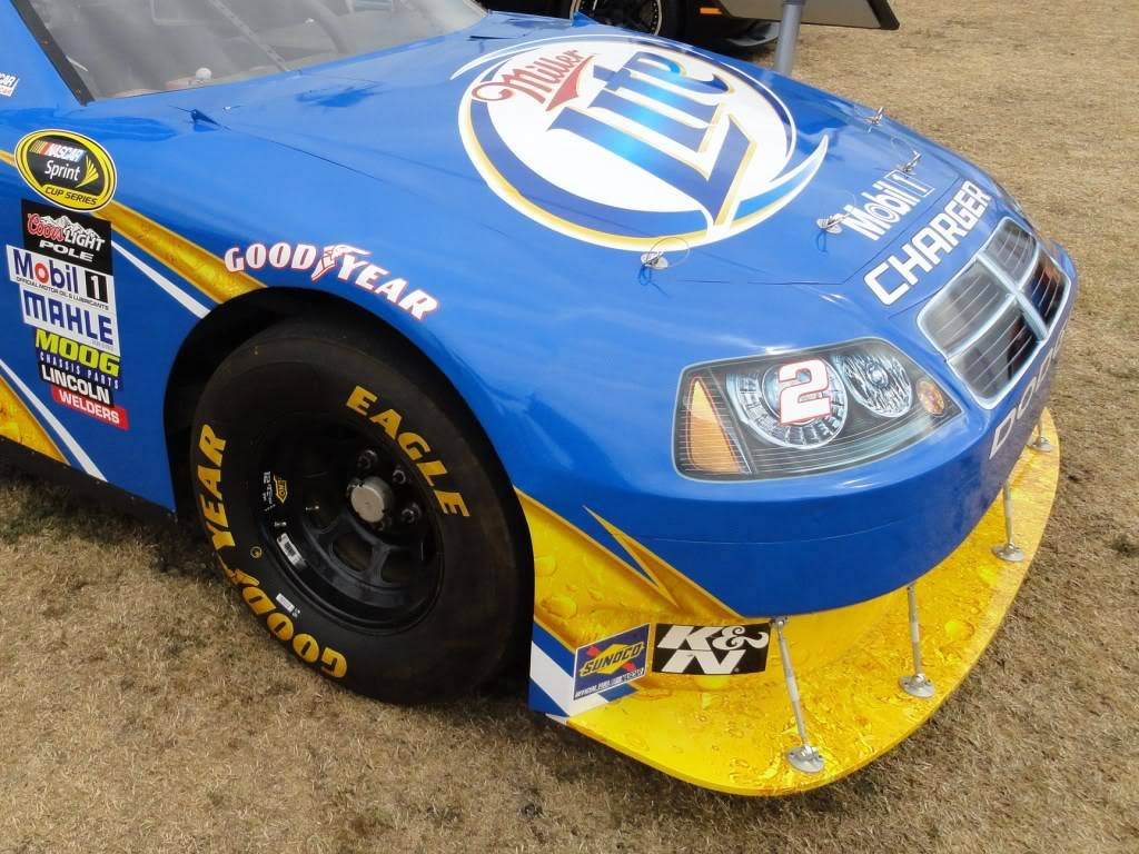

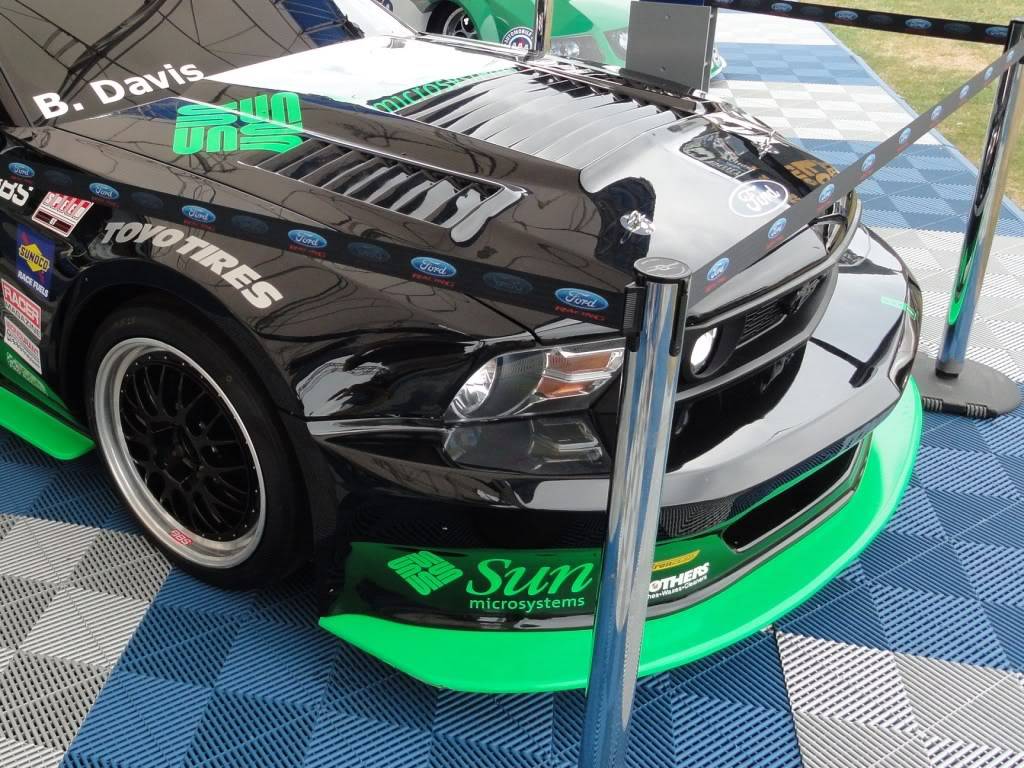

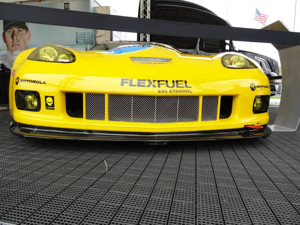

      This latest modification is really going to dress up the front end (and be functional at the same time)! I know you've probably got your design figured out by now but I thought I'd give you a few more examples from my last Nascar trip for "food for thought"...
      As you had mentioned, a number of them have that design of stepping back a few inches at the bottom before the splitter (especially the Sprint Cup Cars). I've read the purpose for the "recessed" area is to enhance the high pressure (above) and low pressure (below) situations going on around the splitter. It would definitely help feed air to the radiators and coolers, "shed" the air to the sides of the car placing some sidebite across the front of the fender areas, and accentuate the low pressure effect below the splitter...
      Here's a few different Mustangs:
      Here's a couple of Nascar cars that have that really pronounced step-back before the splitter:
      And finally, the flat nose of the C6R:
      Just like the rest of the project, whatever you do, I know your final design is going to be awesome and inspiring!!
      Ray
    4. #1204
      Maryland
      1,863

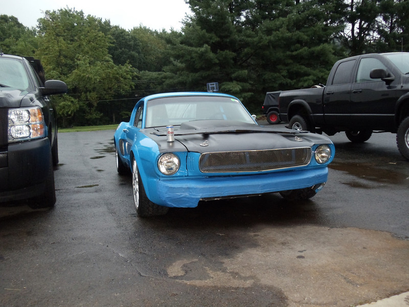

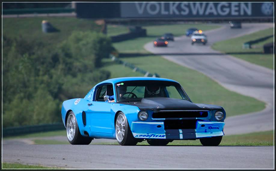

      Thanks Ray, the Nascar step backs are exactly what I have in my head. I will start on it this weekend, I think I will leave the top portion of the bumper plain at first, then try a few things, before I deside what openings to use. Thanks again, Ron

      One thing I hadn't seen mentioned that was the first thing I thought of, the step back also means that you can either fit a longer splitter, or the splitter won't hang out as far from the nose. I've seen a fair number of splitters rammed into parking stops and sidewalks.
      One thing of note on both the designs above, make sure that you carry the recessed area of the bumpers around the sides and transition it as far out as your eye and stomach will allow, you really don't want that air coming around the nose to ram into your tires, it'll cool the tires, increase the air inside the wheel well which creates lift and create a LOT of turbulence down the side of the car.

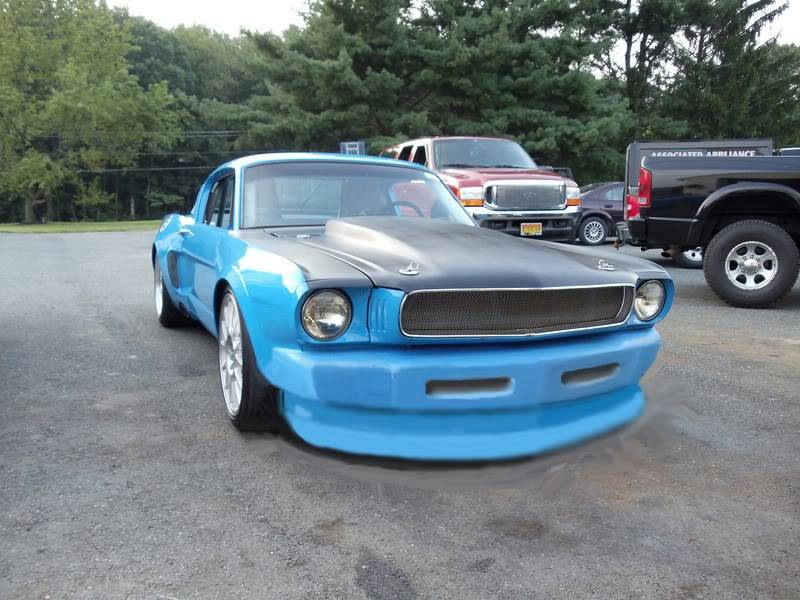

      I saw John's post and thought I'd try a little photoshop on it,,,, hope it works for you bud.

      I've always loved the GT350 nose. I think if the nose would have fit better, I wouldn't be changing it now. But the design I'm working on now will incororate the struts and lots of little accents. The aero will be alot better and I'm liking the look so far, I'll post a few pics as soon as I finish grinding the welds.

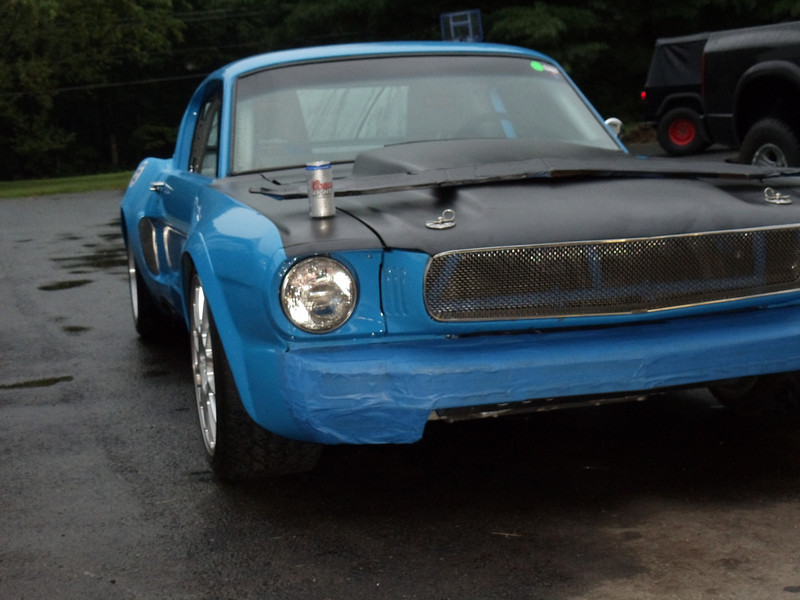

      Maryland
      1,863
      My mind keeps changing like this, I'm going to have to grow a vigina. Got the top of the bumper built, but I think I'm going to change the ends and put the splitter in the across the bottom, something like this.
