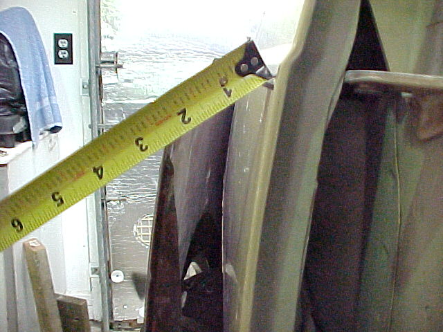

      I also did some template making for the widebody fender mod. Laid the shape of the fender onto a piece of foam core and cut it out with a razor knife.
      This piece narrows drastically as it goes toward the front. As it narrows it also creates a wedge effect in the flare from front to back.
      I like that wedge and will play it up as I develope the filler piece.
      I am looking at shape and angles here. I am thinking I will drop the outer edge another inch. I like the shape as it tapers toward the front so I will take some more off the top of the fender to get it where it needs to be.
      I also worked on the lower "dogleg" as it rolls in toward the old fender flare. Ran it back through the stretcher to lessen the curl and get it to better match the shape of the existing flare.
