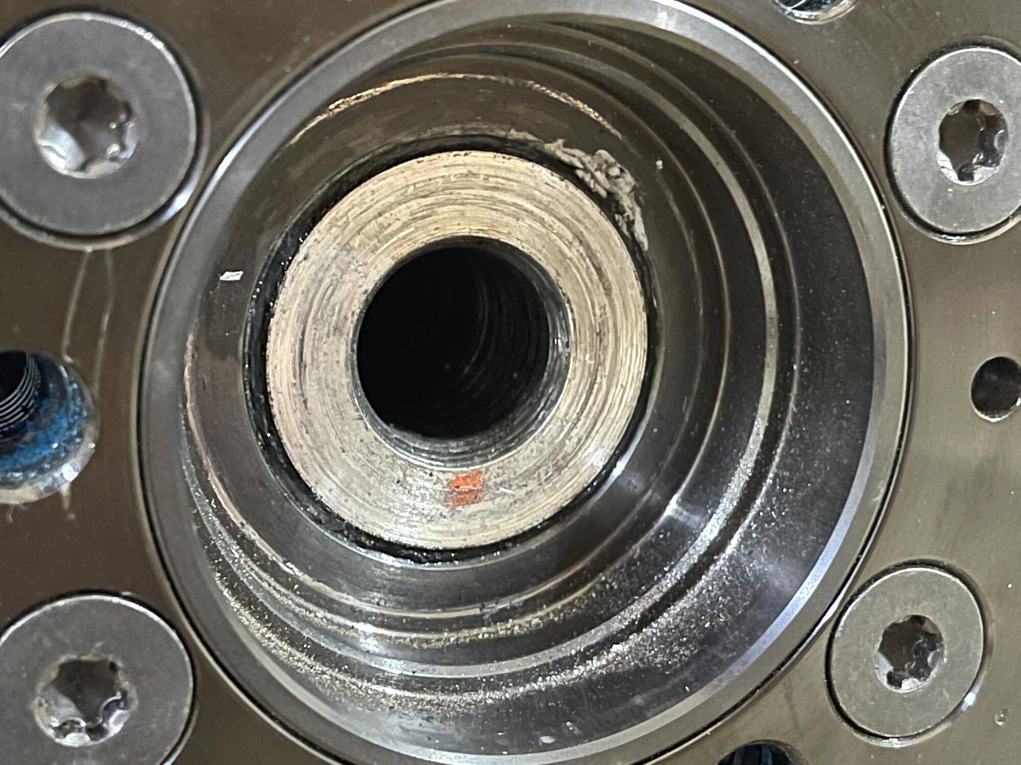

      Here's the crank and the balancer hub. Yes, they're flush.
      1973 Camaro: LS427/570, T56, Speedtech ExtReme subframe/torque arm
      Red Deer, Alberta, Canada
      1,364
      Something is definitely up, I would now say the larger diameter is the sealing surface. The balancer cannot go on any further as its flush where the washer sits.
      Matt
      Instagram: Cst_koon
      Oct 2007
      1,872
      IS thier any referance or can anyone measure for the OP the distance form the back of the balancer to a reference point? Maybe the timing cover?
      Also it looks like the creank snout is flush with the balancer so it cant go further. The bolt would hit the snout.

      I just did this on a LS7 570 crate. I installed a Holley mid mount with the ATI damper. The Holley, nor ATI instructions have any info for the spacer used on the dry sump crank and extended timing cover on the LS7. After talking with ATI, providing dimensions, etc, they basically told me with the GM crank spacer, the damper is moved out to the seal the same as an LS3, so a LS3 damper, as well as accessory drive kit, is what is required. Holley has updated the mid mount info on the website to reflect this.
      My crank hub looks pretty much like yours. The crank was recessed a couple hundred in the ATI hub. ATI confirmed this is correct.

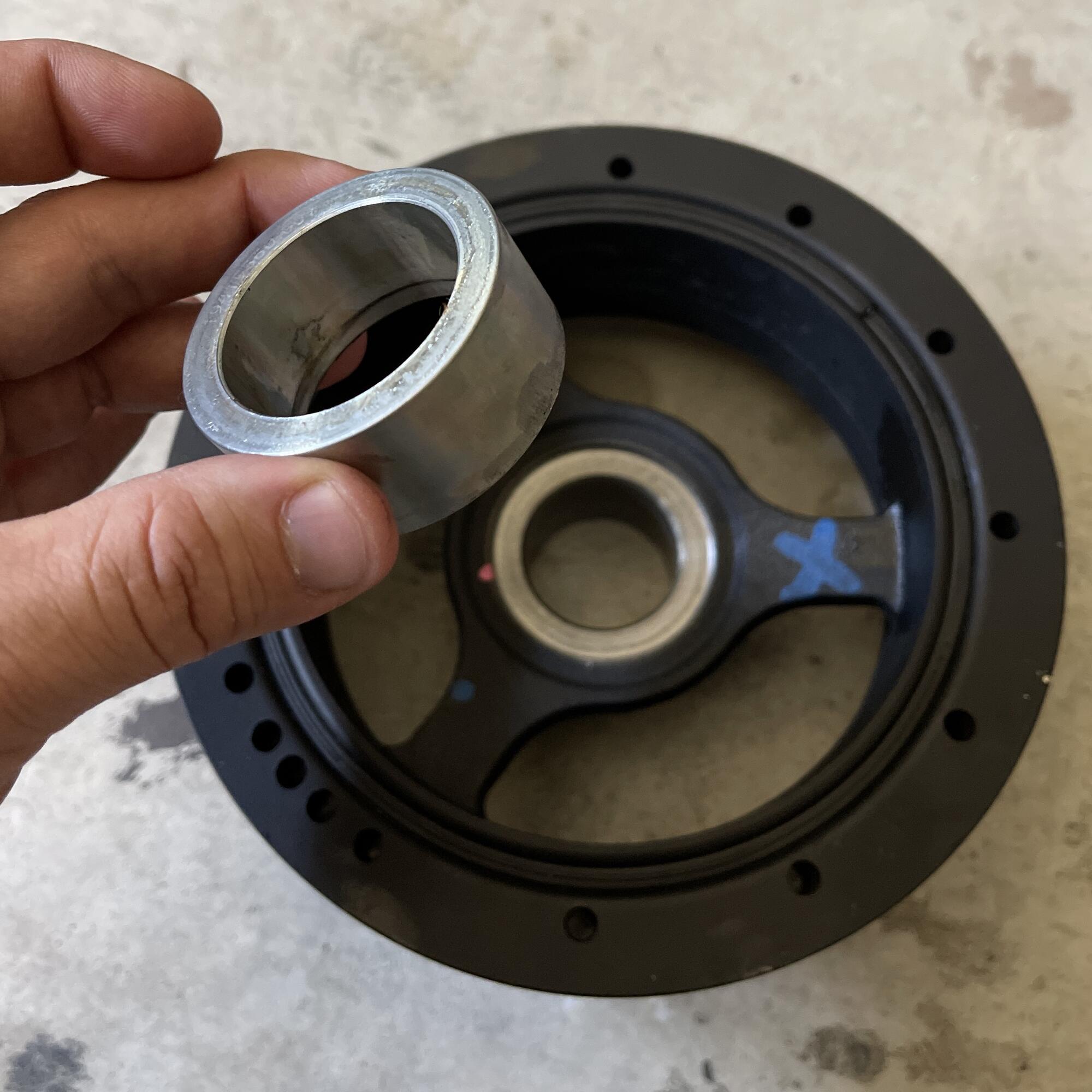

      Jun 2018
      Alamo, CA USA
      235
      Spoke with ATI about the issue and showed them all the pics that you guys saw here. They said there basically shouldn't be an issue, that I have all the right parts, offered zero solutions, and said it was Wegner's problem, which didn't make sense since their accessory drive has nothing to do with how the damper sits. It was a disappointing call, to say the least.
      I called Wegner and they said since the LS427 is nearly the same LS7 converted to wet sump, that is probably uses the same spacer that Scoggin-Dickey uses on the crank. I went back to the stock damper and, sure enough, there was a spacer attached to it that wouldn't simply fall off. It's a .88” spacer. Pulley was about that much off. If I use that spacer in front of the damper, it should seat it properly. Here's a pic of it.
