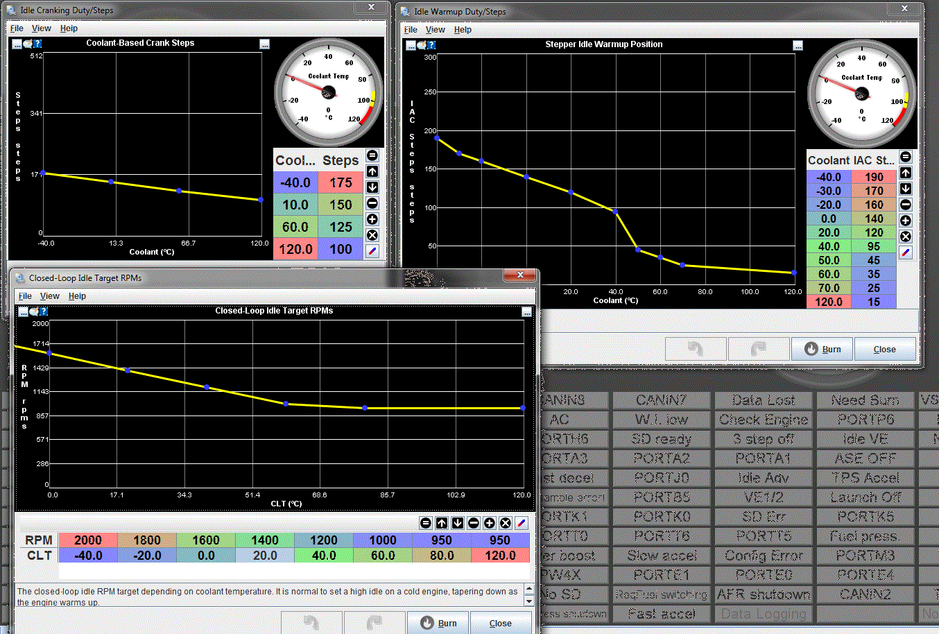

      Hey guys ! finally the car is running perfectly sequential fuel injection and COP ignition, I share my settings, it works incredibly well for E85 without knocking ( base intial timing is 10 and 32 total for standard gasoline ) and I will auto tune the VE table this WE feel free to ask me some questions
      MS3-Pro EVO is really a good ECU and customer service is perfect !
      next step will be how to fine tune for running flex fuel with table bleeding and switching, over-run fuel cut settings, kncok sensor settings...Etc
      and last big buy soon, the Speedtech chicane full floater axle with their torque arm sway bar and a 3-piece hollow sway bar for the front end
      about the AFR table, it's seems a bit rich above 105kpa but there is a difference of 0.5to 1 point AFR between the target AFR and the true AFR, so I've set it as shown to achieve about 12-12.5 AFR, the boost with 5 psi springs go up to about 7 psi springs ( 150 kpa )

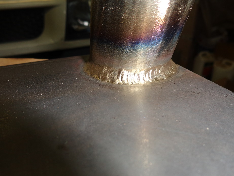

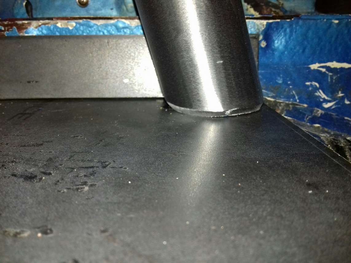

    20. #100
      Oct 2016
      589
      this is 45 x 2.5mm ( about 1-3/4x 0.1" ) 4130 chromoly tubing, first welding at 70 amp, 2nd welding at 80 amp
