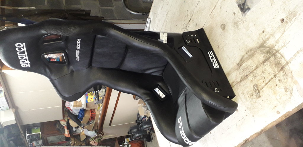

      Finally on her wheels ! From ground to top of the roof about 49" height, compared to pro-touring car in USA is it about the same ride height ?
      Sparco seat installed, rear 3 point seat belts OK, just need to install 4 point harness and the other seat and run !
