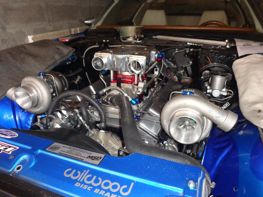

      need to remove the intake manifold and modify all cylinder head intake ports and clean them, fuel line almost finished, next step will be the exhaust line
      Oct 2016
      587
      Installation of the Banks kit finished ! next step exhaust line, passenger side it will be easy, driver side I have 3.1" space for a 3" axhaust diameter because of the clutch linkage, it will be fun !
      that bottle is exactly 3" diameter
      Oct 2016
      587
      how the kit should be without intercoolers
      exhaust line finished LOL

      awaiting for the exhaust line, I've finished several things, a bracket to hold the MAP sensor, an other to hold the turbo feed line not to touch the exhaust line, flex fuel connector and coil brackets received, I think I will be able to put them on the valve cover, I will have to build a weird exhaust line on driver side but it should let enought room for the coils.
      front end heighten about 1/2" to be at the same height as rear end and because the oil pan is a bit lower than the motor crossmember, 25.6" from ground to inner fender, if french roads were not full of speed bumpers, the car would be 1" lower....

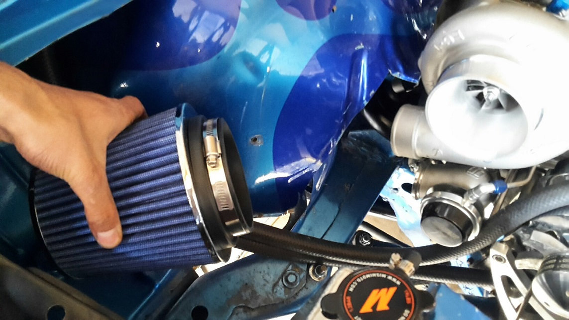

      Finallly the coils will be on the front of the inner fender, I've ordered Granatelli coils and custom length 0 ohm spark plug wires and I've decided to relocate the battery in the trunk so I will be able to put the air filters far from heat, with simple items found in a home depot, I've made an air duct integrated in the front spoiler, and cut the passenger side inner fender to let some room for the intercooler pipe, still some work to make it clean but it will look good when it will be finished.

      air ducts finished !

      exhaust line almost finished, at the same level as the torque arm, higher than the subframe connectors. the lowest thing is the oil pan, about 3.1" high from ground with that ride height. I think I will ba able to lower the car about 1/2 inch.
      just seen that we don't need mini tubs to fit up to 325-335 tires, on the red circle, we just need to cut about 4 inch long, the rest of the chassis is about 1.6" further than the tire, my tires are 285 wide.
