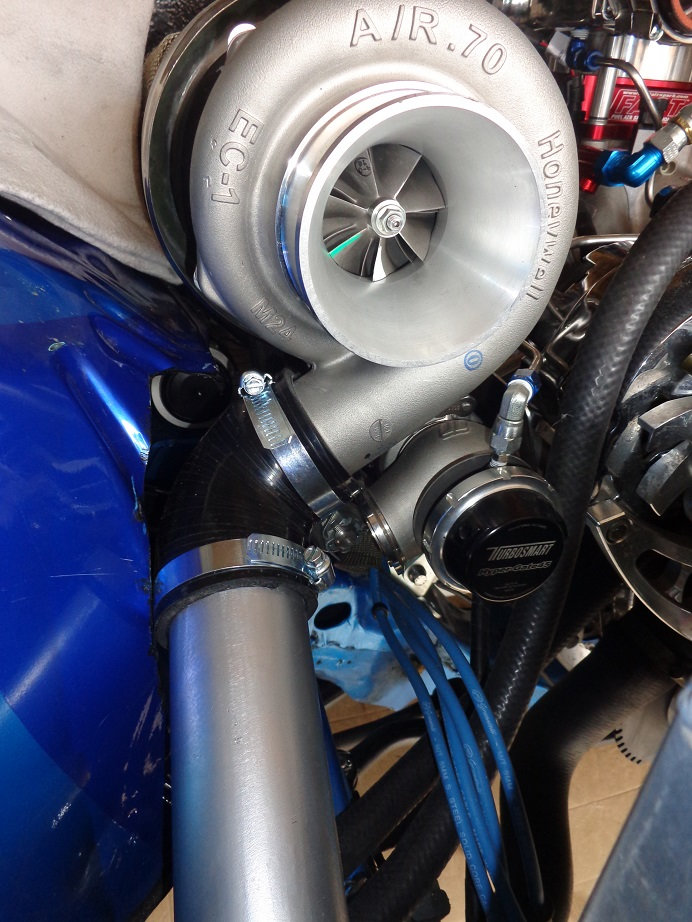

      intercooler pipes finiished, I don't really like 90° silicone bends cause it kills airflow but no choice this time. Finally I will be able to order all electronic parts.

      finally I've decided to re-built the 2 intercooler pipes from the turbos to the intercooler with 90° SS tubes on both side, I really don't like to have a bad airflow with 90° silicone bends, it will be smoother now.

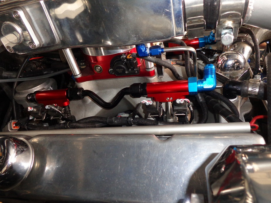

      finnally received the Plug and Play LS harness from DIYautotune and Innovate DLG1 dual wideband O2 sensors, next step : modify and install the harness on my SBC gen 1 and next month the MS3-Pro EVO ECU, coils and injectors

      allmost finished ! I believed it would be more difficult but finally it was pretty easy to modify the harness.
      to adapt the DIYautotune LS plug and play harness on a SBC we have to :
      relocate some connectors but no need to cut any wires.
      swap the "C" and "G" spark / injector outputs, and swap the "D" and "H" spark / injector outputs because of the different firing order and directly swap them on the ECU connectors.
      Connect both grounds of the DLG-1 gauge and LC2 controller to the power ground on the 6 pin connector included in the harness
      remove the alternator wire; it is intended for later alternators and not used with the one wire sort.
      remove the starter connector and connect the starter wire to the tab marked "To Ignition Switch" on the starter solenoid
      remove and replace the crankshaft connector cause the holley connector was not the same, lenghten the wires.
      connect the flex fuel sensor connector to the digital switched in 1/flex, switeched 12v and sensor ground
      starter wire ( body connection ) to S-terminal on a ford remote starter solenoid
      and prepare all connexions for battery +/-, fuel pump, tach output and switched 12v
      DIYautotune harness is really very good quality !
