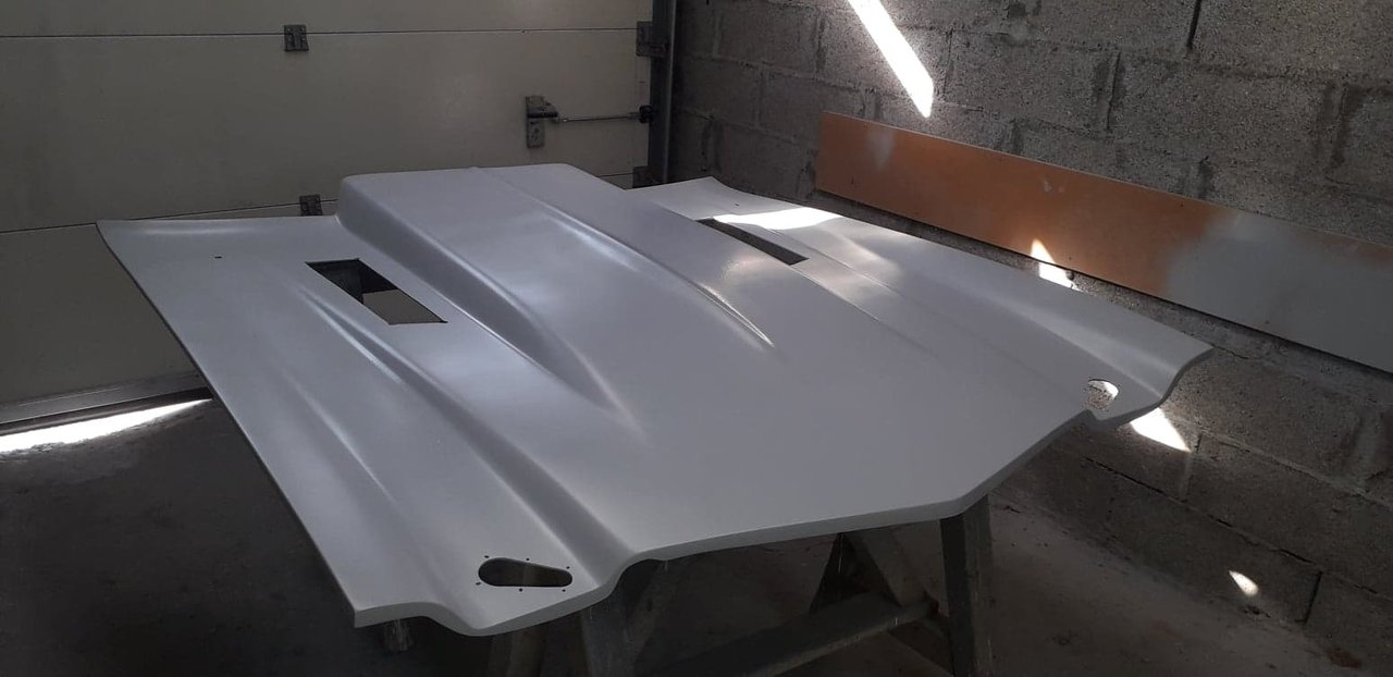

      everything ready for painting next week exept the Hood that I need to work on it again because of 1 line not beautiful
      good
      bad

      A question please about the hood : when I drew the lines and took measurments, i ve seen that the cowl induction is not centered from 5mm, is it normal or just a bad quality fiberglass hood ?

      I'd say if it's fiberglass it's probably just a variance. You could probably measure all fiberglass hoods and get different measurements. 5mm I don't think anyone would ever know. For the black yes I would put a clear over them. Much easier to maintain that way

      better now, tomorrow 400 and 600 wet sanding, finish the air ducts and go to painting. Next week I'll receive my new wheels and I'll change the return line from -6 to -8an to have a fuel line supporting up too 1300-1400hp with the 2 535lph walbro fuel pumps.

      hood finally finished ! and I'll receive the wheels probably tuesday next week
