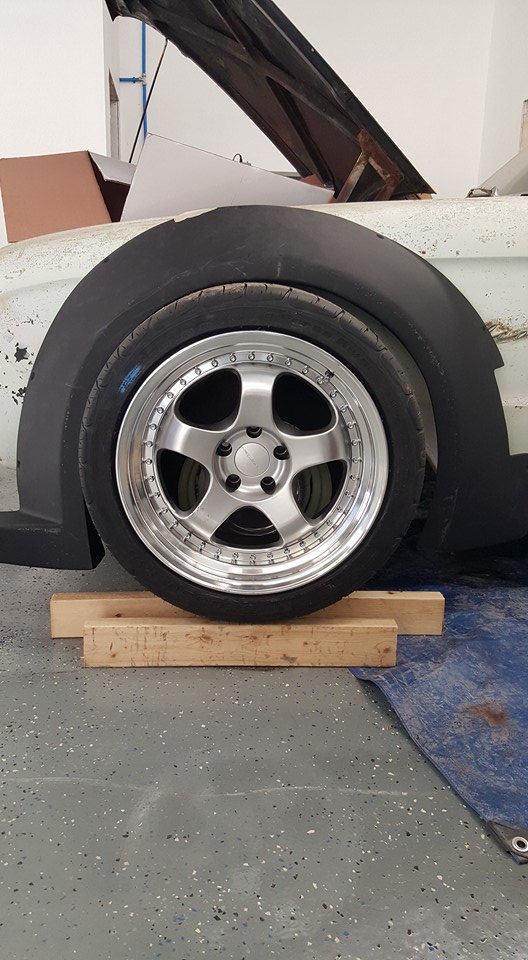

      This was a (failed) experiment for JDM Style flares. I liked the look, but the dimensions didn't work. I'll eventually attempt making my own steel flares but I'm a long way off from needing to take that step.
      Name:  Fiberglass Flares.jpg
      I'm now hip-deep into the deconstruction phase. It's amazing how much "fight" 55 year old bolts and screws put up. I've been using more drills and grinders than wrenches. It took me a fricking hour and a half to get the passenger door off. I sweated, cussed, and bled.
