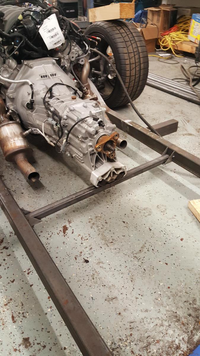

      The transmission mount was much easier to fabricate than I thought it would be.

    18. #118
      Texan Back in Texas!
      675
      Simple is usually the best solution. One question though,or something to consider. With how you have it in a saddle would you be able to take it off once the body/floor is on if you ever need to drop the transmission?
      1965 Falcon Hardtop

      Quote Originally Posted by LowFast View Post
      I was thinking the same thing.

      Quote Originally Posted by Jetfixr320 View Post
      To be determined. I think so. may have to adjust my design.
