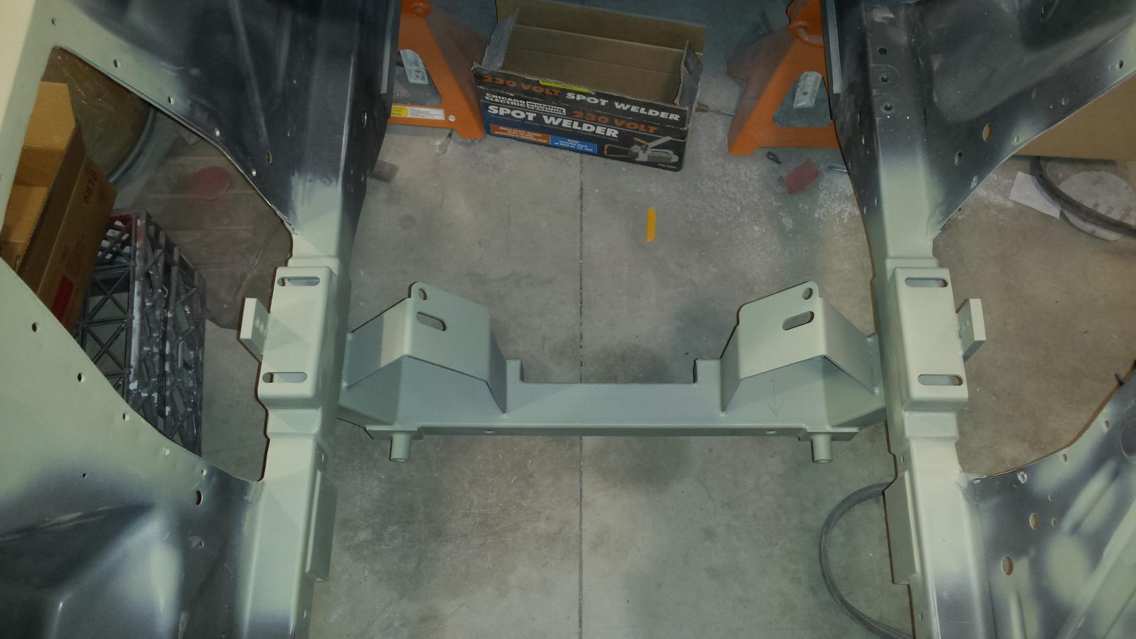

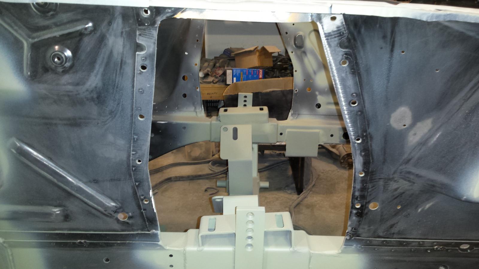

      Haven't posted any updates lately, but all of the sheet metal is finished with some body work left. Body work is done on front frame rails and IFS coyote crossmember (first coat of primer). Hydroboost and pedals mocked up! Taking a break for a few weeks, will post more when I get back to business.

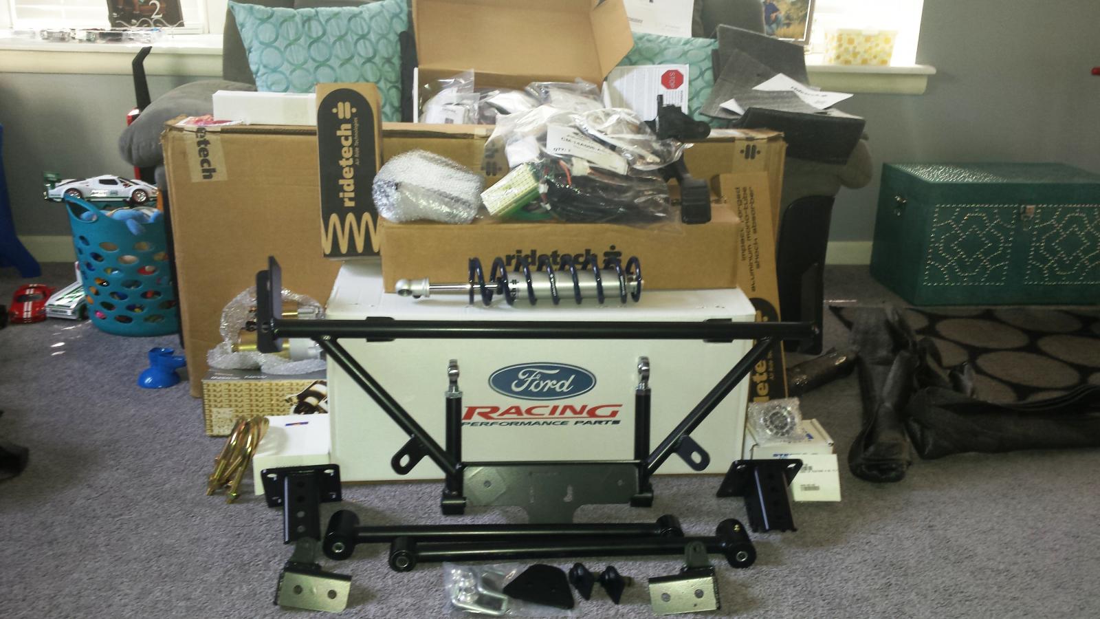

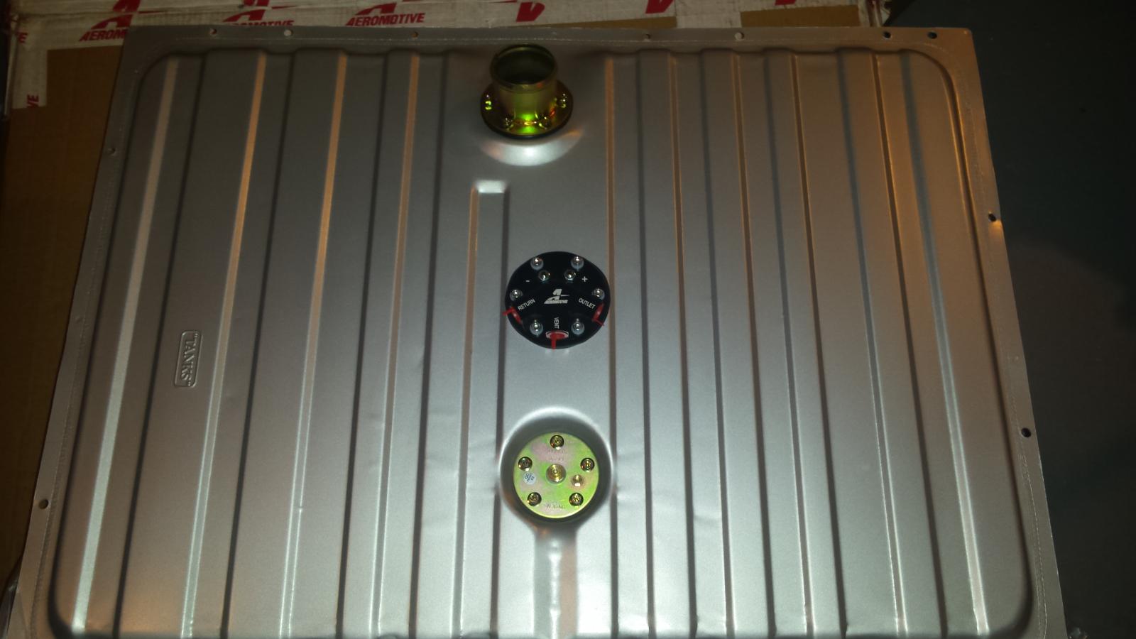

      My wife surprised me with this nice package sitting in the living room one day last week (ridetech 4-link, coyote control pack, pulleys, AAW wiring kit, Aeromotive stealth tank, etc..). I thought it was a "thank you" for sacrificing many parts for cash towards our summer vacation. She said its any early Anniversary gift!! What a wife....

      Quote Originally Posted by xavier296 View Post
      Plan to run powersteering or A/C with the supercharger? i havent figured out how to do that on my coyote.
      I'm running both on mine. Major PITA.
      This build is sweet. Looking forward to seeing more
      Aug 2012
      Pennsylvania
      252
      Thanks Geoff, but boy is that TechnoStang of yours lots of inspiration!!
      Ca
      134
      Sound like a vacation to me.
      Quote Originally Posted by migg400 View Post
      There is nothing like new parts. That tank is awesome. I am doing the Phantom conversion on my Duster.

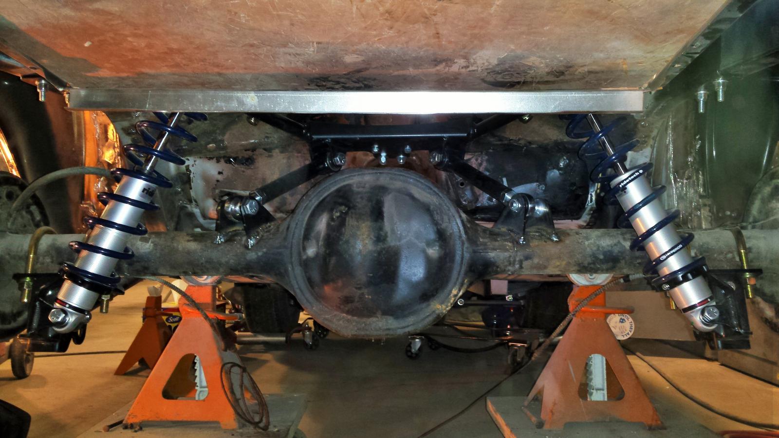

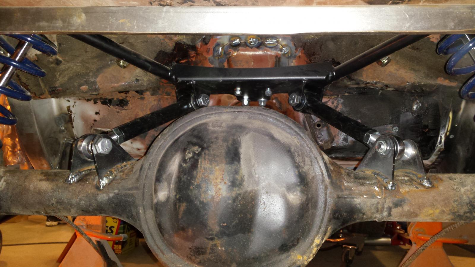

      Finally got the 4-link installed (temporarily). Now its time to add the disc brakes and some paint on the rear!

      looks awesome! can't wait to see how this comes along. So happy to see someone doing a coyote swap, let alone a blown coyote swap into a mustang, instead of opting for the easy route and putting in an LS
      Houston, TX
      1,197
      Cool project. Are you installing minitubs? if so, did you narrow the frame rails and modify the ridetech bracket? Does not look like the ridetech bracket had been modified though.
      I'm working on a 65 Fastback with DSE minitubs, and Ridetech rear.
