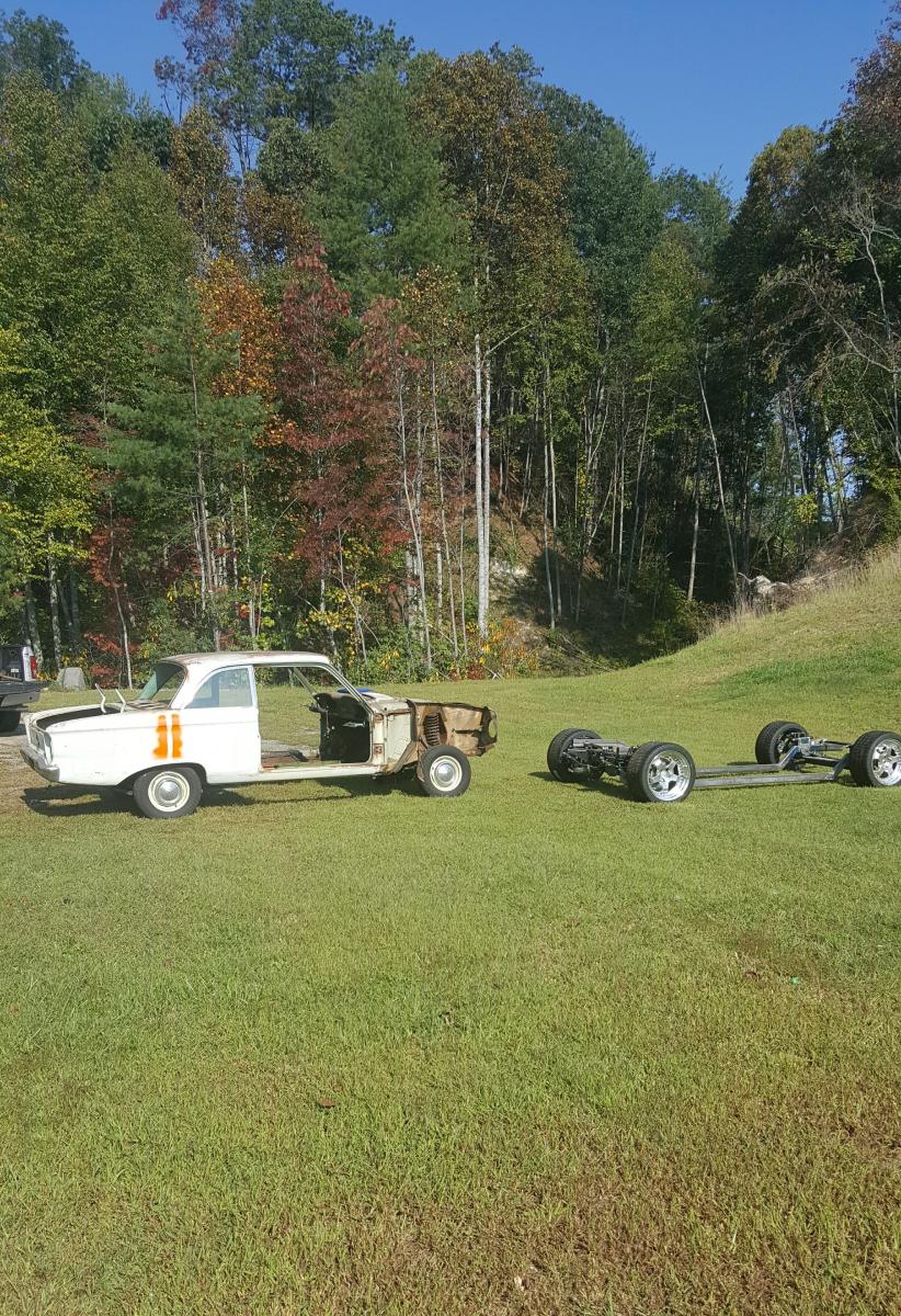

      I had to move the body and chassis out into the yard to make room for a 2-post lift install. I anticipate the body, once fully gutted, coming on and off the chassis a few times. It will be easier to finish weld the roll cage and paint it with the body off. Since I am doing most all of this alone, a lift became necessary. I just thought this was a neat picture.
      Name:  body & chassis.jpg
