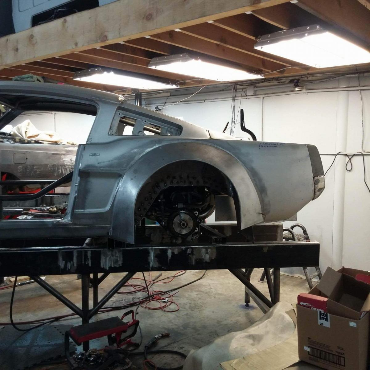

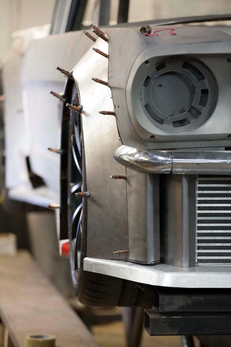

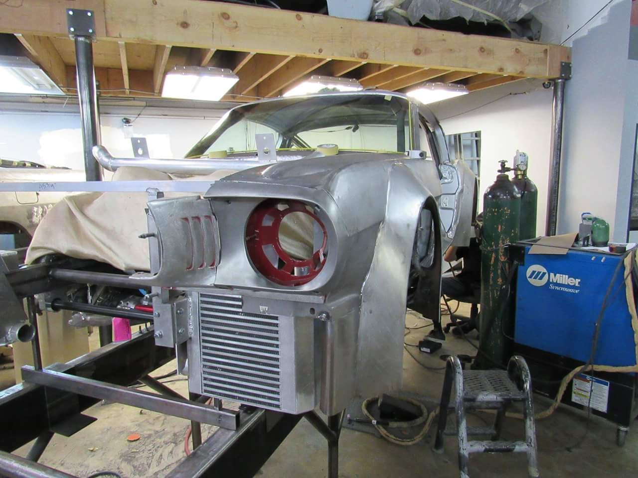

      I found this project on Facebook. Because of my project, I was focused on the flares. They sure make it look easy. It's not, but I'm encouraged none the less.
      Name:  Stang Flares 1.jpg
Size:  111.9 KBName:  Stang Flares 2.jpg
Size:  78.6 KBName:  Stang Flares 3.jpg
Size:  83.4 KBName:  Stang Flares 4.jpg

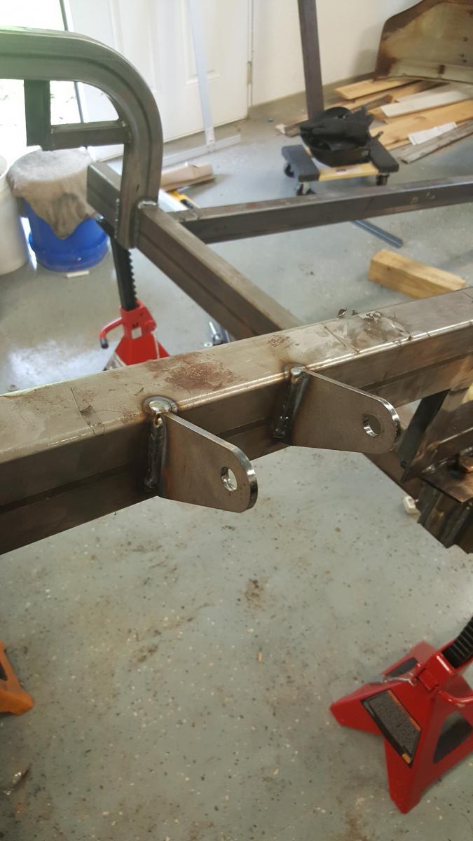

      The front mounts for the sub-frame I found to be a bit more complicated. Using scrap pieces of 2x2 square tube, angle iron, 1/4" plate I was able to get it mounted. Not having a frame table slowed the process down considerably, as I had to move the sub-frame in various directions several times to get it squared to the chassis. I'll probably add more gussets and cross braces. I obviously don't want the sub-frame moving around. I'm more concerned with lateral movement, as I anticipate tremendous side loading. If y'all see anything I should add or that I missed, please comment.
      Name:  Front mount.jpg
      Name:  Front mount 4.jpg
      Name:  Front mount 2.jpg
      Name:  front mount 3.jpg

      That's an awesome Mustang, whos building it? There are some pretty good tutorials out there on fender flare making. Look up on FB or IG "Cut Worm Specialties".
      89 Mustang "Box Wine"
      May 2015
      Green Mountain, NC
      104
      Timeless Kustoms in Camarillo, California. Thanks for the tip.

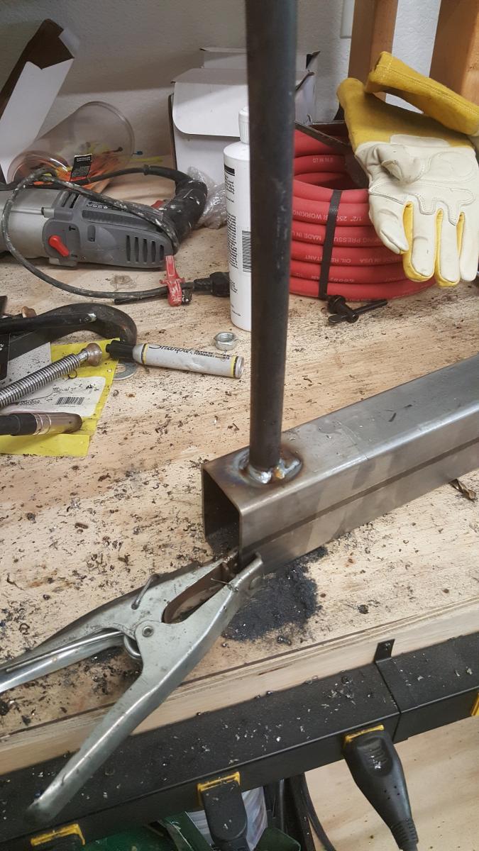

      Next on the list was the upper shock mounts for the IRS
      Name:  Shock mount 1.jpg
Size:  78.3 KBName:  Shock mount 2.jpg

      The Cortex Racing 66 mustang got some pretty serious flares too-
      http://www.hotrod.com/articles/1207p...-ford-mustang/
      1966 Plymouth Fury III
      May 2011
      Brisbane, Australia
      453
      Country Flag: Australia
      And a Cougar they did, but not as extreme-

      I am really torn as far as attempting to fabricate the flares myself, or outsource them to a reputable fabricator. I'm confident making floorpans, etc. but "fine" metal work like scoops and flares is another topic entirely. My single biggest issue is that fenders and quarter panels for this year/model are really difficult and expensive to find, and there are no reproduction pieces. If this was a Fox Mustang (example) I would dive straight in because a failed first or second attempt could be scrapped without a huge hit to the overall build budget. Regardless, I'm still 4-6 months away from making the decision.

      Question, why not just "hard mount" the sub frame without the rubber bushings, effectively isn't that what the bracing is doing?
      1965 Falcon Hardtop
      May 2015
      Green Mountain, NC
      104
      Quote Originally Posted by LowFast View Post
      My issue/concern was getting the sub-frame perfectly square, side to side and front to back. I'm confident that it's with a 1/4 to 1/8 of an inch now, but that's enough to cause the car to "dog-track" or be unpredictable in turns. My original plan was to weld the sub-frame in, but I do not have a frame table. I tried plumb-bobs too, but I couldn't find a "uniform" place to hang them from. So I figured that until I get it to a four-wheel alignment rack, I better have a way to adjust it. Please note that the rear suspension itself is not adjustable, so I opted to adjust the whole assembly. Did I over-think and over-engineer this? Possibly. I've been guilty of that more than once.

      On the flares just remember if you can make it out of cardboard you can make it out of steel. It'll just take some thinking and laying out.
      May 2015
      Green Mountain, NC
      104
      I am confident I can do some rat-rod style flares, but I've never done "fine" metal work. I am willing to try and learn, but body parts for this car are hard to come by and expensive when you find them. My thoughts are; If I screw up I have to drop several hundred dollars after searching for a replacement part. The way I see it, the flares are going to be the first and most notable aspect of the car that people will notice. If they look like crap, it doesn't matter how nice the rest of the car is. IMO.
