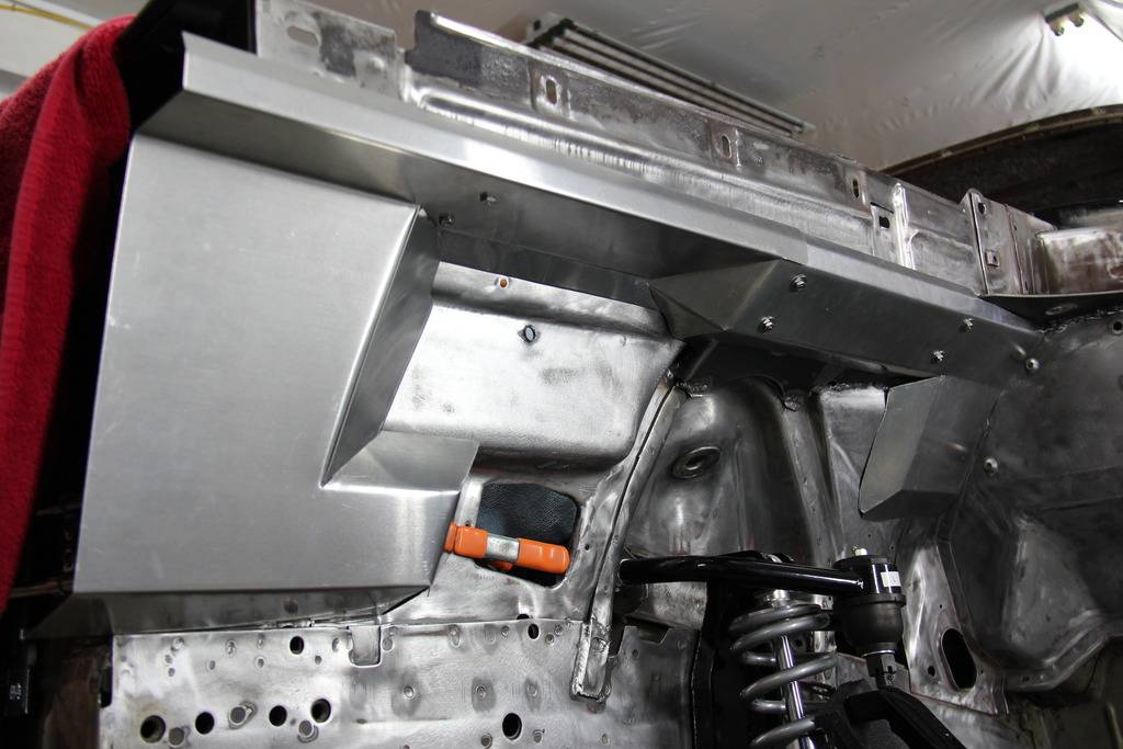

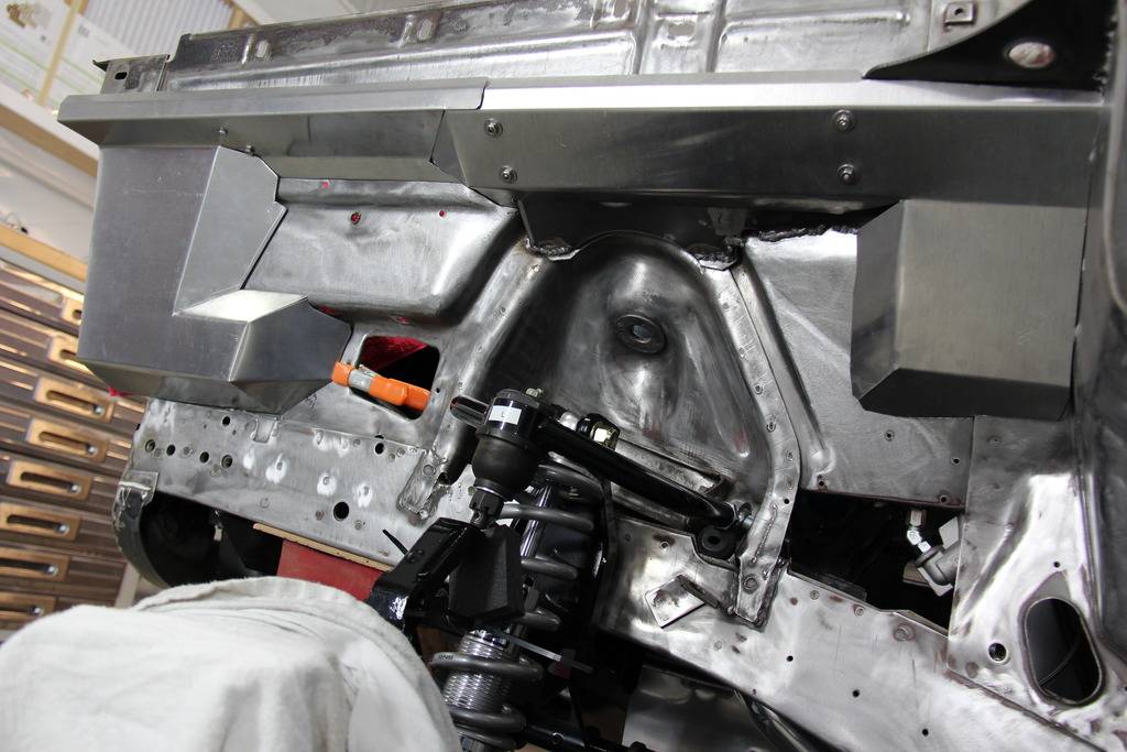

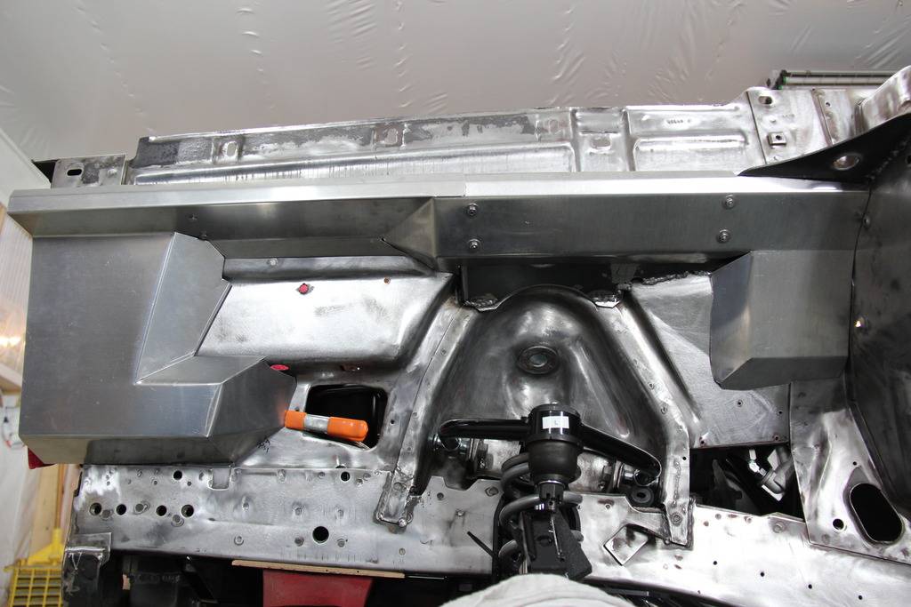

      Welded the seams on the inner fender covers, coated them with bed liner and installed a rubber gasket I got from McMaster Carr. Now they should keep most of the water and dirt out.
      Thanks
      Pat
    12. #352
      5,560
      That looks like a nice solution.
    13. #353
      Sep 2013
      sw Kansas
      1,662
      Which bed liner are you using?
      Looking good.
      Looking good.
      Dupli-Color Bed Armor easy to use!

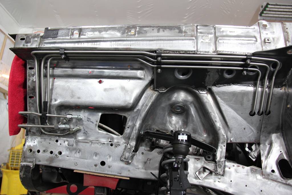

      I bent the right front brake line to run along the seam between the firewall and floor. This is much cleaner than the original run in the middle of the firewall.
      Thanks
      Pat
    20. #360
      5,560
      That's tucked away nicely. It looks good.
