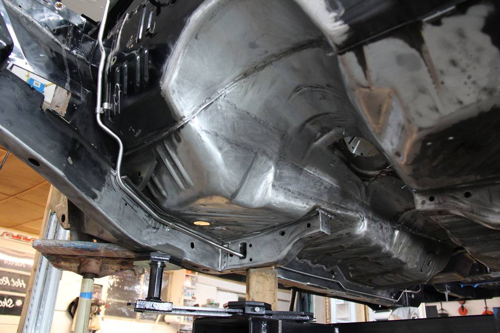

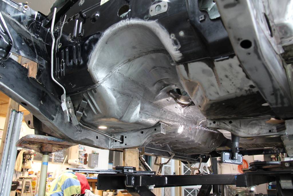

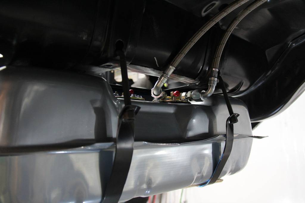

      I needed to make a large fuel pass-through in the trans cross member as there will be two ½” fuel lines. I used part of the rear frame rail I cut off last winter to make the reinforcement for the hole I put in the cross member. Now I can bend full length fuel line to fit.
      Thanks
      Pat

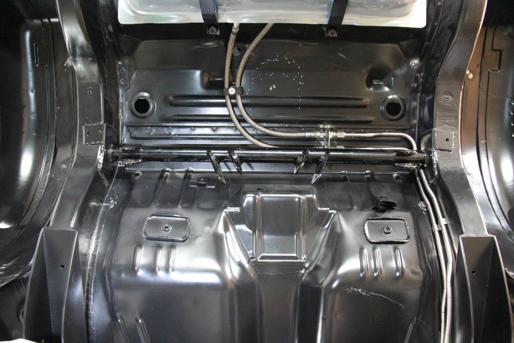

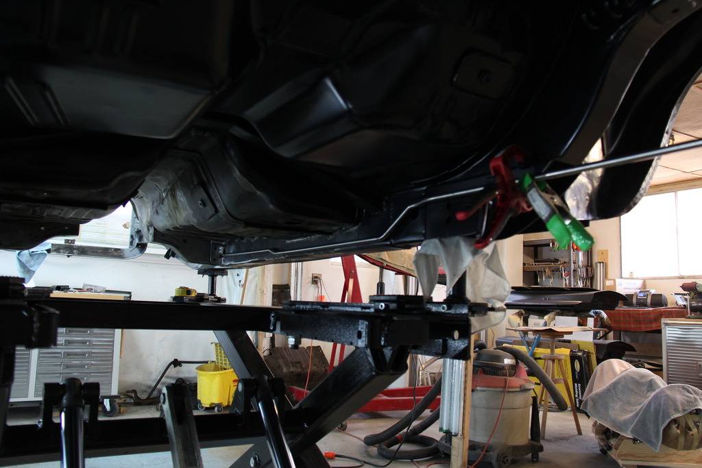

      The fuel tank access cover is done, now I can bend the fuel lines
      Thanks
      Pat

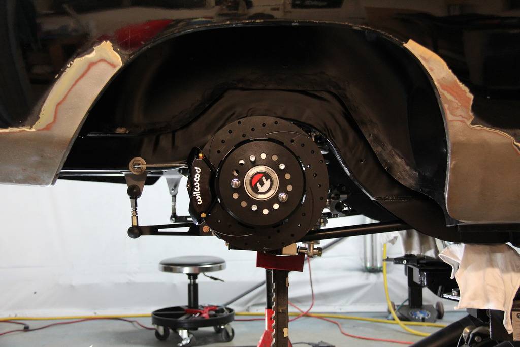

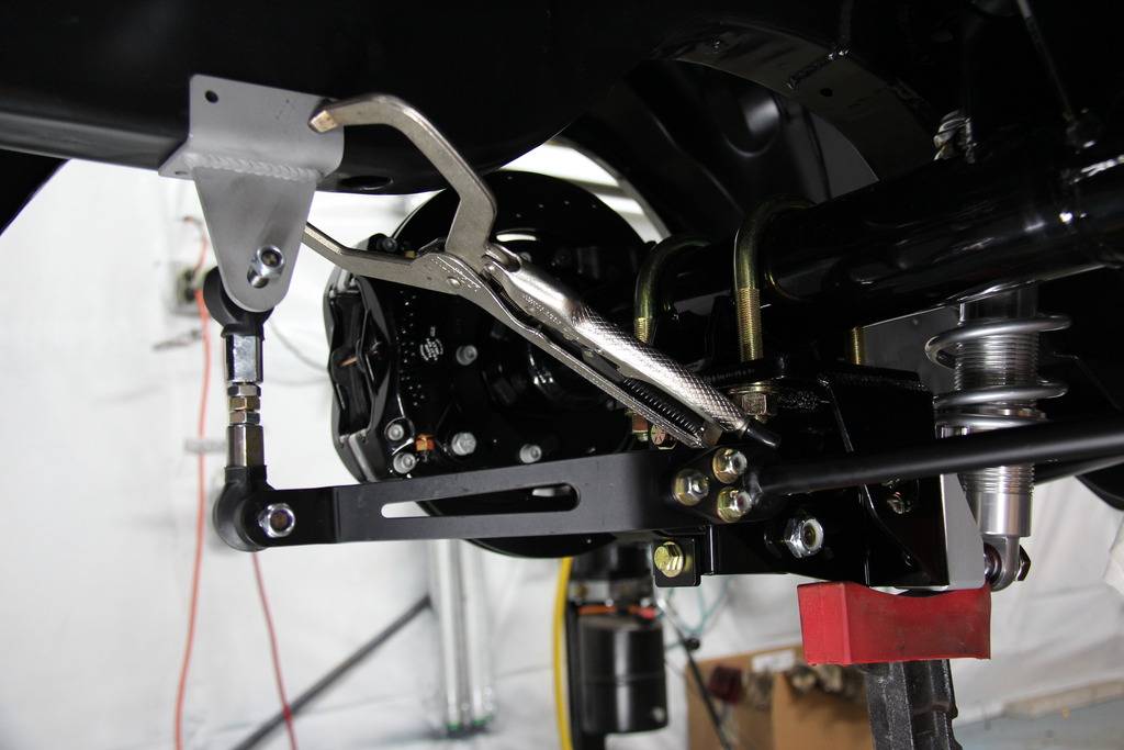

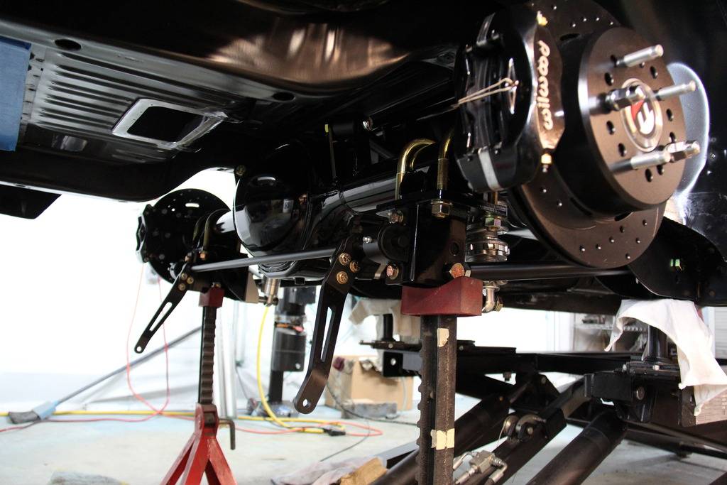

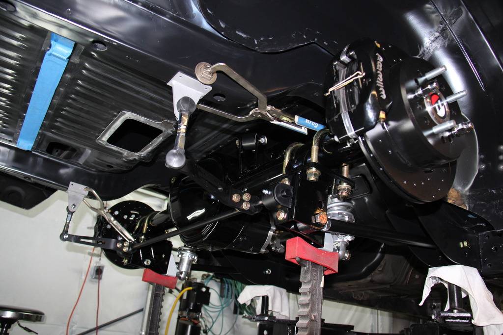

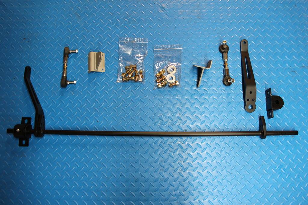

      I received the new RMS rear sway bar kit today just in time before I bend the fuel lines. I will locate the sway bar mounts first, so I can route the lines around them. This kit has been in the works for over a year and it was worth the wait! It is a great looking kit and very reasonably priced!
      Thanks
      Pat

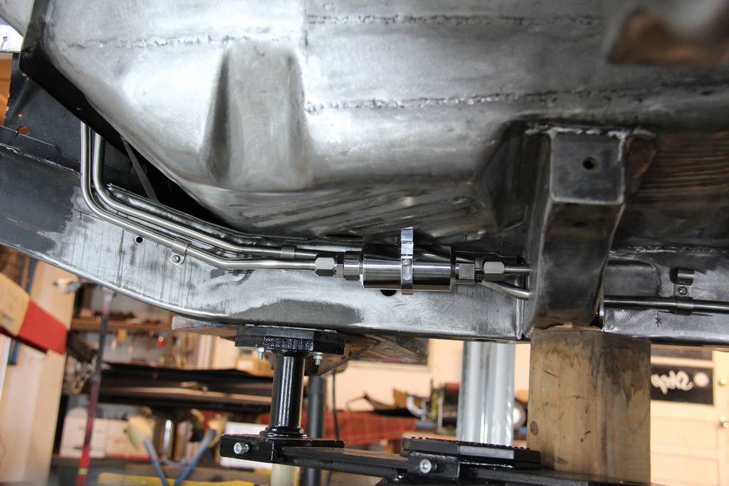

      I love Pat's posts. Short. To the point. Lots of pictures. lol
      I'm eagerly waiting to see how you run things through that little notch you made. I can't visualize what you have planned right now.
      Great work. My S-10 won't be anywhere near this nice. lol

      Quote Originally Posted by JayinMI View Post
      Jay
      Jay,
      The 2 fuel lines will be run a lot like the rear brake line on the left side, (I hope;-)
      Thank you!
      Pat

      Bill's sway bar looks great!

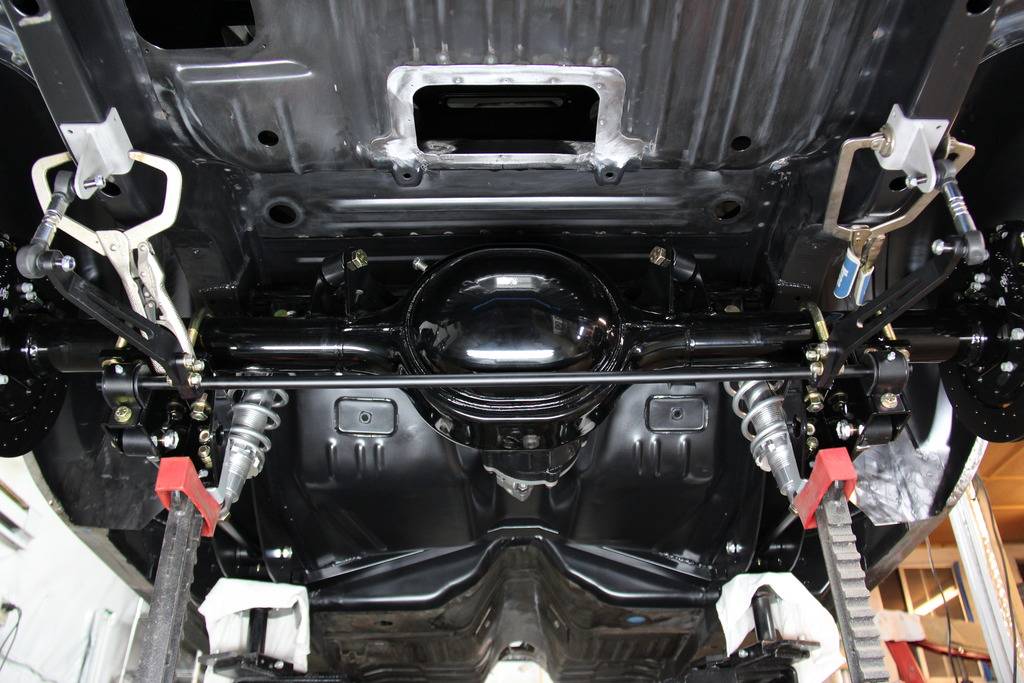

      I put the rear back in the car so I could fit the new RMS sway bar. The sway bar kit fit great after I quickly figured out it is a rear mount system. All the RMS sway bar prototypes I saw at Carlisle had front mounts. Bill said the kit will work with TTI 3” exhaust and it does look to have more than enough room.
      Thanks
      Pat

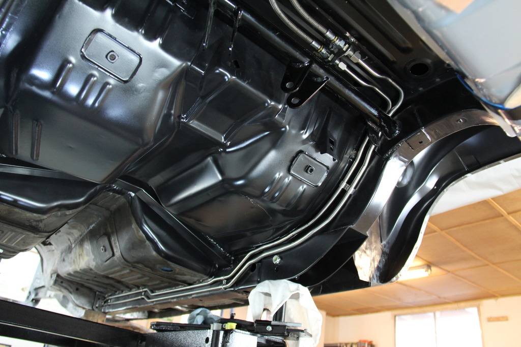

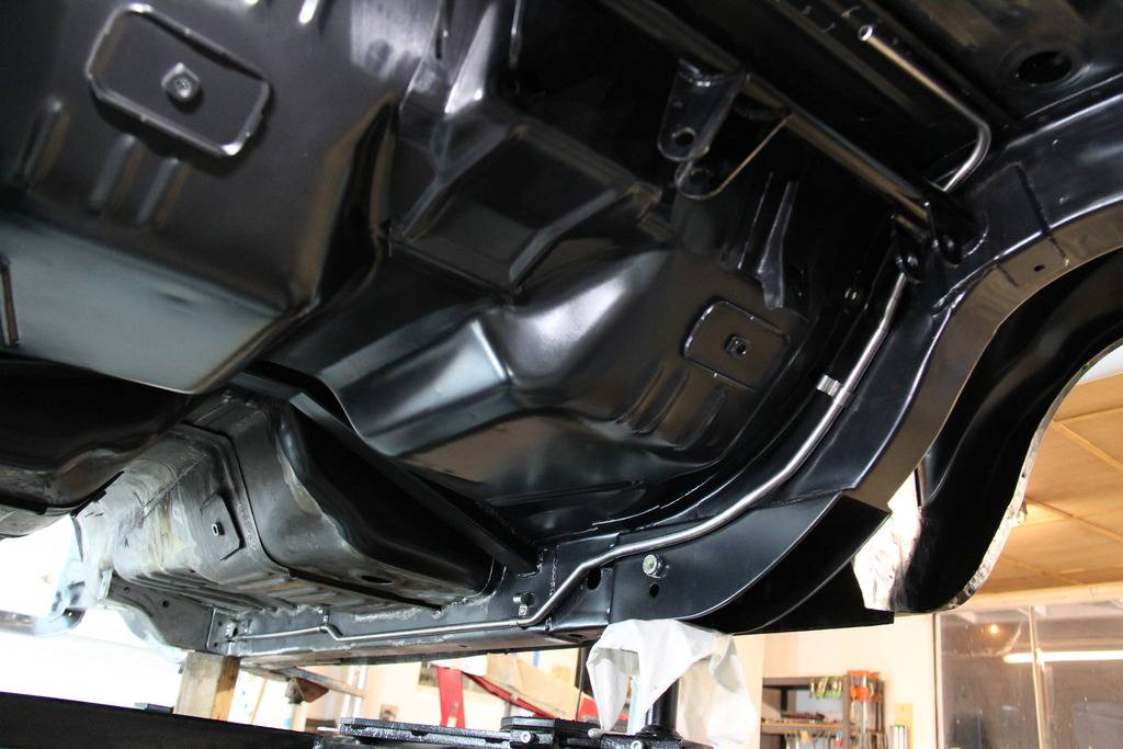

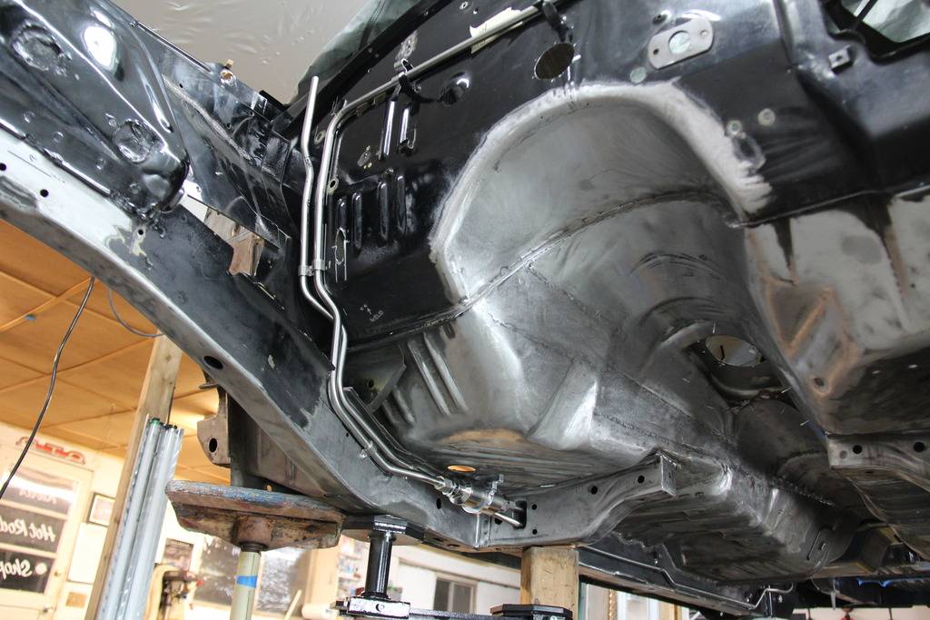

      I finished the rear fuel lines and all that is left is the Much II tank vent system.
      Thanks
      Pat

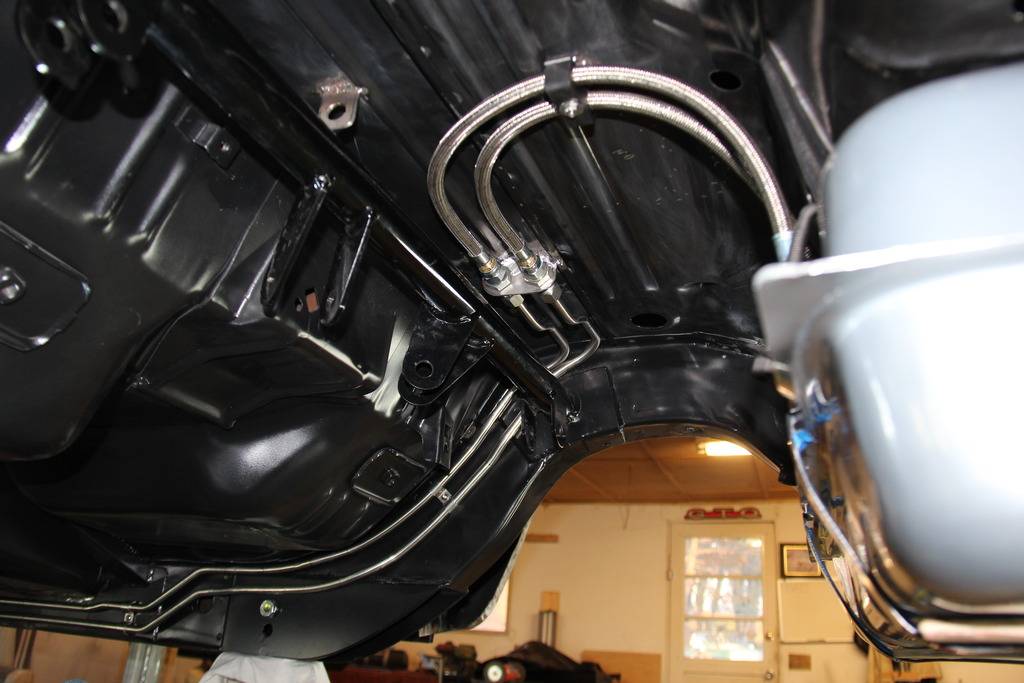

      I almost finished the fuel lines this weekend. Just one S/S line left to make and a few hose.
      Thanks
      Pat
