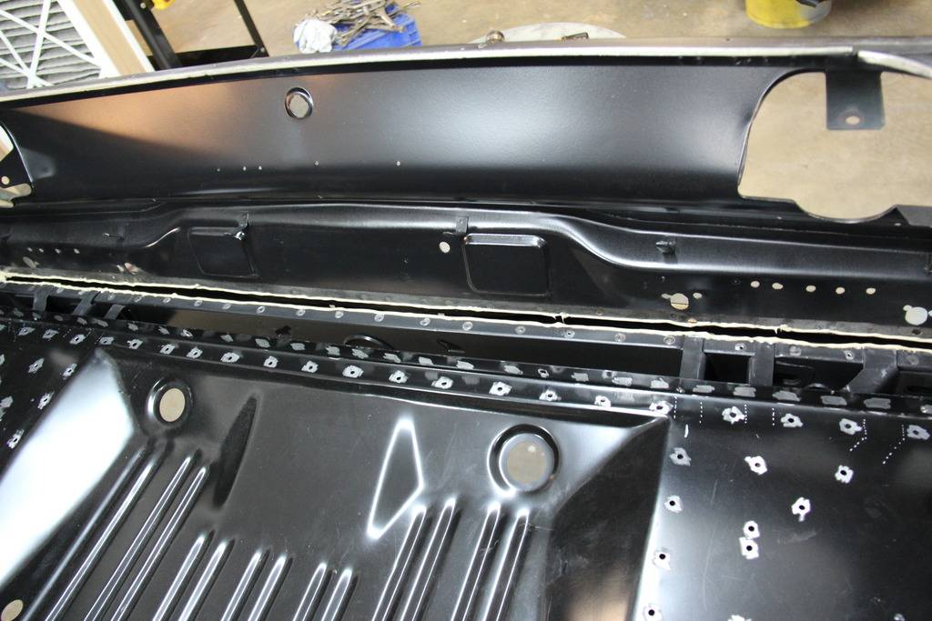

      Welded in the trunk floor today and hope to put the inter wheel wells in tomorrow. The floor fit great with little persuasion. I was able put a bead of seam sealer at the tail panel and where the interior floor meets the trunk floor. I also used my spot weld wherever I could reach and plug welded what was left.
      Thanks
      Pat
