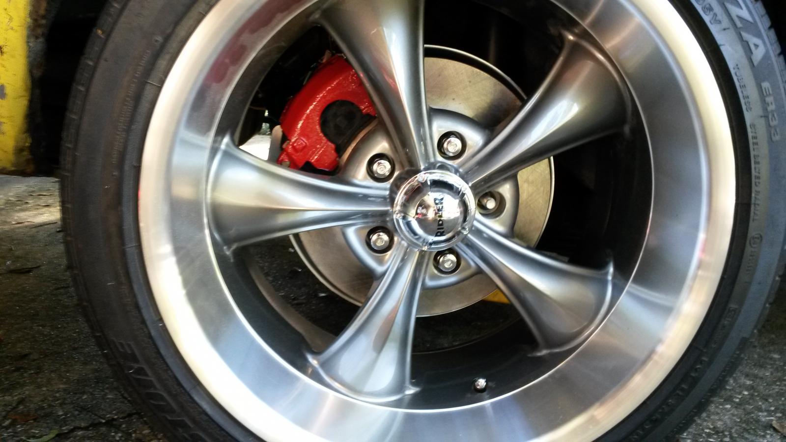

      So since I had 4 wheel discs. I had to show them off. I did the painting of the calipers. I had the paint from a while back, but just needed to perform the job.
      I also cleaned the rear wheel housing and painted. I need to do a little more cleaning.

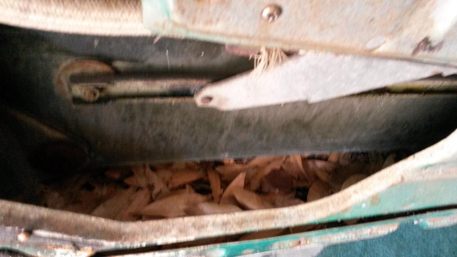

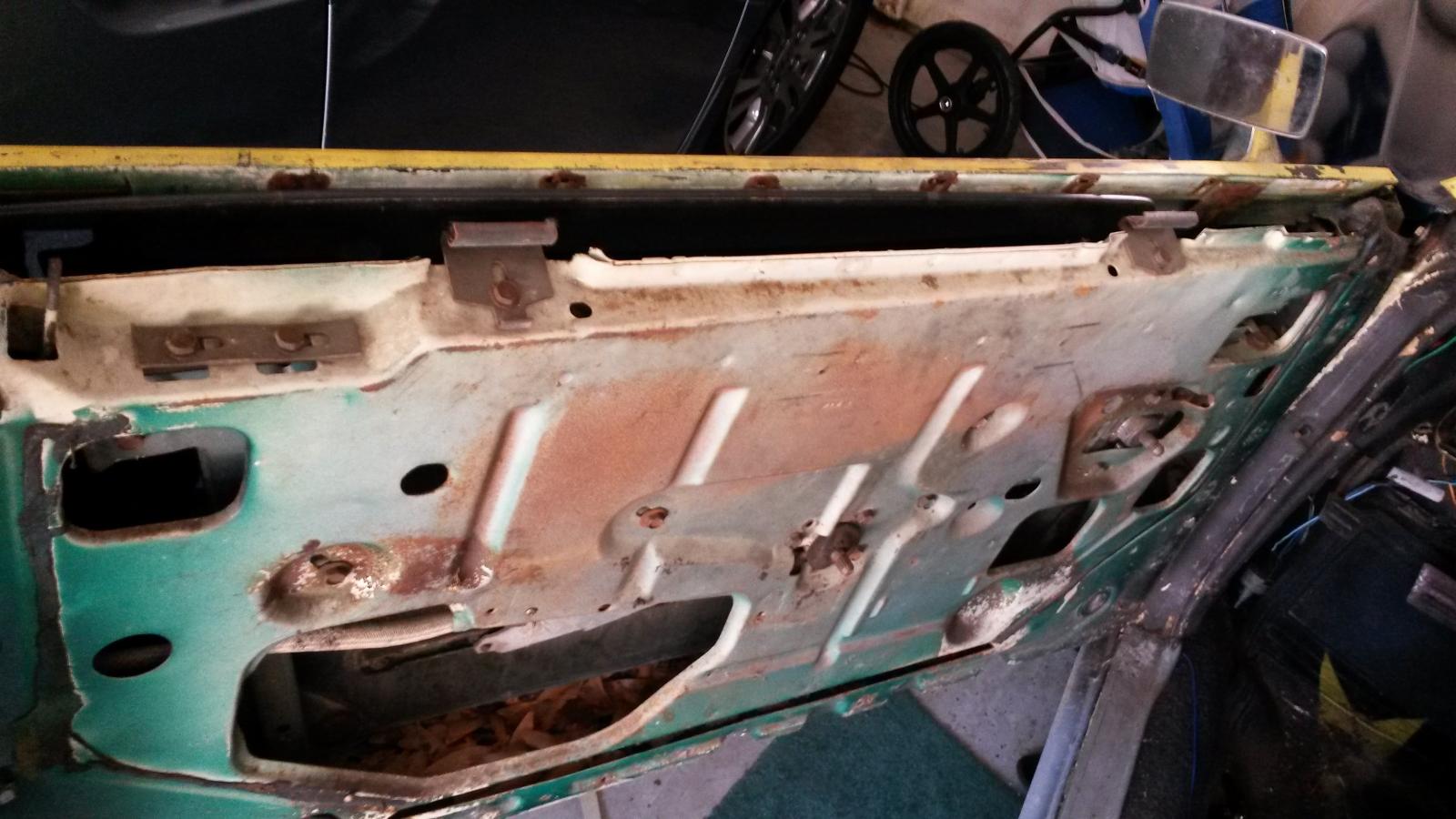

      I took off the driver side door panel to clean it up and I found this junk in the door. It was just nasty to find years and years of leafs in the door.
      I got it cleaned up and on to the next project.

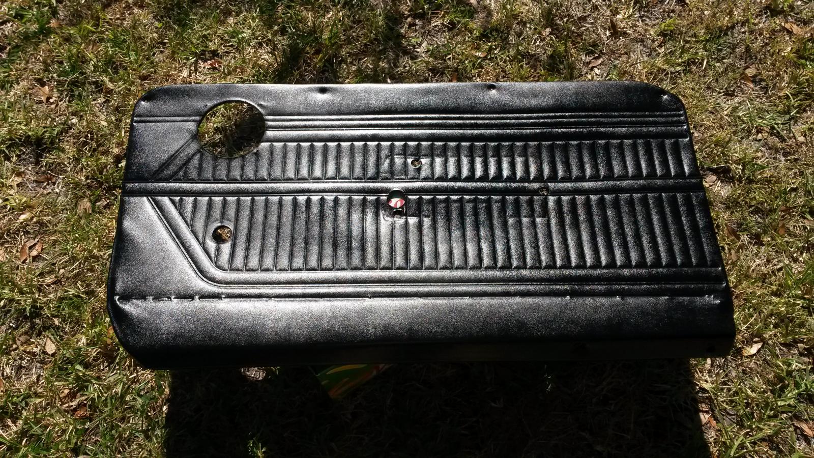

      When I took of the door panel I opted to change the color on it.
      the rest of my interior is black and it was green. There is a story behind it but not for now.
      I have never painted the interior, but it worked out well,
      I have another picture with it back in the car which I will post later.

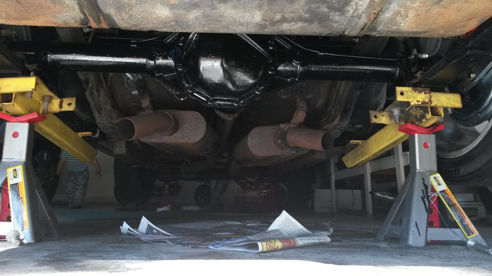

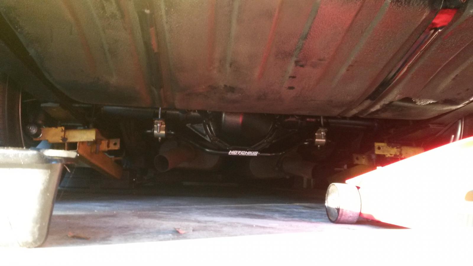

      I had time to clean up the rear axle housing. It looks so much better. I still need to clean up the rest of the floors.
      I was really glad to have the axle cleaned so I could mount one of the last items form Hotchkis, The rear sway bar is now on. I am pumped and ready for a ride.
