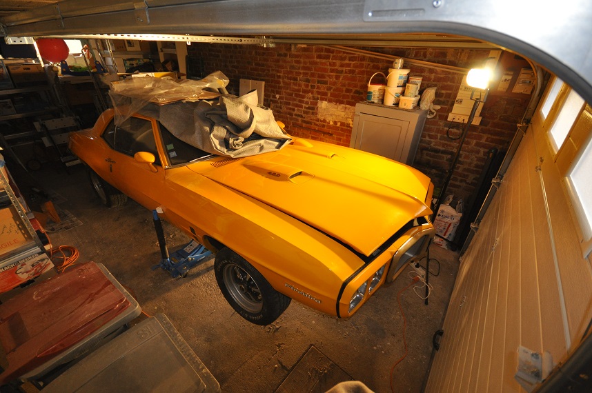

      Will post pics of my small french garage & big American car tonight !

      Hi guys
      Here are pictures in my garage
      Gil

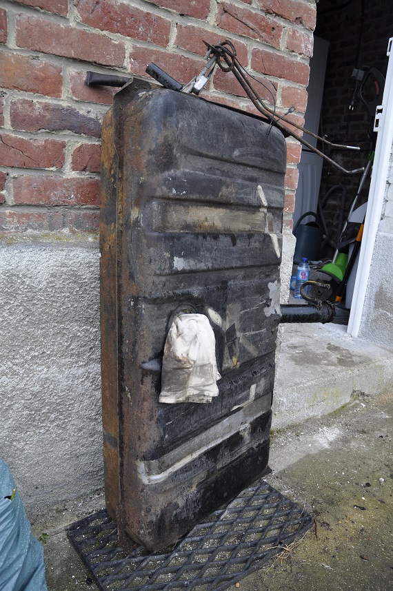

      Today I changed the fuel filter & stripped down the fuel tank.
      It's (a bit) rusty so I cleaned it with scotch-brite, cleaned with white spirit & sprayed a biiiig coat of Rustol stop-rust.
      If it's dry tomorrow I'll spray black spraycan paint to finish.
      I have also a new sending unit as my fuel gauge is wrong & I'm out petrol in the midle gauge, so it was time to put the new one I had for 5 years in a bag.
      Also discover that my trunk flor is badly rusted & previous owner tried to hide it, but when you remove the tank you see...
      - NOTE FOR LATER - CHANGE PARTIAL TRUNK FLOOR PANS
      Here is the tank, just out of the car...
      Have a nice day
      Gil
      FRANCE
      683
      Country Flag: France
      Hello all,
      Quick update tonight :
      Here is the tank, ready to go back under the car.
      Pretty happy with the result.

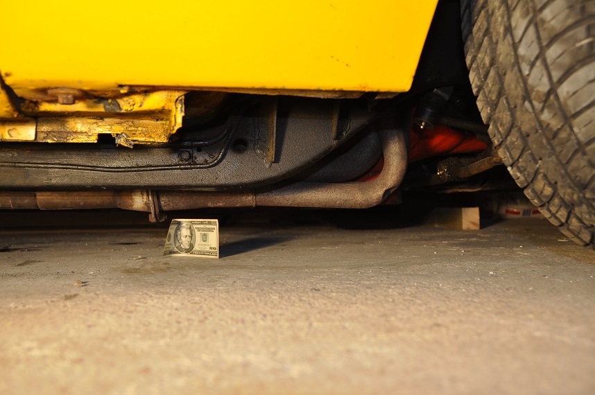

      One thing that's not cool to me is I think front ride height is too low due to poor quality lowering springs previous owner puts on the car.
      As a result, front tires are badly rubbing on inner fenders & headers (old & rusty poor quality also) are too close to the ground and rub against it sometime.
      I bought QA1 front coilovers years ago to raise the nose & have more room for headers before I change them to brand new long branch from Rare ( I have also) & home made stainless exhaust.
      So, in the next days I'm in to order LCA & UCA from Speedtech and few things like hardware and also a new throttle cable as mine is no more in a good shape.

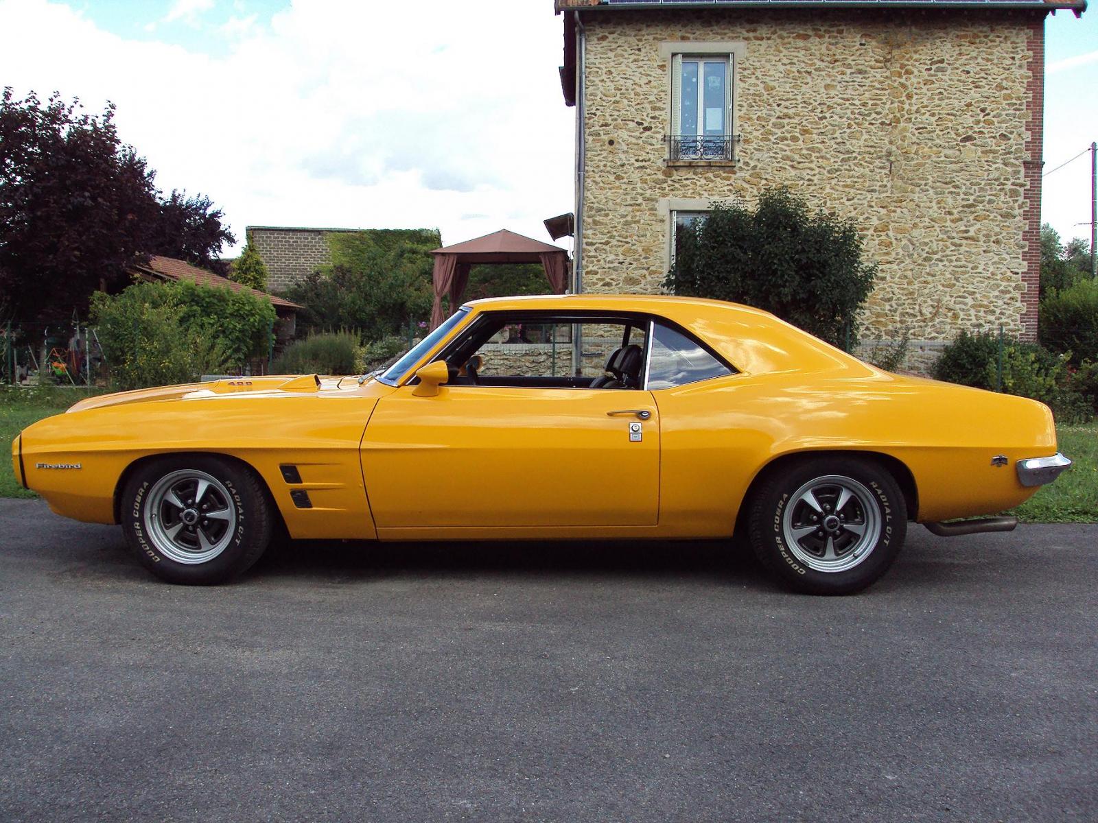

      I have this one but we don't see very well.
      I'll make closer pictures tonight
      Gil
      May 2006
      Rhode Island
      676
      Man, that is a very nice looking car! by looking at pic I can understand how you might be rubbing, especially turning. Do you get alot of people staring at it while driving around? I'm assuming there aren't alot of those around there.

      Here is a picture of my ride height
      Less than a 20$ note, really too low for the roads we have here
      Gil
      May 2006
      Rhode Island
      676
      Wow, yea that flange is really low, LOL. Looks like that header hit something pretty good too, mine are a lil scraped up too. I'm gonna check that video out!
