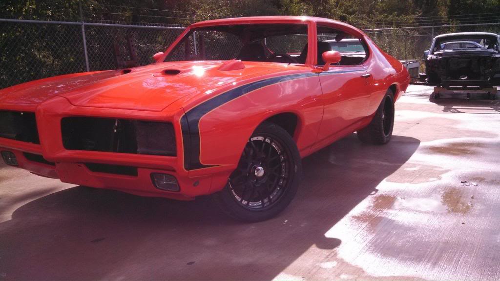

      beautiful !
      Check out my web site.
    2. #162
      Waterloo, Ia
      1,408
      Sweet. I cant wait to see it with the wheels/tires on

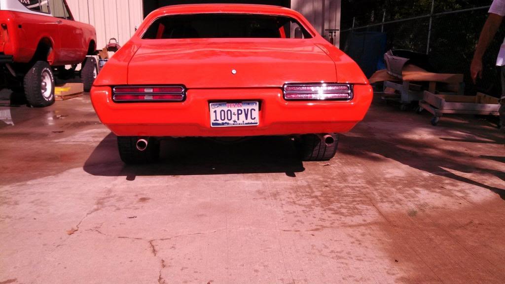

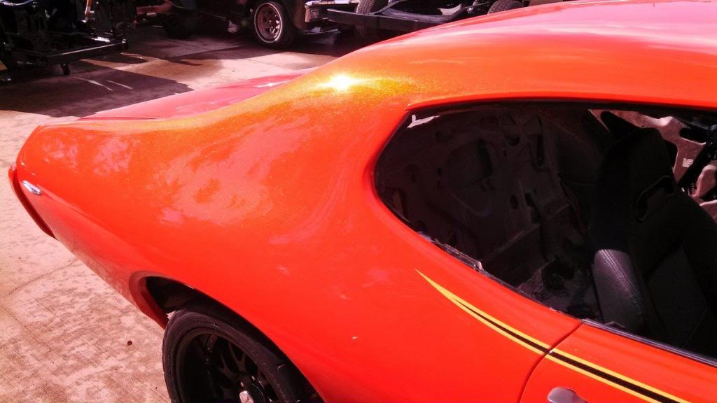

      Went today to help with putting my Goat back together. Keep in mind, I have not lowered it yet.
      Look at the color difference between the sides, and the deck lid and bumper.
      You can really see the metal flake in this one.

      Looks great. Let me know if you need a hand putting it back together.

      remember when i said i was jealous?
      damn this is going to look good when it gets a good stance on it.

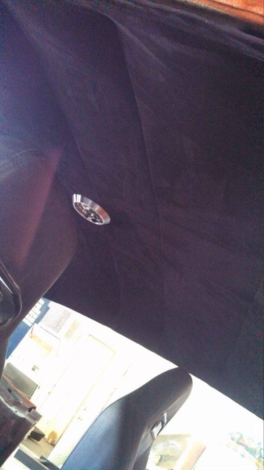

      Alcantara(Suede) head liner being installed.

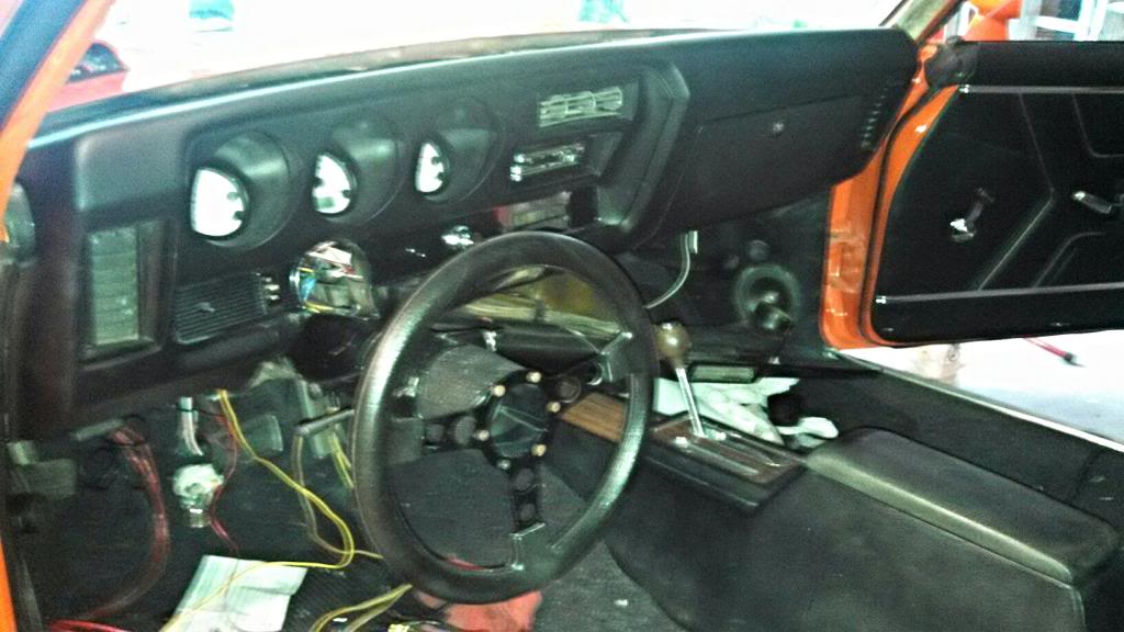

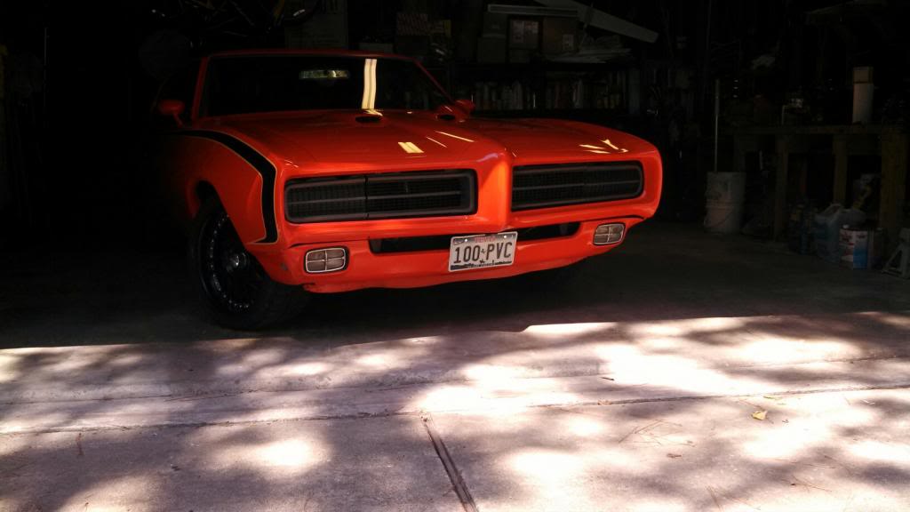

      Ok guys, i have had the car home for almost a week. Got the dash back in, sorry for the poor quality picture.
      Patiently waiting for me to start replacing the suspension and brake pieces.

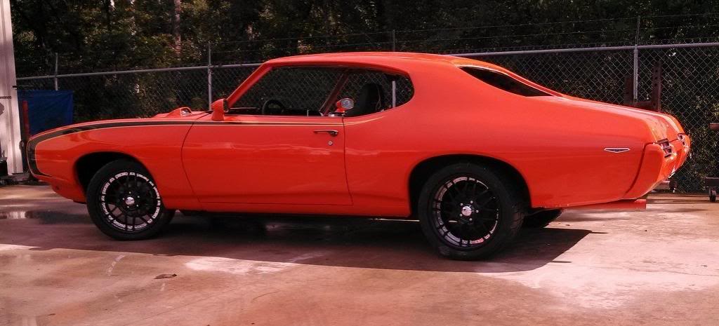

      One of my favorite pictures of me and my daughter before my 50th BD party this past Saturday. The rear has settled nicely. I can only imagine the stance when I get the front suspension changed out.

      The car looks great Russell. I'd be interested in looking at the arms from SC&C. I'm thinking about changing my front suspension out.

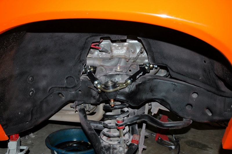

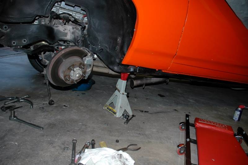

      Pictures later today. I removed the old steering box, and I started to remove the drivers side upper control arm. One stupid header pipe is in the way, so tonight I will remove the offending header (thankful for individual tube headers) and get the new SPC control arm on. I will just leave the tube off until I get the new brake lines connected to the distribution block.

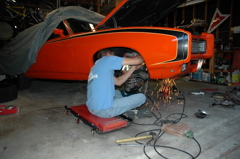

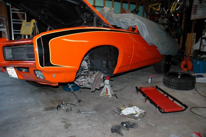

      Took the day off to get some parts installed today.

      I had to relieve the front brace on the upper control arm mounts so that the SPC arms have full travel.

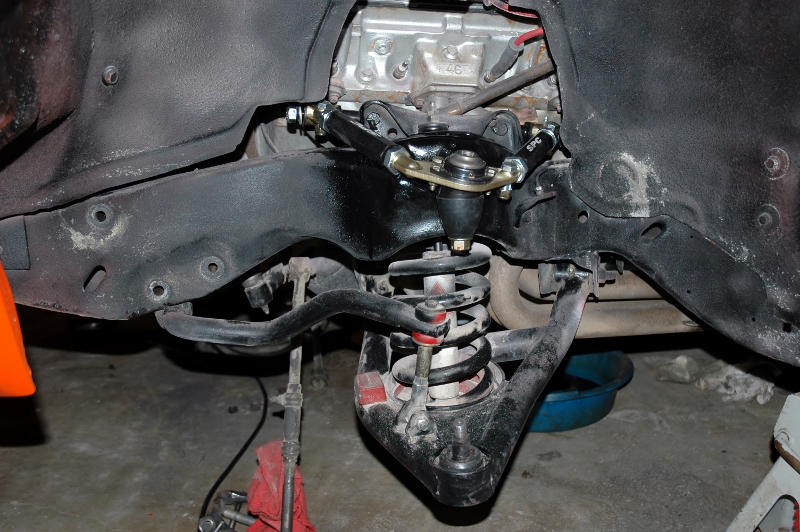

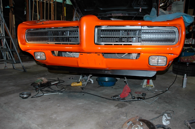

      Ok, got the upper control arms installed, as well as the new chin spoiler. I am trying to get it looking as much like the rendering as I can. Tomorrow, I will tackle the Vari-Shock installation on the front. I will have to drop the lower control arms and knock off the blind nuts that are inside the control arms, and then mount the shocks. This is going to be the fun part.

      Love to car, I like tha way you're making it into the rendering. I'm anxious to see what it looks like completed. I have one question though, did Marc sell you the tall spindles and ball joints together? I thought that you typically use one or the other?

      I purchased the ball joints direct from Howe. They are not tall ball joints. They are Howe's standard racing ball joint.

      Got it. I thought I read they were tall, but I read lots of stuff so who knows..lol Have fun with the Varishock install, complete headache....
