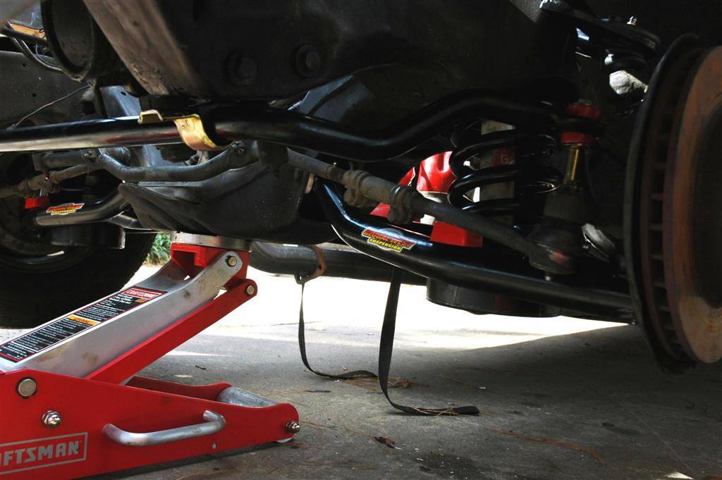

      The Global West front suspension pieces installed.

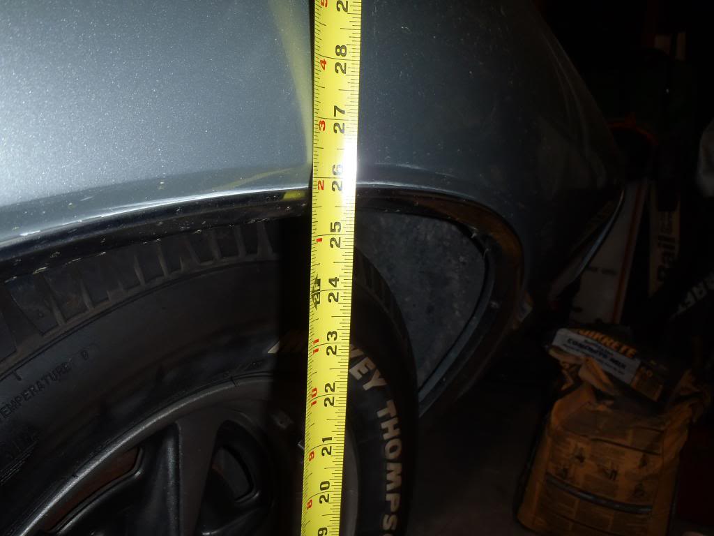

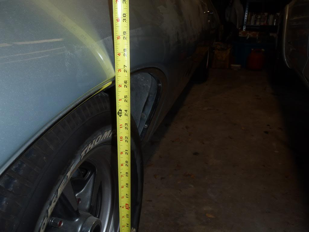

      This is my current ride height. The front is about a 1/8-1/4' higher right now because the hood is off. I'm not going any lower. This is with KYB shocks on it, I don't know if it will settle anymore with a vari-shock, Koni, or QA-1
      Rear height
      Front height
