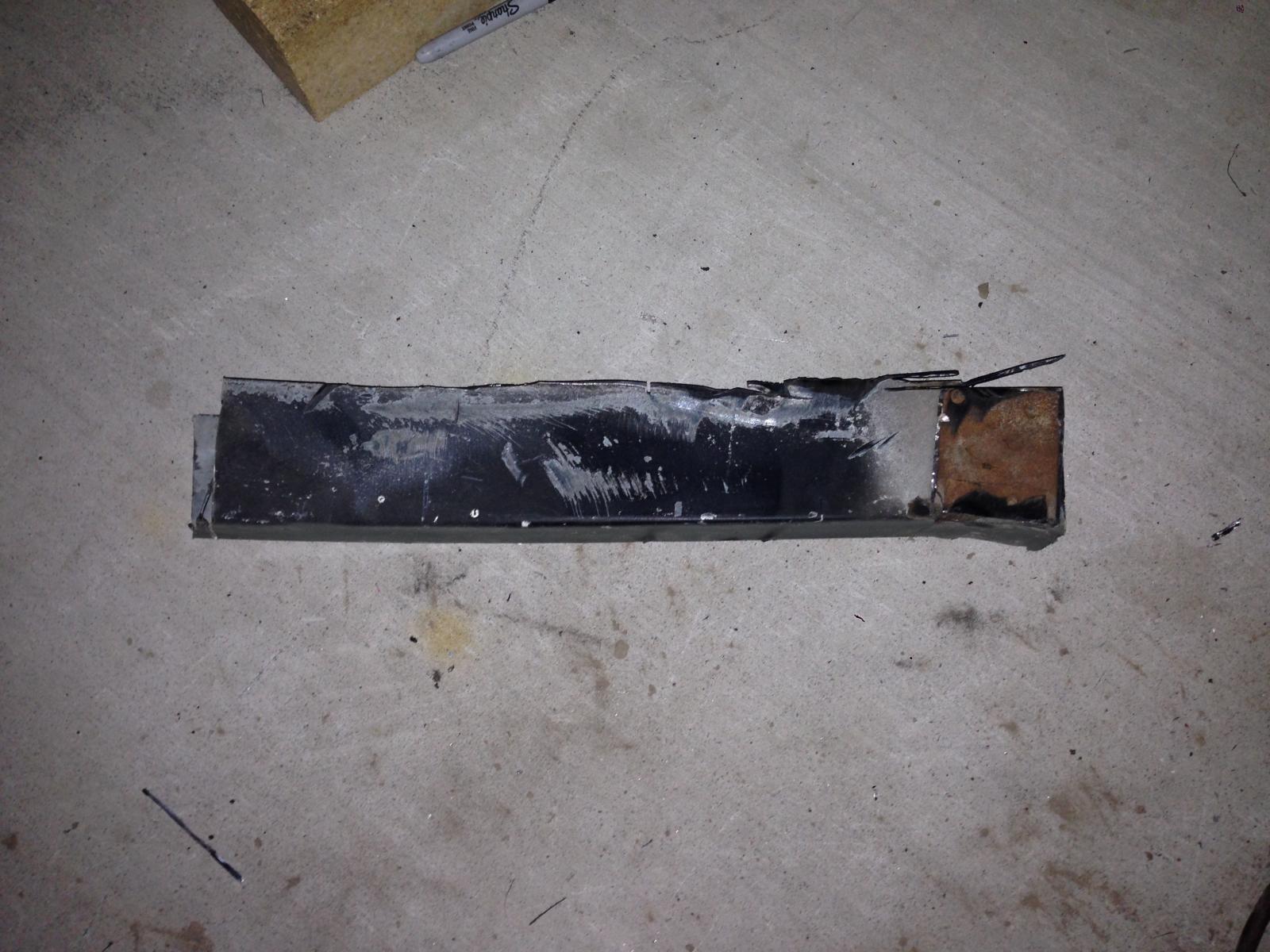

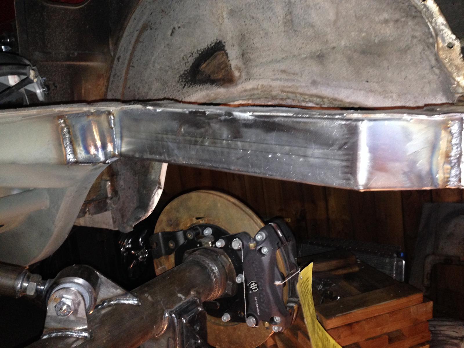

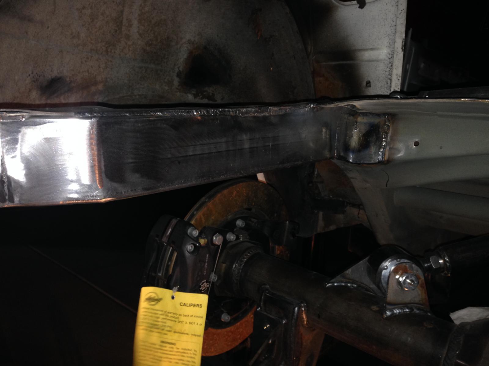

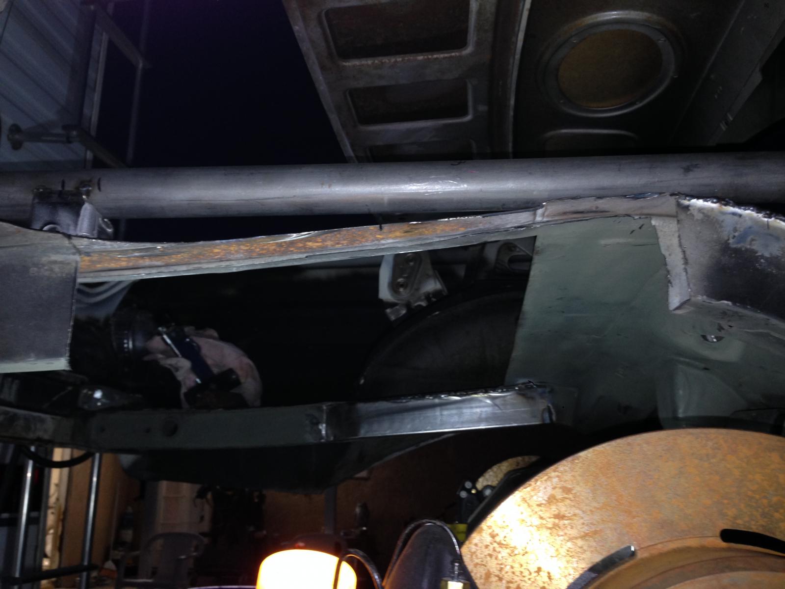

      Some cutting that it took to make room for the tires

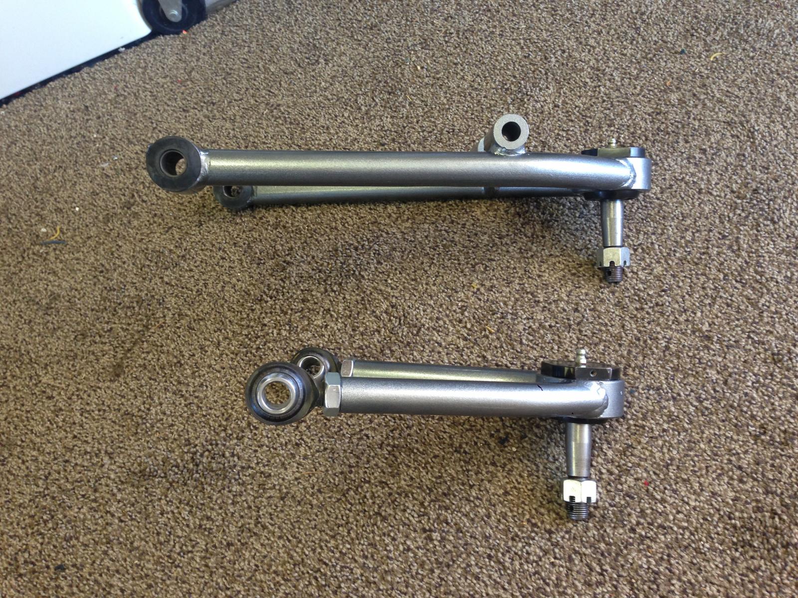

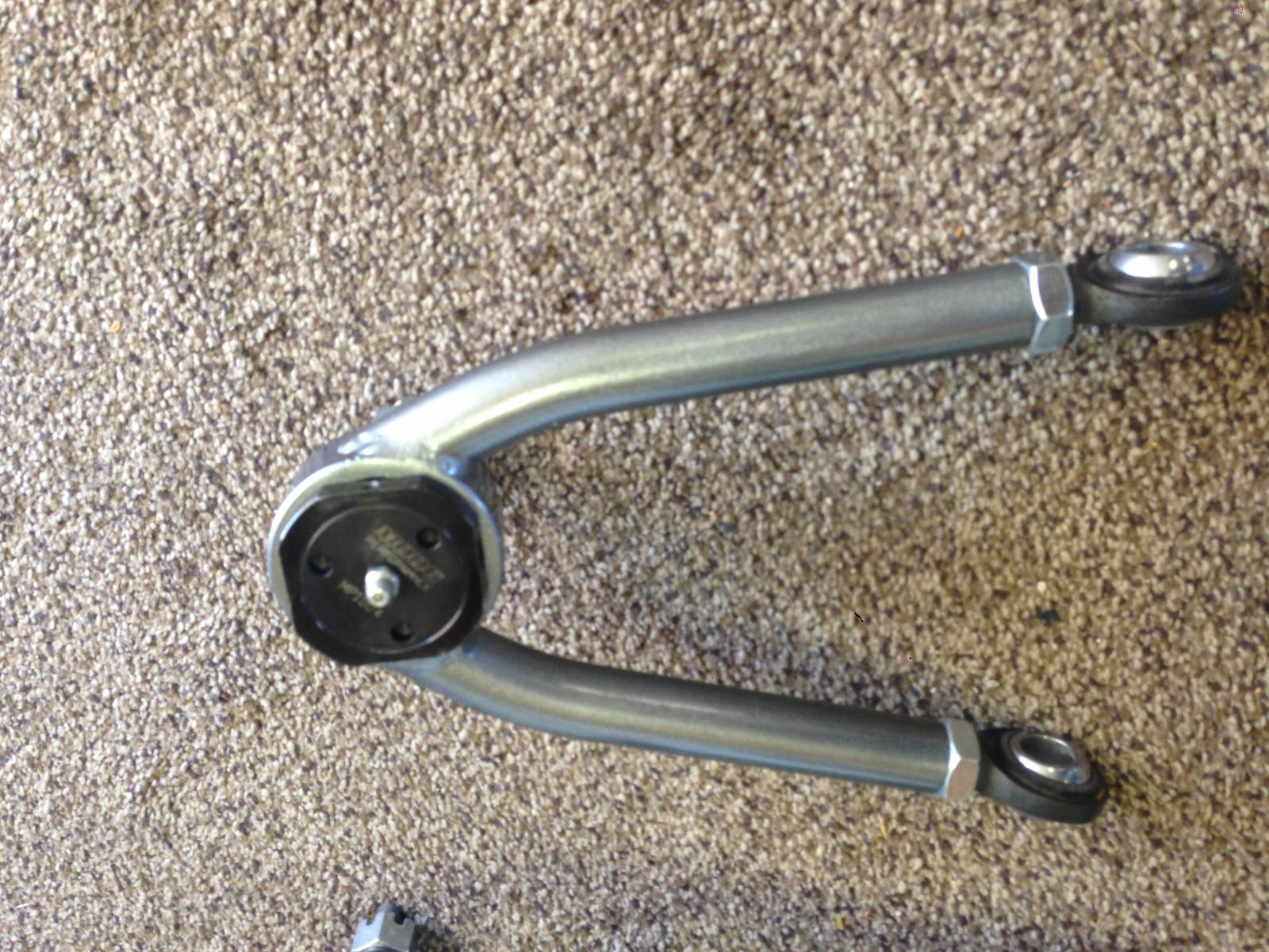

      So I got new ball joints awhile back, The ones I had, had very little movement. Unfortunately this was what happened to everyone of them when I unscrewed them. It almost looks like they had no threads to begin with and were forced in. I had to order new threaded sections for all four joints.
      So I cut them apart and installed the new threaded sections and joints, along with a little paint

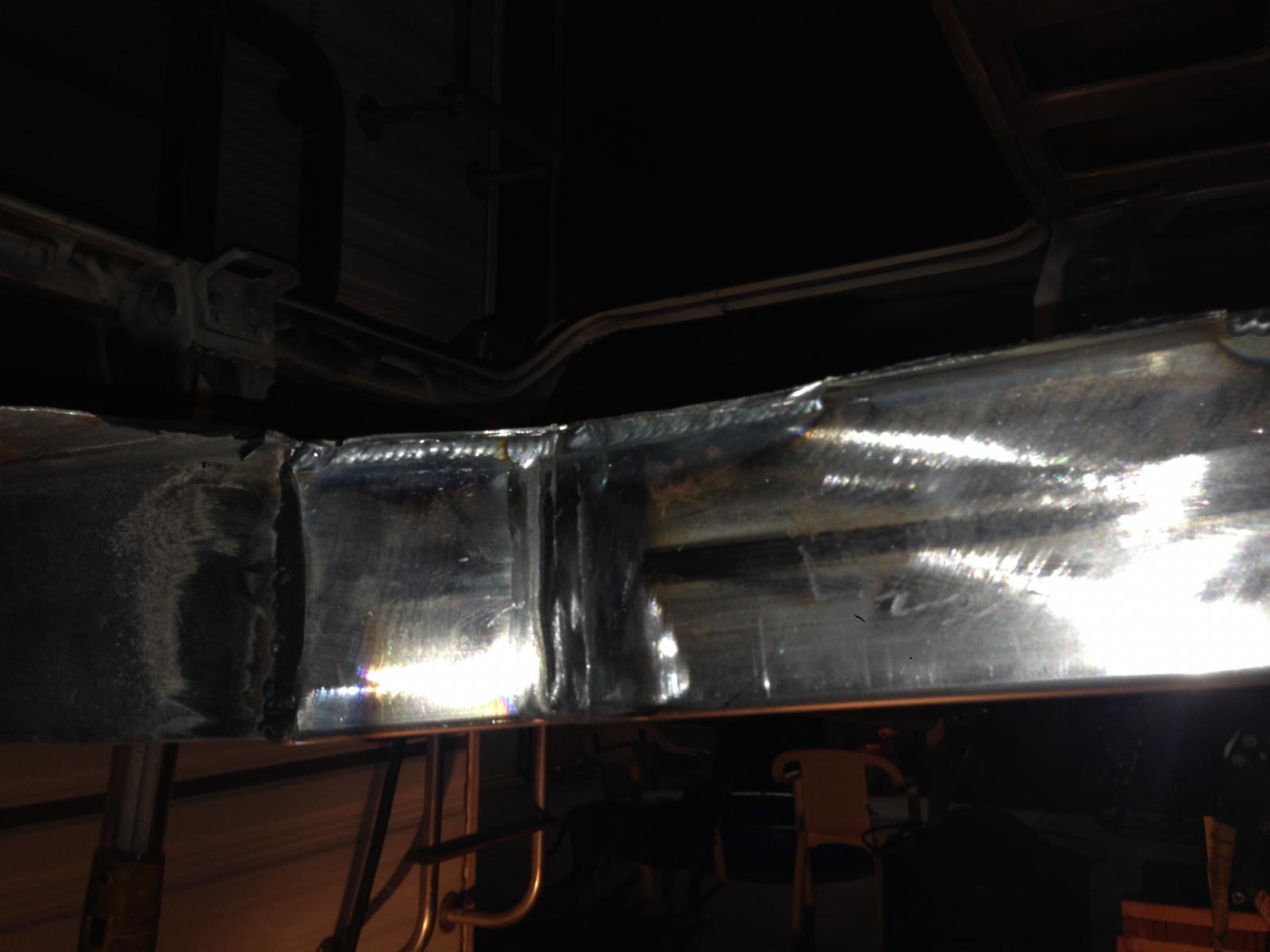

      I was finally able to get somemore done on the rear. I got the swaybar mount in it final location and even tacked the floor back in to see if it all would still fit nicely under it, and suprisingly enough it did

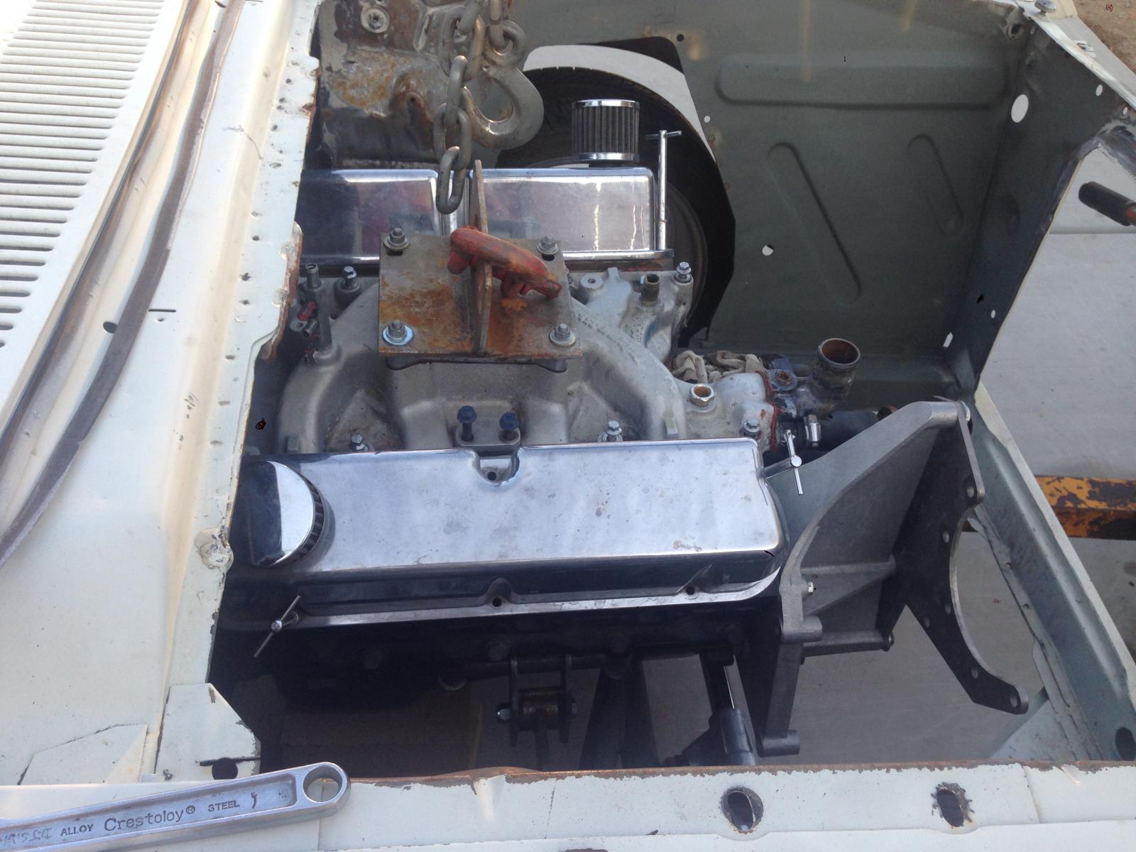

      I was able to move the motor mounts back 5" and test fit the motor. Unfortunately Im going to have to cut my front crossmember and bend a section to go around the oil pan so I set the engine down about another 2-3"

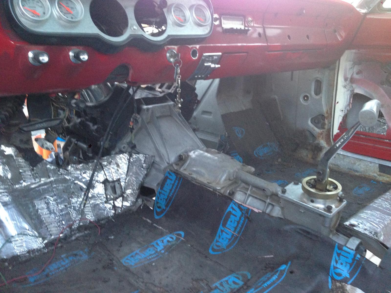

      I ended up cutting out the trans tunnel more than I would have liked to. But this way everything will tuck under the car nicely
