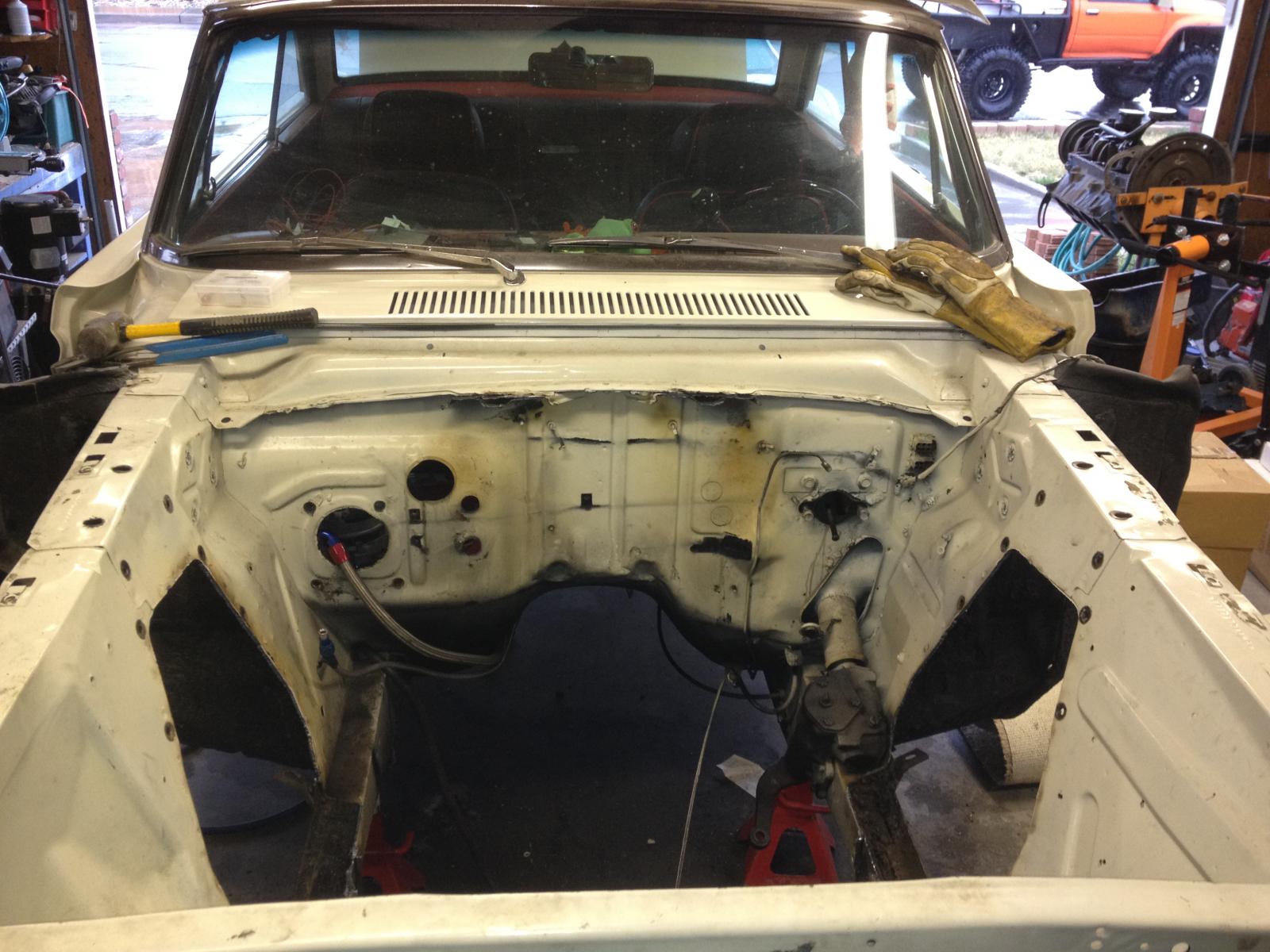

Size:  228.9 KB I have been lurking around this site for sometime now getting great ideas for my 65 Falcon, so I finally decided to start a build thread. It's really cool to see the other falcons on this site.

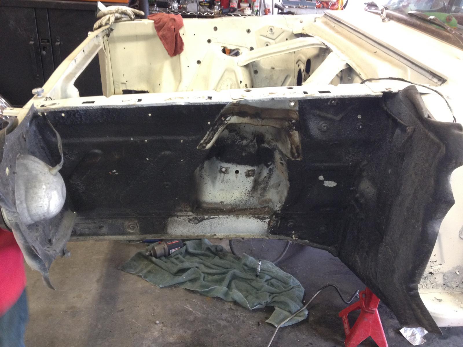

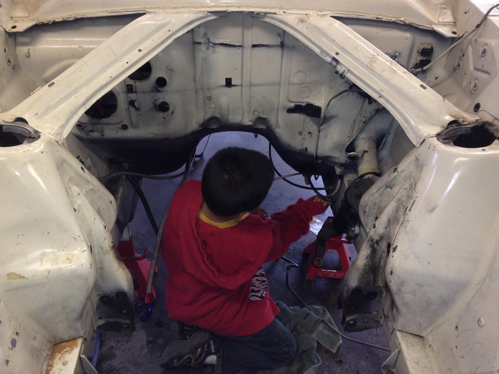

      Me and my little helper have been making good progress on the Falcon

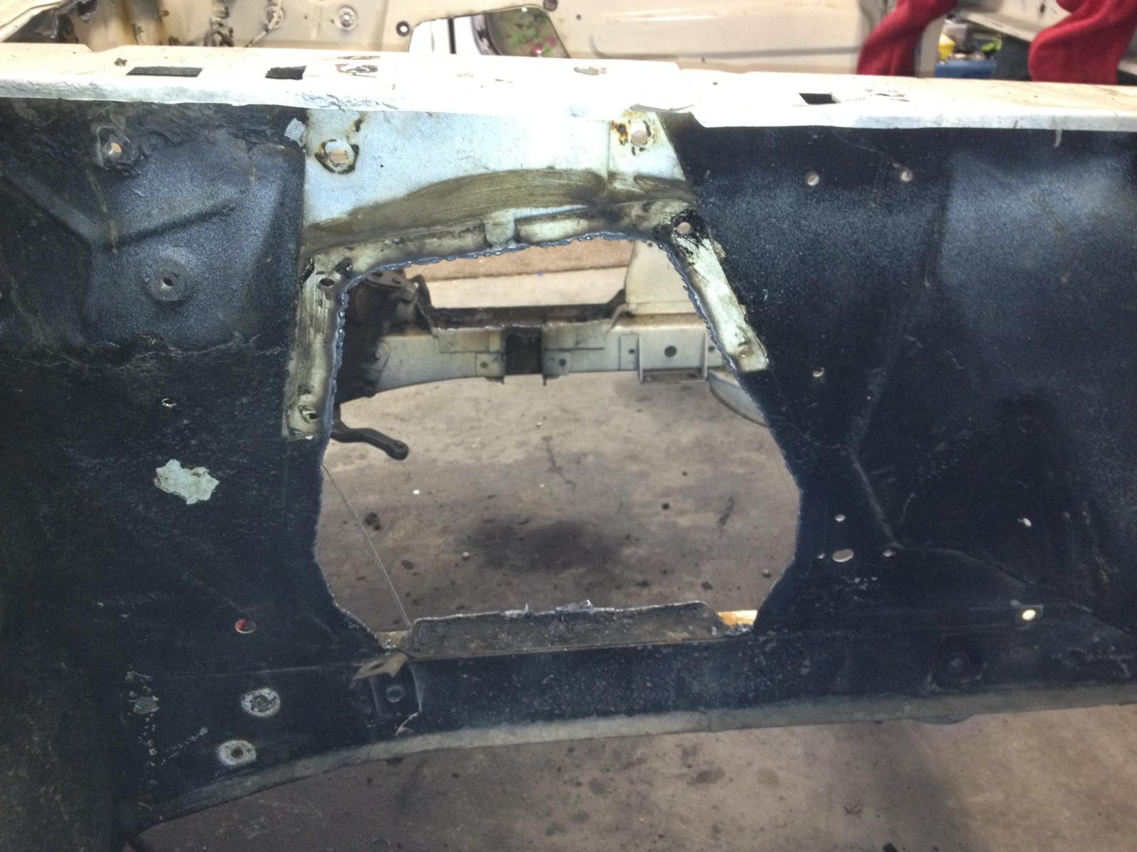

      This is the direct fit crossmember I purchased from Helix suspensions, I was very disapointed by what I was sold, even if it had fit with welds like that I would never had used it. The control arms must have came from someone else because they were actually nicely constructed.

      ^ Does not look very "direct fit", sorry you had to deal with the Helix guys. When I was looking for suspensions they came up, the prices seemed to be too good to be true, now I can see why. My concern would be if it is pulled in that narrow that you will have wheel/tire clearance issues (hit the frame) when turning. If you need any advice from us Falcon guys just ask, we have all gone about our mods in different ways but are always willing to throw in our 2 cents.

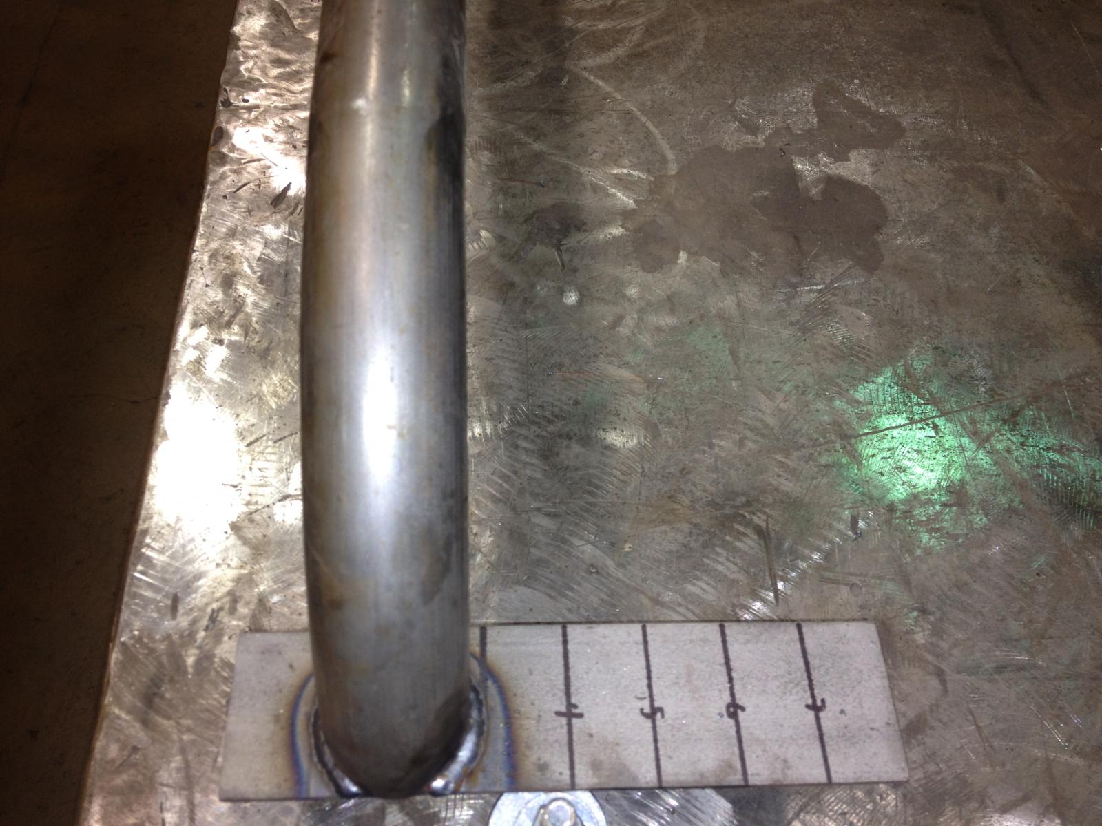

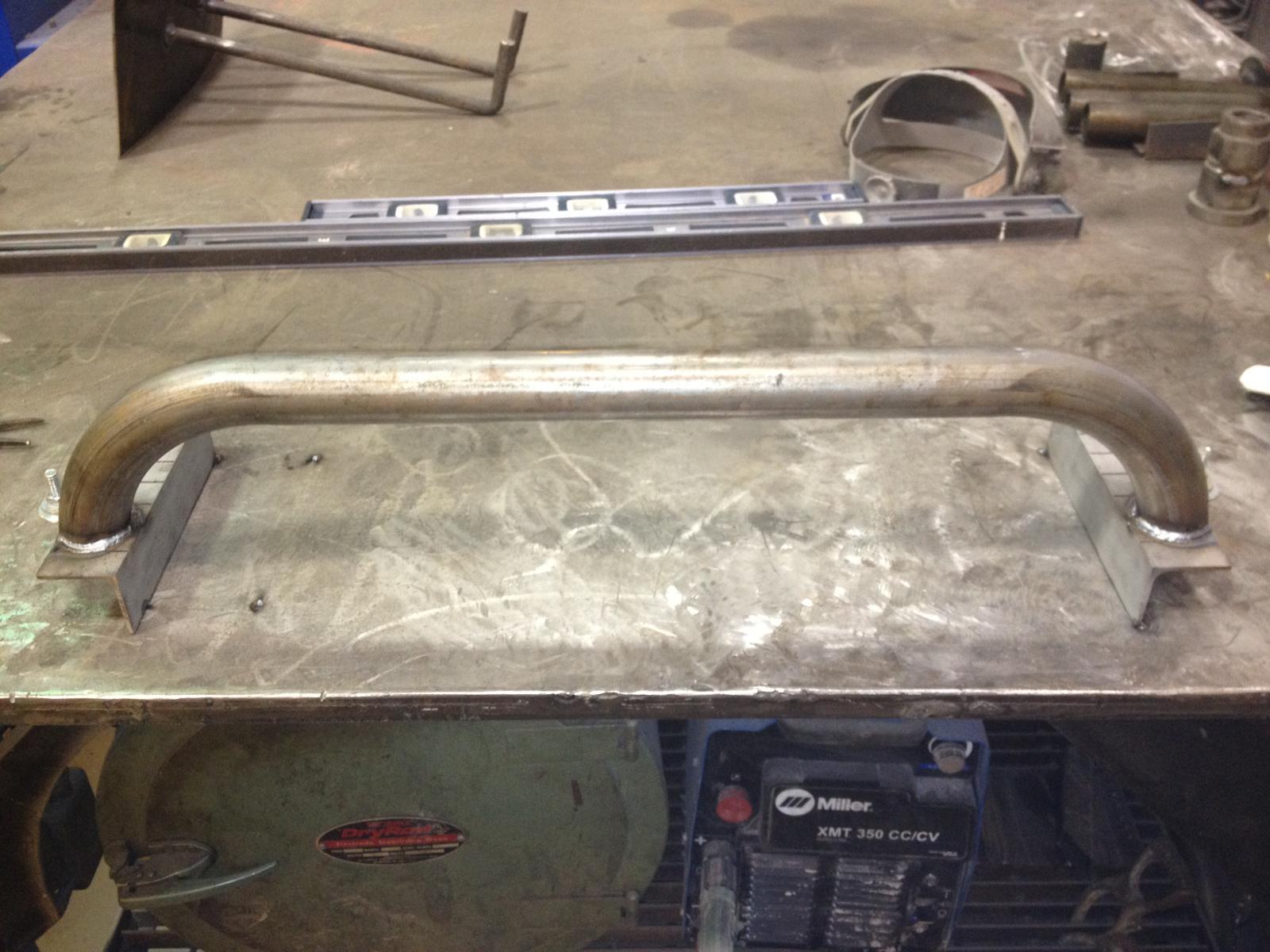

      Here's what came up with from suggestions from older brother, he's always trying to push me to build something bigger and badder then I planned, I think thats probably why this the third time I have changed the car since I got it from the junk yard.

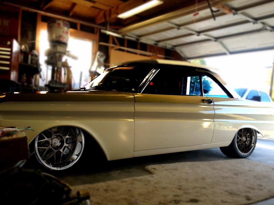

      So here's what I would like the end result to be close to. My buddy did these off of a cell phone photo so I could see how the car would look with these style of wheels

      ^ those HREs look fantastic on the car!
      Your cross member is looking better than the one you bought that's for sure. Good luck on the build and welcome to the site.

      rednderings looks awesome, you can always get wheels very similar to that instead of buying HREs that cost as much as the car did new.

      +1 This. There are lots of options out there with the look and still good quality without the big price. Some guys on here spend more cash on wheel/tire package than I have in my whole project. $4-8k wheels make sense on a 6 figure car, not so much on a low 5 figure ride.
