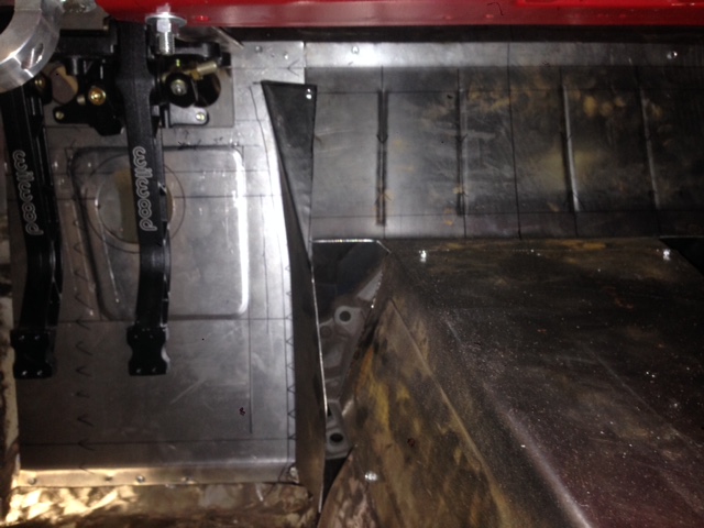

      I got a little more work started on the fire wall.

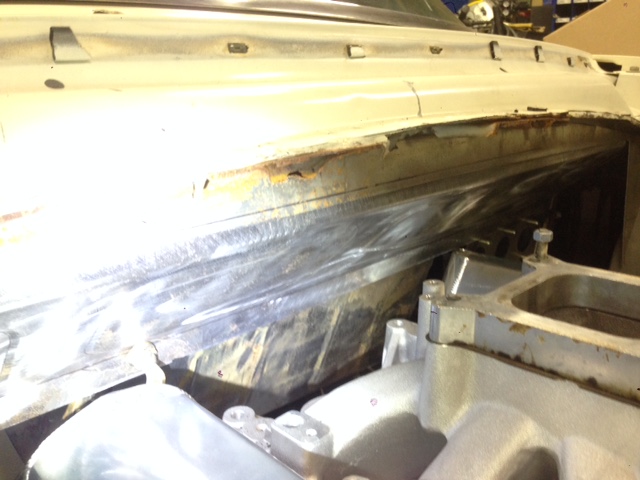

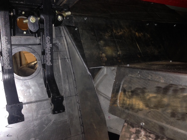

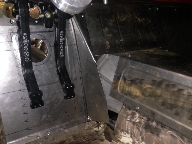

      I played around some more on the firewall, I have to add a angle in these corners to be able to pull the trans and fit around the valve-covers

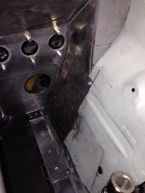

      Yet a little more progress on the firewall, it seems never ending

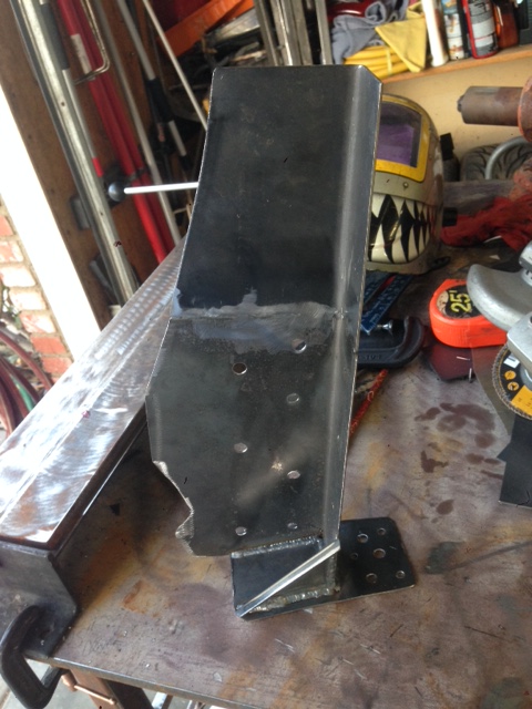

      I made these to go over the frame rails, since I moved the fire wall back I had a gap between the frame rail and the firewall

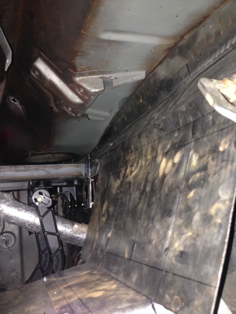

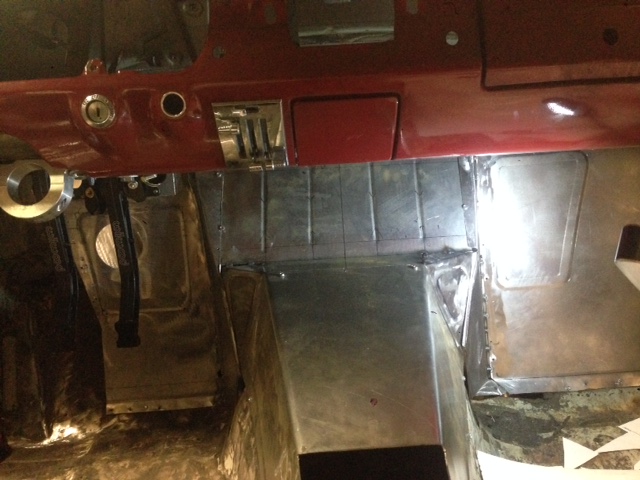

      This is how the firewall looks under the dash, I hoping the wipers will still fit, and I should be able to fit a AC/Heater combo up in there.

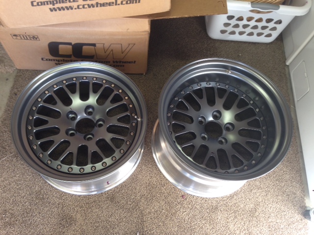

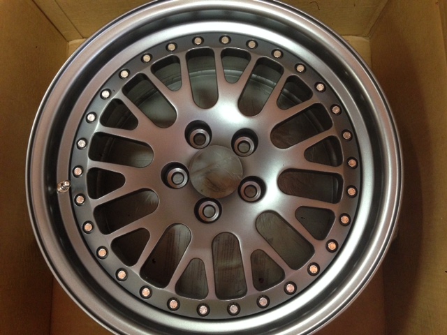

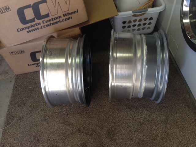

      I finally bought my rims, and I dig them, as soon as I can roll the car out ill take a couple photos of how it looks.

      Quote Originally Posted by LowFast View Post
      Wheel and tire specs?
      CCW classics, they are a 3 piece wheel. I had them powder coated in satin pewter. The front are 17x8 with 5" of backspacing and weigh 22 pounds each, and the rears are 17x11.5 with 6" of backspacing, I forgot to weigh the rears before they were mounted on the tires.
      I went with Nitto 555's 245/45/17 on the front with 315/35/17 on the rear

    14. #154
      Texan Back in Texas!
      675
      Very nice, I am running roughly the same specs only in an 18" wheel. I am a bit suprised at the weight of the fronts, I always considered CCW's a light weight wheel.

      104
      Thank you, I dig the wheels on yours, I tried to get a set of NewGen Mini lites but they never answered any calls or messages, so went with these, they have always been one of my favorite styles. I was surprised myself by the weight.
