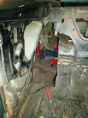

      Wow I had no idea how much work it was going to be to clean the undercoat off the bottom of my '67. I'm using these to chip off the undercoat and a heat gun when needed to get the hard spots clean. It's actually chipping off easy but it as a big chunk of area to cover with these.
      I've also found some damage under the undercoat in my floor as it looks like the car may have at one time drove over something and damaged the bottom.
      Name:  image 1(5).jpeg
      Name:  image 1(9).jpeg
      Overall the floor is not bad but the driver side is not looking great. I'll have to decide if Im going to put some time into fixing them or just cut them out and replace the drivers side.
      Name:  image 1(7).jpeg

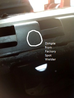

      Thought I would share a little on how I took the dash out of the car. Please feel free to send me any suggestions you have as I will be taking on my quarter panels and some floor work in the future. Hope this helps someone with taking on their own project as it really isn't hard stuff if you just take your time.
      Here is the damaged dash that has been patched and bondo over the rust by a earlier owner
      Name:  image 2(13).jpeg
      First I found the "dimples" along the dash where it was spot welded at the factory
      Then I used a small sharp drill bit to put a small pilot hole in the centre* (*that's how we spell center in Canada)
      Then I used a stepped drill bit to drill through the pilot hole while using a screw driver to apply light pressure up on the metal until you feel the metal pop loose
      Here is a short video I shot so please excuse the shaking and the out of range shots. What I was trying to show was how the multi stepped drill bits work for drilling out spot welds. When I use this bit it goes in the small pilot hole I've already drilled and I ususlly use my other hand to hold the screw driver to lightly pry up on the weld so when the stepped bit makes a big enough hole the metal pops up. Really nice and simple and makes just enough of a hole to take out the spot weld.
      http://youtu.be/5INrhOp0K-k
      I got sorta lucky with the rust doing most of the work along the front of the dash so I just used some tin snips to remove the little bit of metal along the front of the dash.

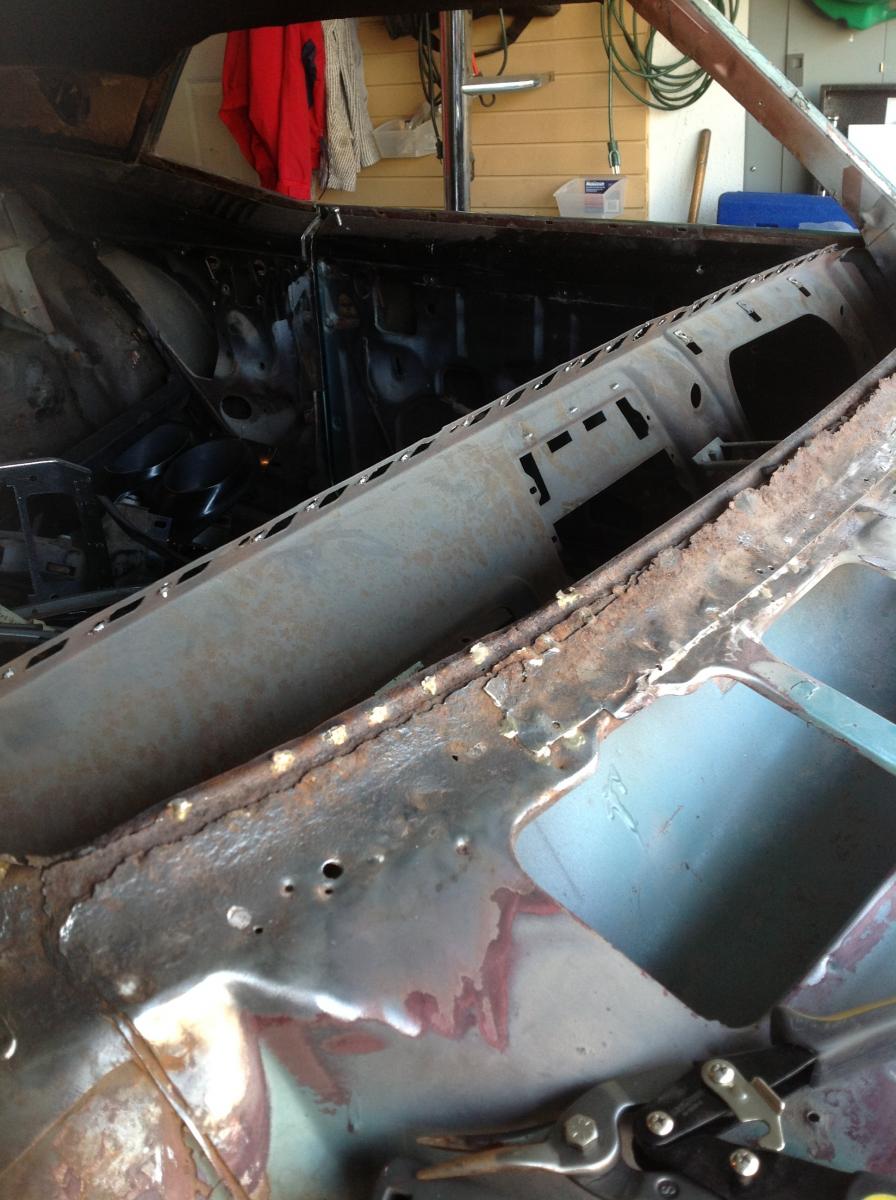

      It's been a while since I've done some updates so I will try and get caught up although doing these updates from my iPad has become a bit more of a challenge than using my PC. The pictures are not as easily formatted and may appear a bit more wonky than before but I will do my best.
      So to start I tore out the dash because it was a giant mess that someone had covered in bondo before. They must have thought that because it was under the windshield that it doesn't matter. Well, I'm very picky so it does matter so I took it all back to good metal and started again.
      And after it was removed
      The new metal goes in and is looking better already

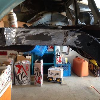

      With the installing of the mini-tubs on my '67 I needed to narrow the frame. The kit I used came with filler pieces but I ended up building a few parts myself so I could make it reinforce the way I wanted. Again with the plasma cutter I was able to pick up some plate steel and fabricate what I wanted.
      Here is the filler kit that came with the mini-tub kit;
      Name:  2013-07-22 20.33.33.jpg
      Here I marked out the part I wanted to cut out;
      Name:  2013-07-24 17.10.05.jpg
      then the cutting starts;
      Name:  2013-07-22 20.33.03.jpg
      Name:  2013-07-24 17.25.49.jpg
      Here are the filler pieces;
      Name:  2013-07-24 17.51.31.jpg
      Here is the long filler piece and it required a little curve at the end to close in the frame. Amazing what a good hammer and an old drive shaft can do to make the exact curve I needed.

      then the part that I cut out with the plasma cutter and welding the frame up and cleaning the welds.
