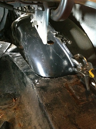

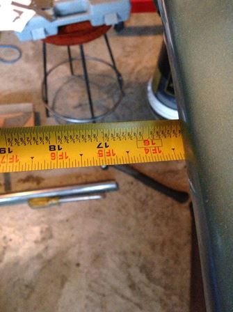

      Once the frame was welded and reinforced the way I wanted it then I put the tub in and secured it with some vice grips.
      Name:  2013-09-10 19.12.01-1.jpg
      Name:  2013-09-10 19.12.55.jpg
      Name:  2013-09-10 19.13.13-1.jpg
      And now for the money shot and why all this work is worth the effort. I've now got 15 1/2" of inner wheel space for some HUGE rims and tires

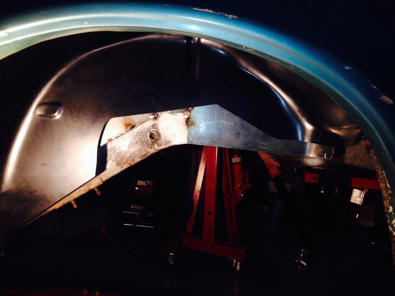

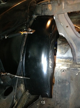

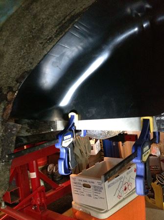

      Well it's been a while since I've done any updates but the facts are I really haven't gotten to far. While getting the ZL1 was a great idea to start developing more driving experience, and it's been a blast, it's also taken some time away from building my '67. Well enough of the excuses.
      So what I've managed to finish is fabricating the frame plates for the drivers side and cutting the floor pan and making room for the Mini-tub. Tonight I tack welded the new plates in place and did a final fit of the mini-tub housing and it looks like this;
      So the next step will be to finish welding in the plates and grind and clean up. After this is done then I'll start on installing the TCI rear suspension. I've got some holiday time coming up with plans to spend a week in the garage getting back in touch with my sweet little SS and hopefully a step closer to getting it on it's own wheels.

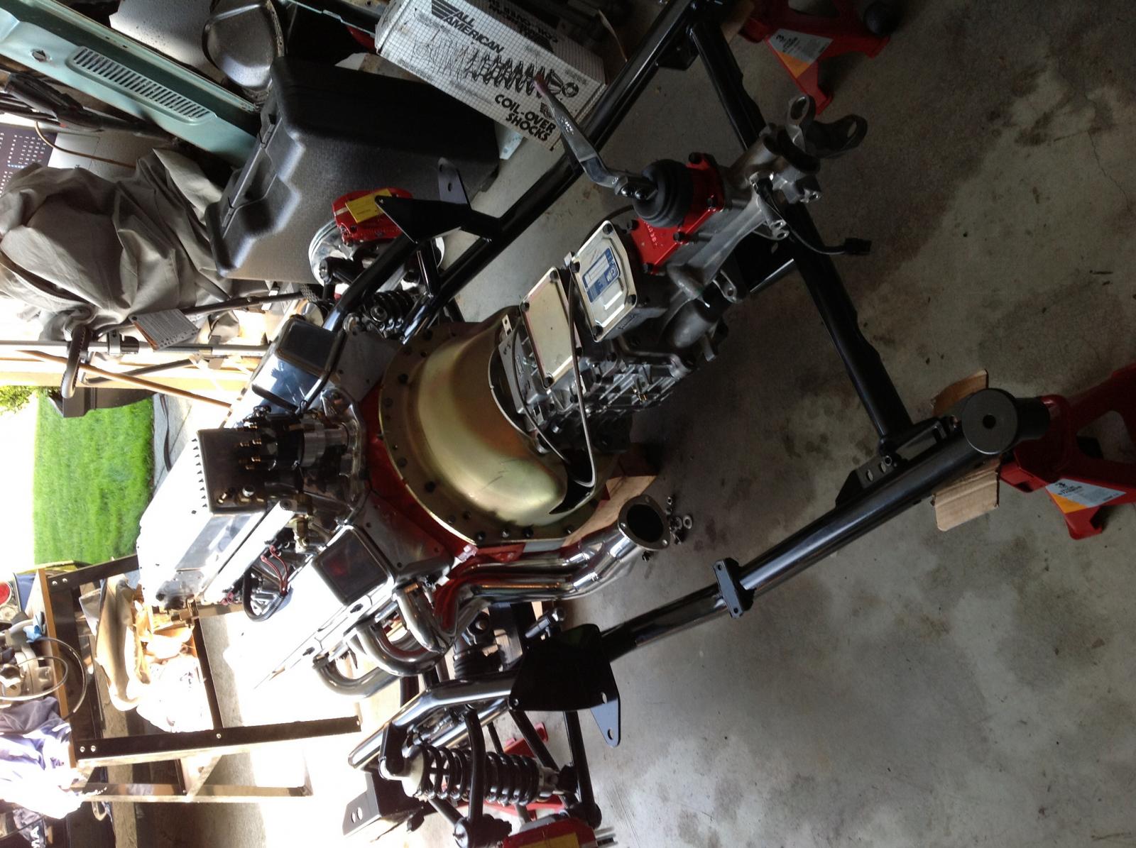

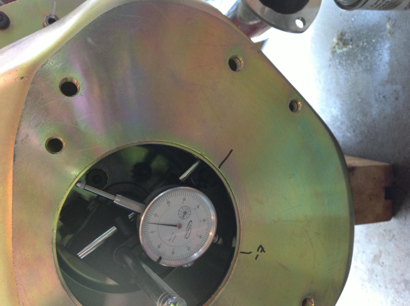

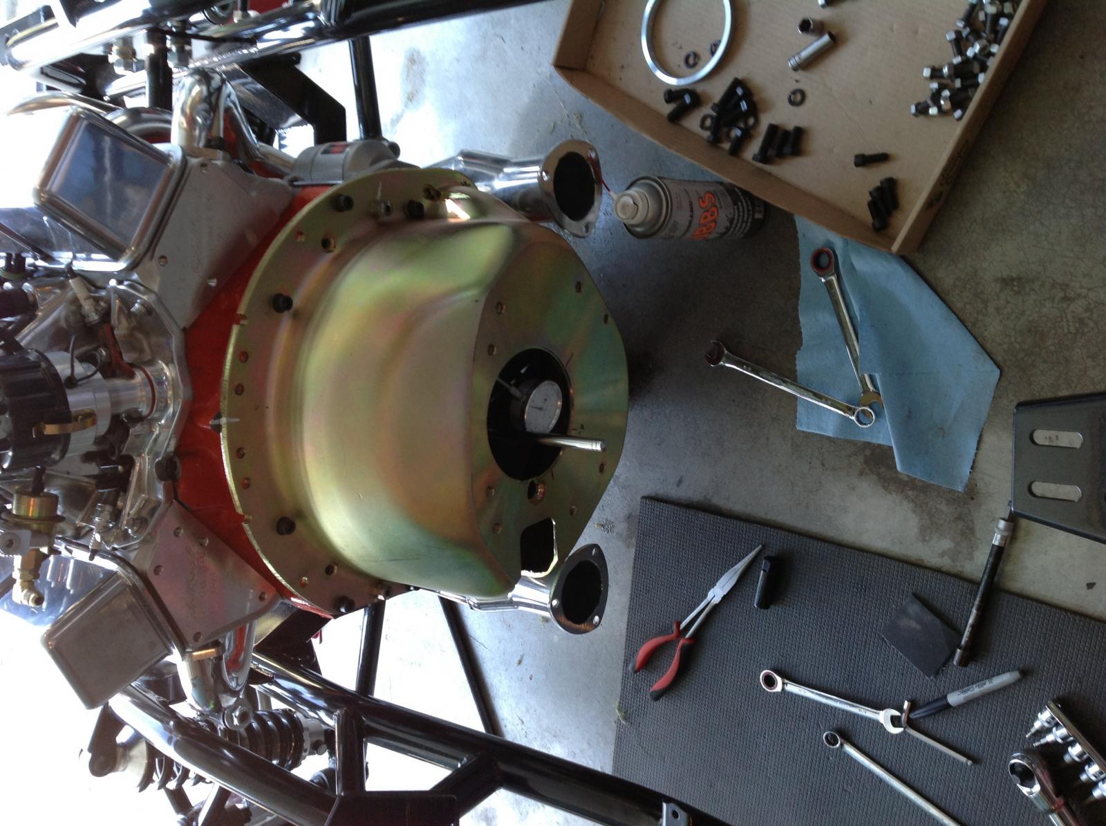

      Just realized I never posted the pictures of the assembled front end and engine with trans bolted on. What an adventure learning to clock the bell housing to the centre of the transmission. I had to go buy a magnetic base set up to find the centre and then install adjustable dowels to get the trans in just the right spot.
      There are some great YouTube videos on how to do this so I highly recommend them as the directions were very confusing. At least to me.
      Here is the assembly to find centre
      Getting that reading just where I wanted it
      TKO600 installed and torqued down and hopefully never to be removed again.

      Engine and trans installed with everything powder coated and painted and ready to rock & roll

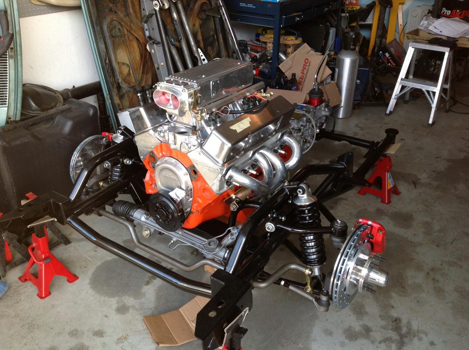

      Hey All,

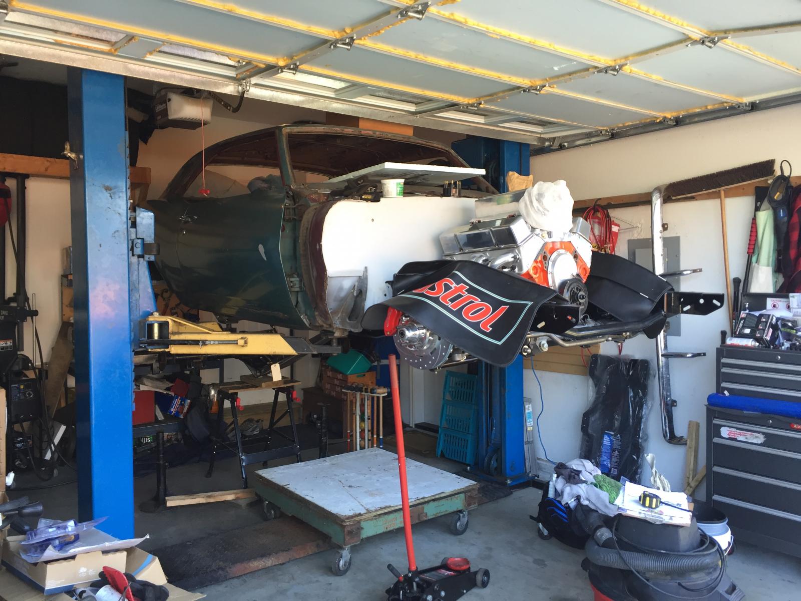

      Been a while since I've tuned in, a long while actually, so thought I'd do a quick update. Firstly I've been sidelined and turned down a few offers on the car and am determined to finish it. Someday. I've picked away at what I could then made the decision to install a hoist hoping it'll make it easier to work on, and it is.
      Currently the front end is done and installed, mini-tubbing is finished, rear suspension mounts are installed along with the subframe connectors. I've trial fit the rear diff and got all my measurements for narrowing the diff ( after hours of prep and measuring it was exactly what TCI recommended, go figure).

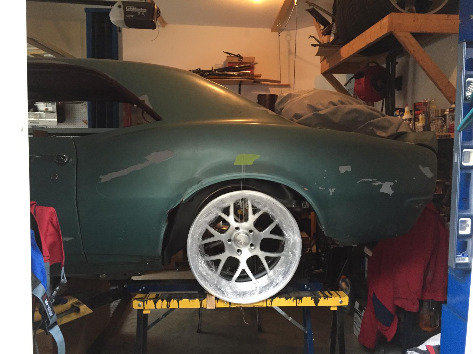

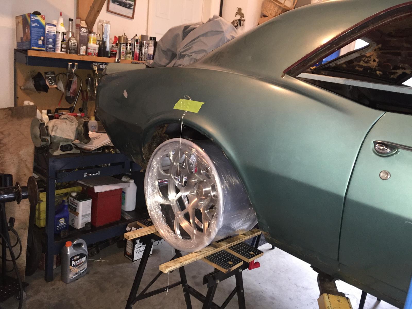

      And the Wheels
      And these babies are going to look AWESOME. I Re-love these wheels every time I look at them, such an beautiful set of wheels from Jason at Rushforth Wheels.
      Even better on the car...
      And one more....

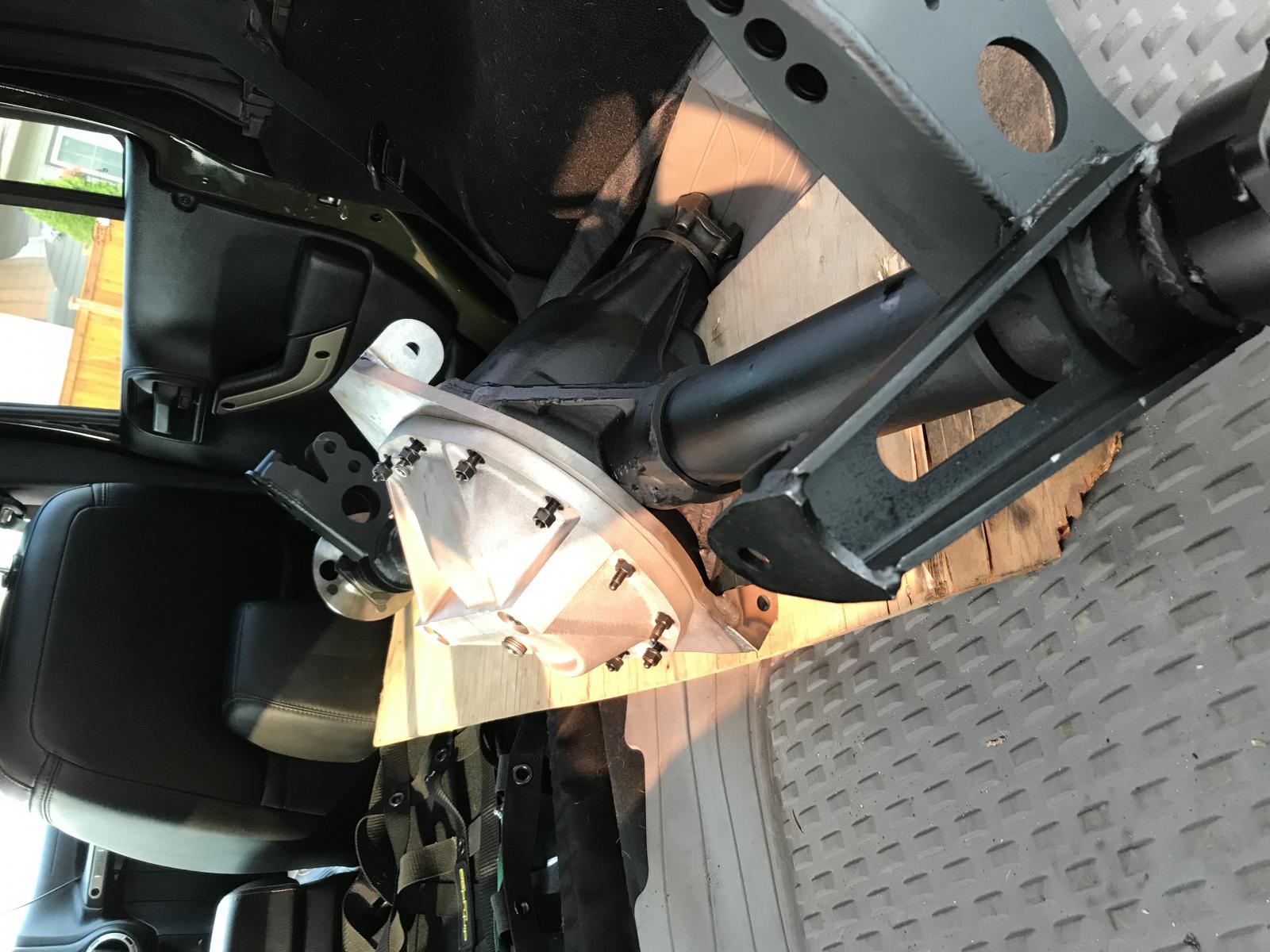

      Been a while since I've updated my thread and unfortunately there hasn't been a lot of movement. Health continues to hold me back so I took to just doing some small easy mods on my ZL1 with plans on doing some more racing in 2017 but I've only gotten out once. The '67 had the diff narrowed after measuring it what seemed like a 100x and I must say it turned out great.
      12bolt GM diff with 3.90:1 gears, Auburn carrier, big Ford bearings and eliminated C-clips, 2.5" narrowed each side, Dutchman axles, diff was put in a jig and straightened with all the my brackets welded on. Moser cover installed and set up.
