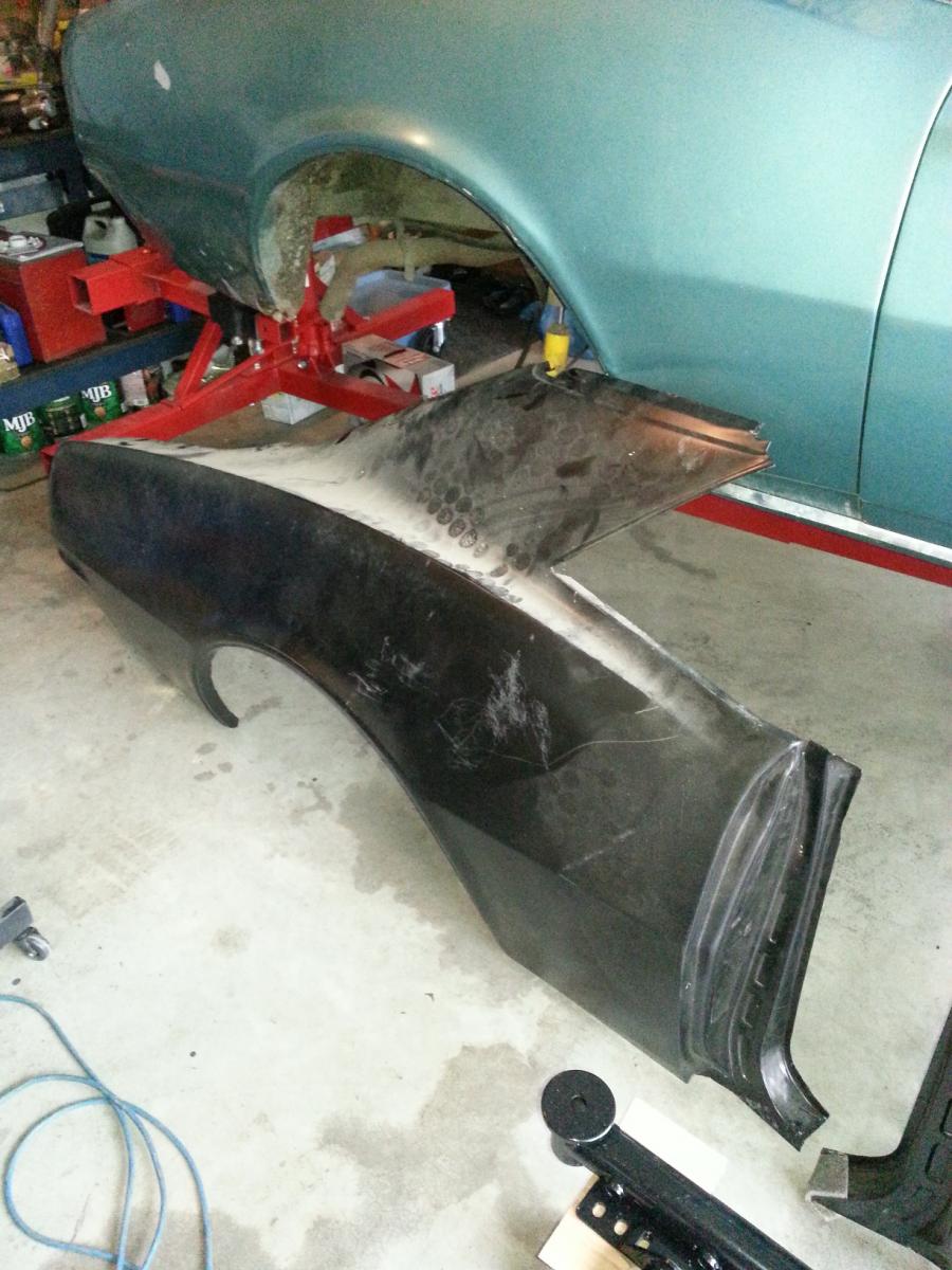

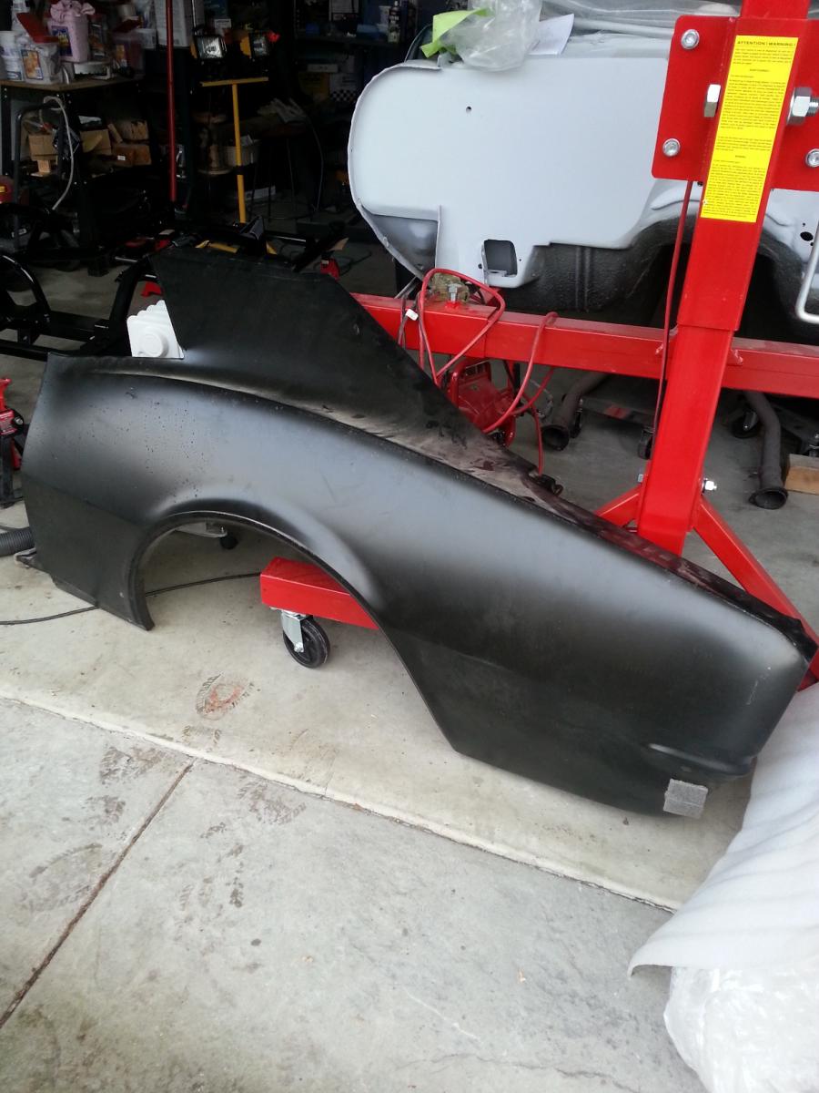

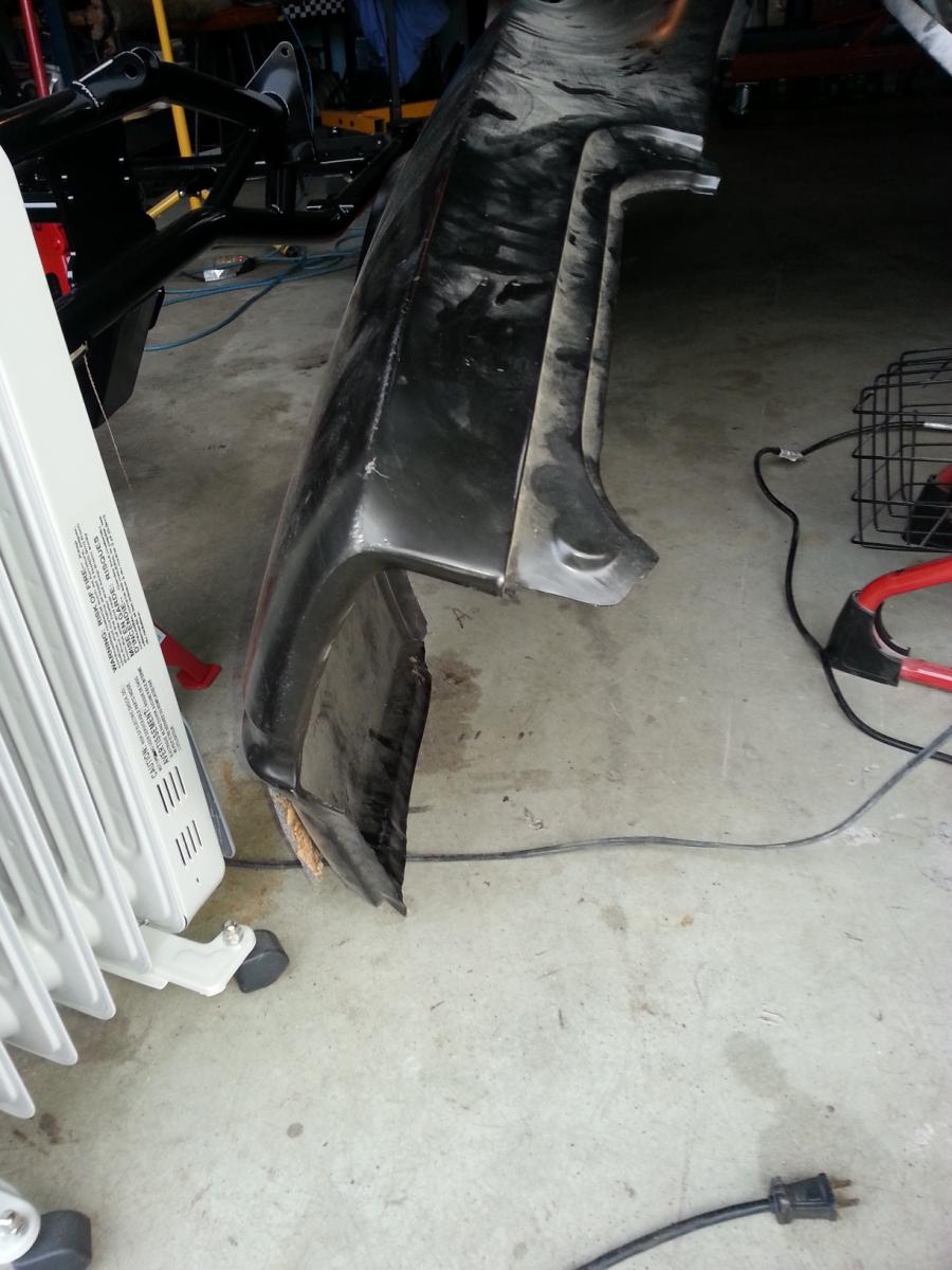

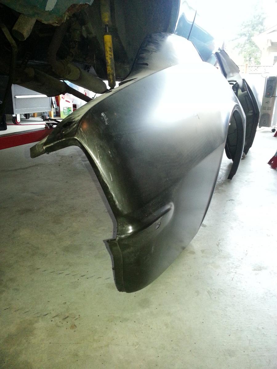

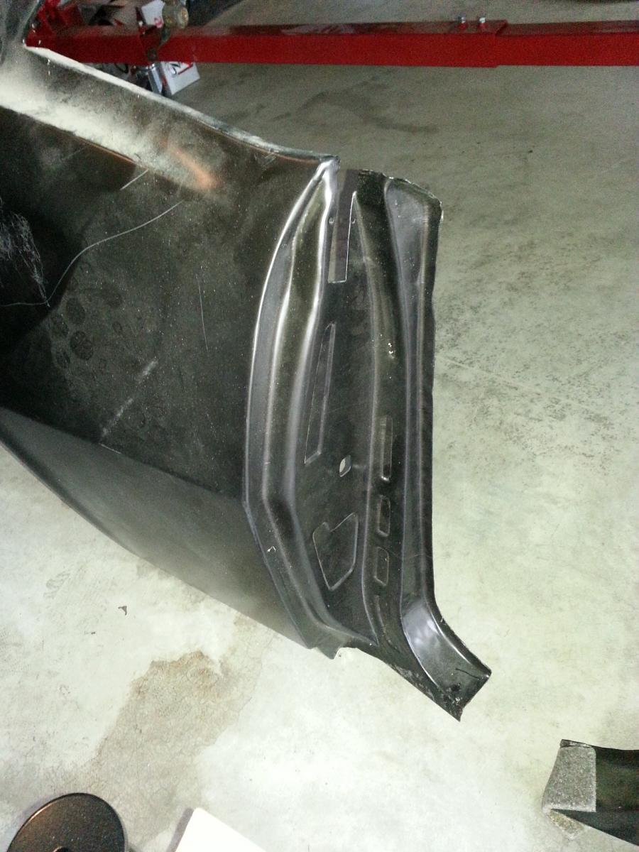

      Today thanks to the advice of a few of the very helpful other Pro-tour members I picked up a pair of rear quarter panels from a local guy who also happens to be a member here on the PT website. These are original GM panels that he has had sitting for 20 years. Sadly I had to shift the money from my budget for my TCI rear suspension savings but I just don't think these kind of items come along everyday.

      Now I just have to get this baby back on its wheels so I can start cutting off the old skin and installing the new.

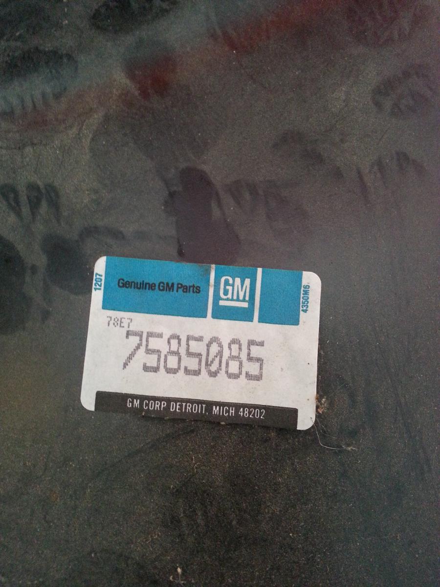

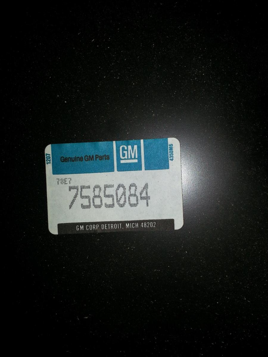

      I hate to tell you this but that 1207 on the sticker is not correct. That means the panels were made in december of 2007. Sorry to break the news to you :(
      OK ok i kid. Nice build and great find

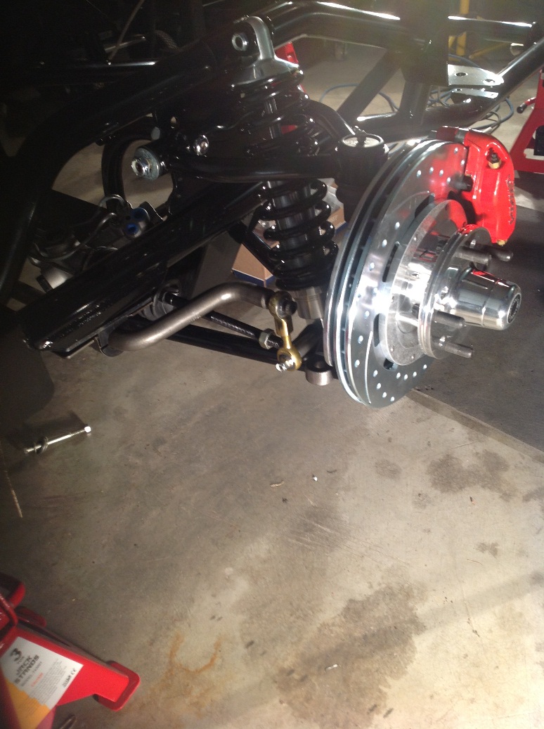

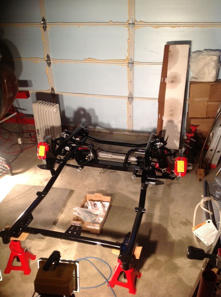

      Nice sunny day here in Vancouver for January so got some stuff done on the car. Worked on finishing the pre-assembly of my TCI front end and do the guys at TCI ever build a nice set up. Everything has gone together without any hassles.Name:  image (15).jpeg
      I really like the brake set up that they sold me with my front end kitName:  image (13).jpeg
      didn't install the tie rods as I still need to lube everything before final assembly Name:  image (17).jpeg
      Thats it for today, and tomorrow I'll start getting the car car ready to flip on the rotisserie so I can clean the bottom side and get ready to order more goodies for the build. Also, started a new "Todo" list and what I need to take to the powder coaters that I forgot to take last time.

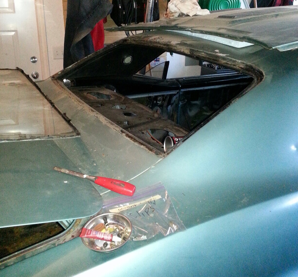

      Here we go with a small update. The Camaro is on the rotisserie and I'm finishing stripping the last of the interior out and getting it ready to spin so I can start working on the bottom. I thought I was at this stage a while ago but there seems to be an endless supply of little stuff to keep going.
      So I started with pulling the rear glass out and all is solid around the rear with no hidden surprises;

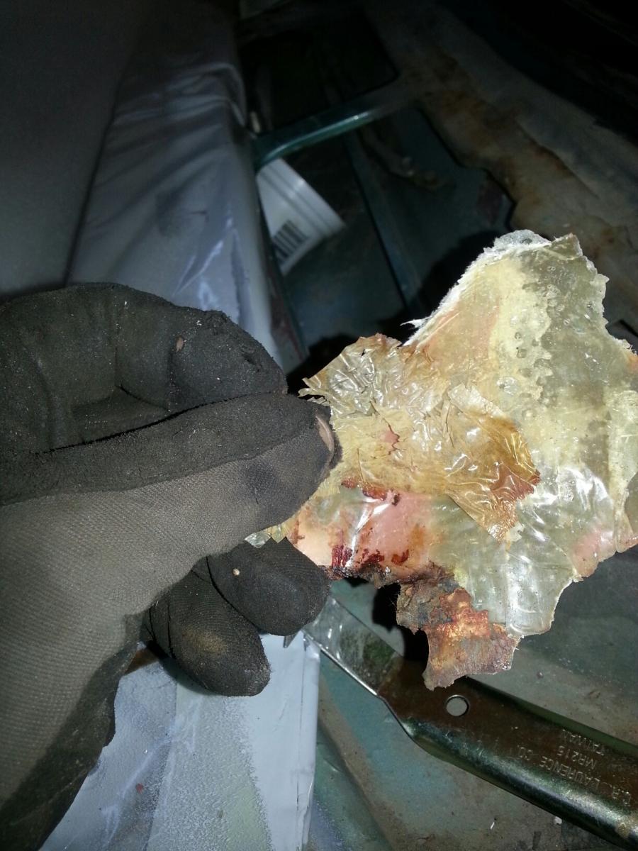

      Then I pulled out the windshield and somewhere along the life of this car someone thought it would be a good idea to metallic tape over the rust and then bondo and paint it black.
      How is this for a chunk of bondo?

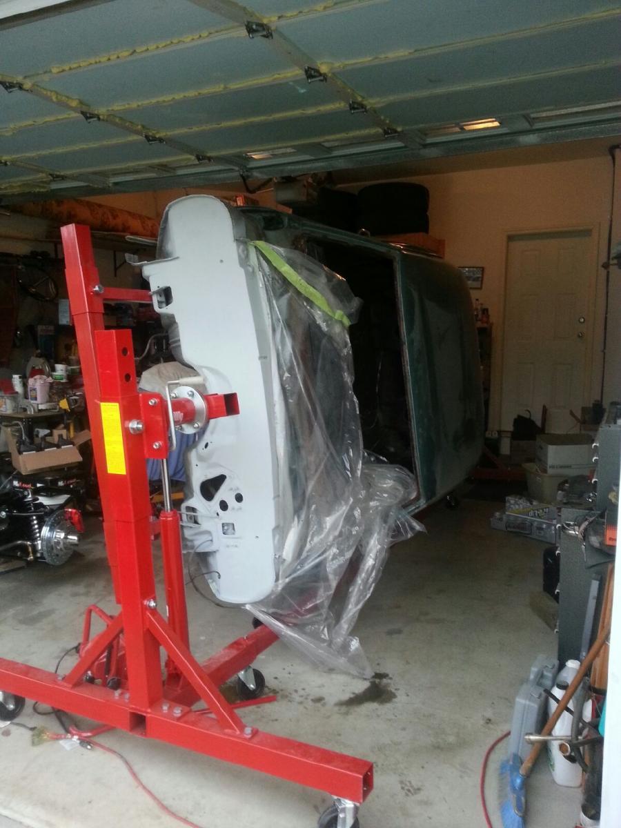

      FINALLY! the car is flipped on the rotisserie and I've started working on the bottom of the car. It's another step in the progress of the car because now that I'm working on the bottom I will be starting to get the car ready for the rear suspension and mini tub install which means I'm actually starting on the assembly of the car. Everything up to this point has been about taking the car apart, planning and prepping.
      From this point forward my work will be about fitting and assembling the car. It's really great to have reached this point and it feels like getting a jolt of motivation. Here are a couple pictures of the car flipped on its side;
