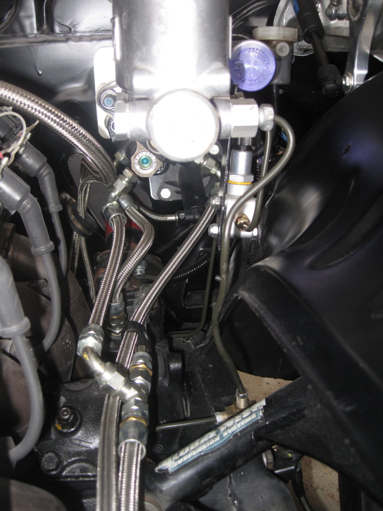

      The bypass test is exactly the other way around. Put the AN-6 nipple cap on your T fitting, and put the rubber hose onto the brake assist unit's AN-6 nipple.
