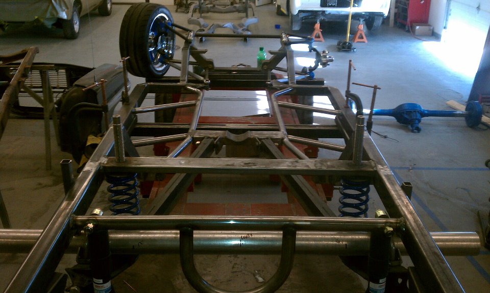

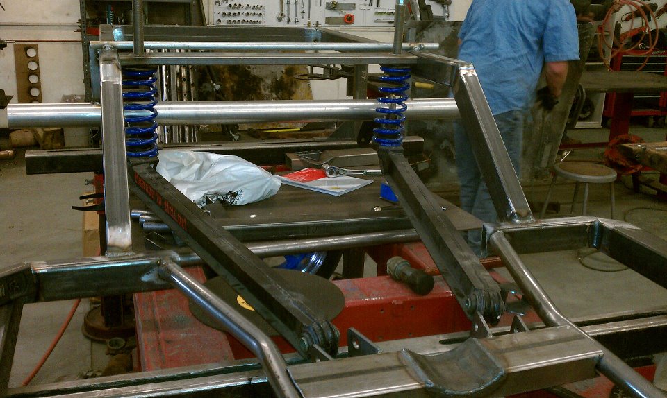

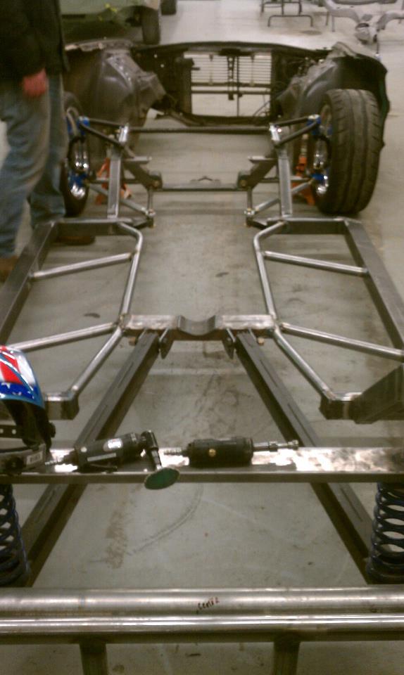

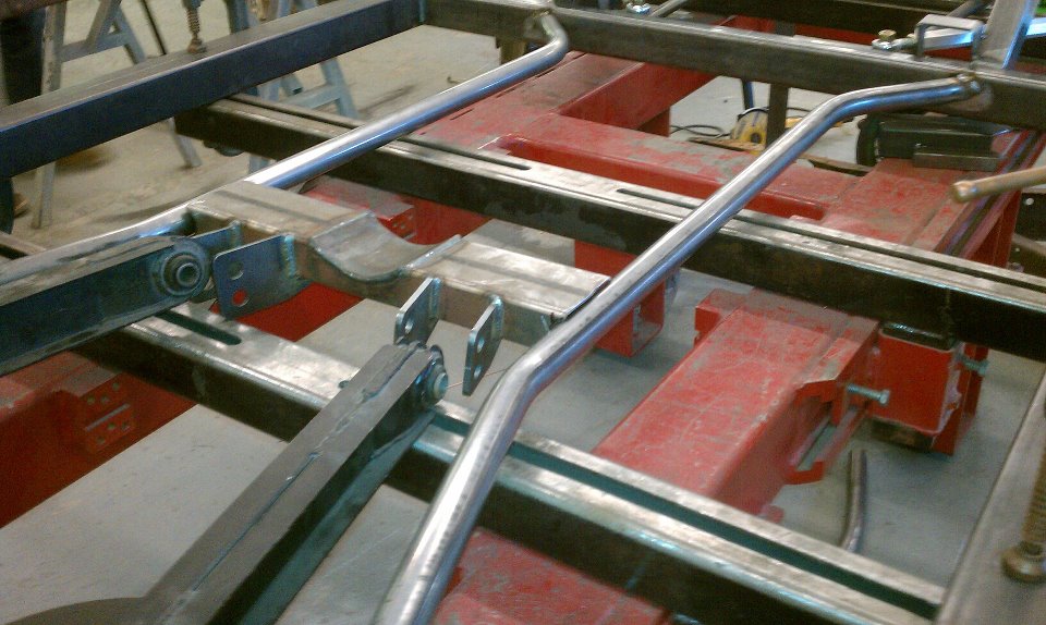

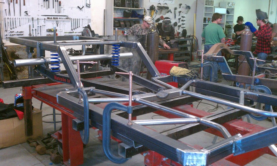

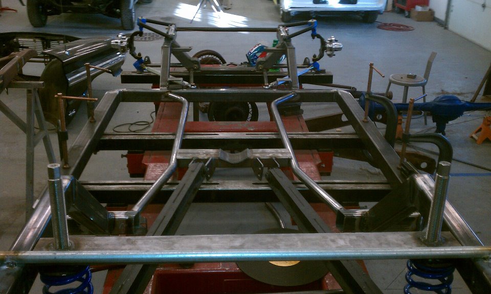

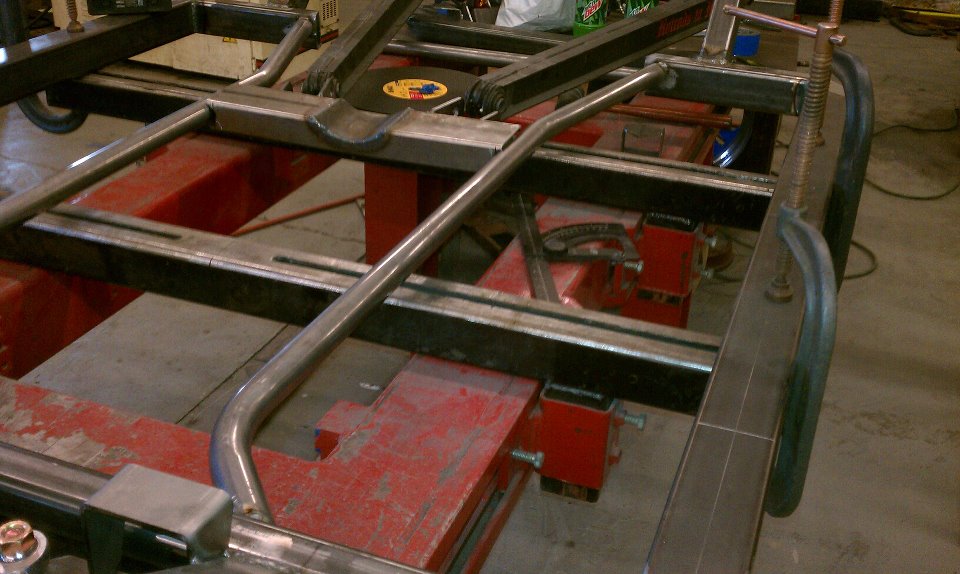

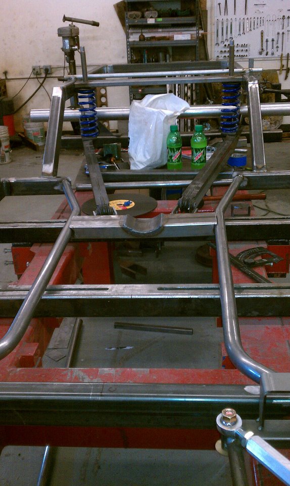

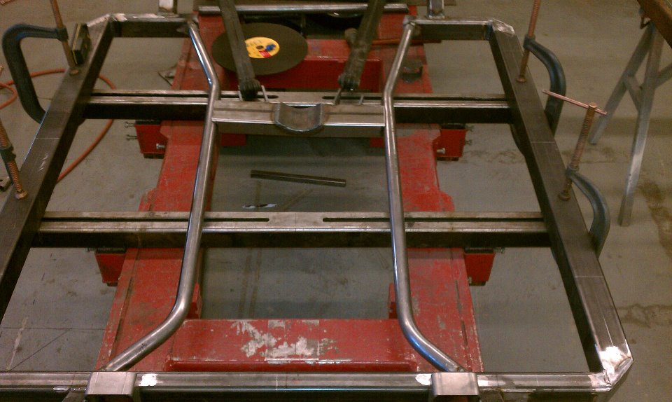

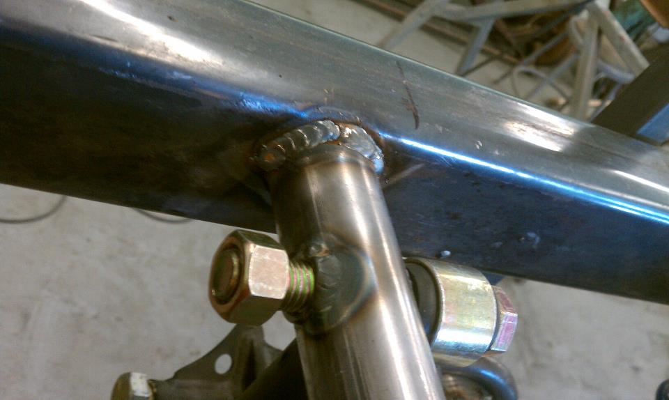

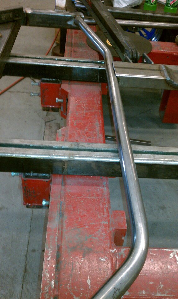

      Well i started to work on my center cross members and rear suspension mock up so here are the new pics so far. Hopefully I will have it finished tomorrow then i can order the rear end and start my watts link design.

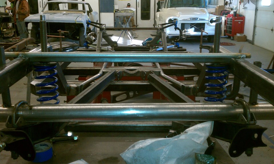

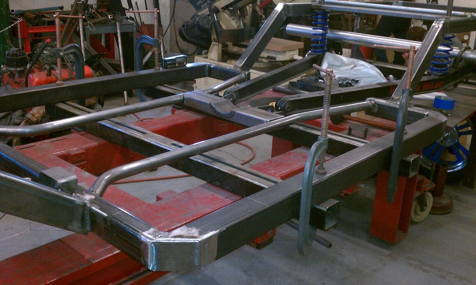

      Well i got some more done on the chassis. built the watts link and shock mount bar, ordered my moser full floater housing with axles and hubs which should be here this week. I will be taking the chassis off the table on monday and flipping it so i can weld up all the bottom side of the chassis, then will be settinig it up as a roller so i can put the body bock on the chassis and build my new body mounts and start to fit everything together.

      Well took the chassis off of the chassis table today and set it on the ground, also welded up the bottom of the chassis too. Now waiting on the rearend to be delivered.
      Here are some more pics
